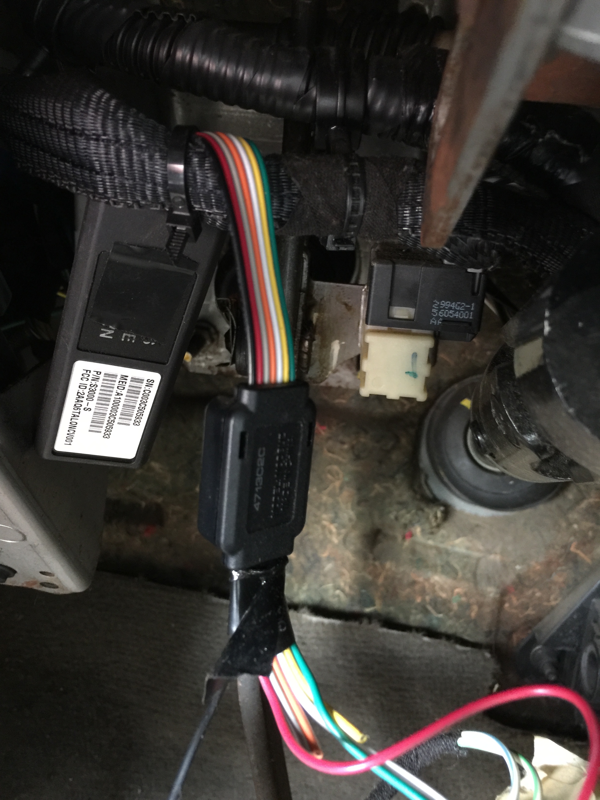

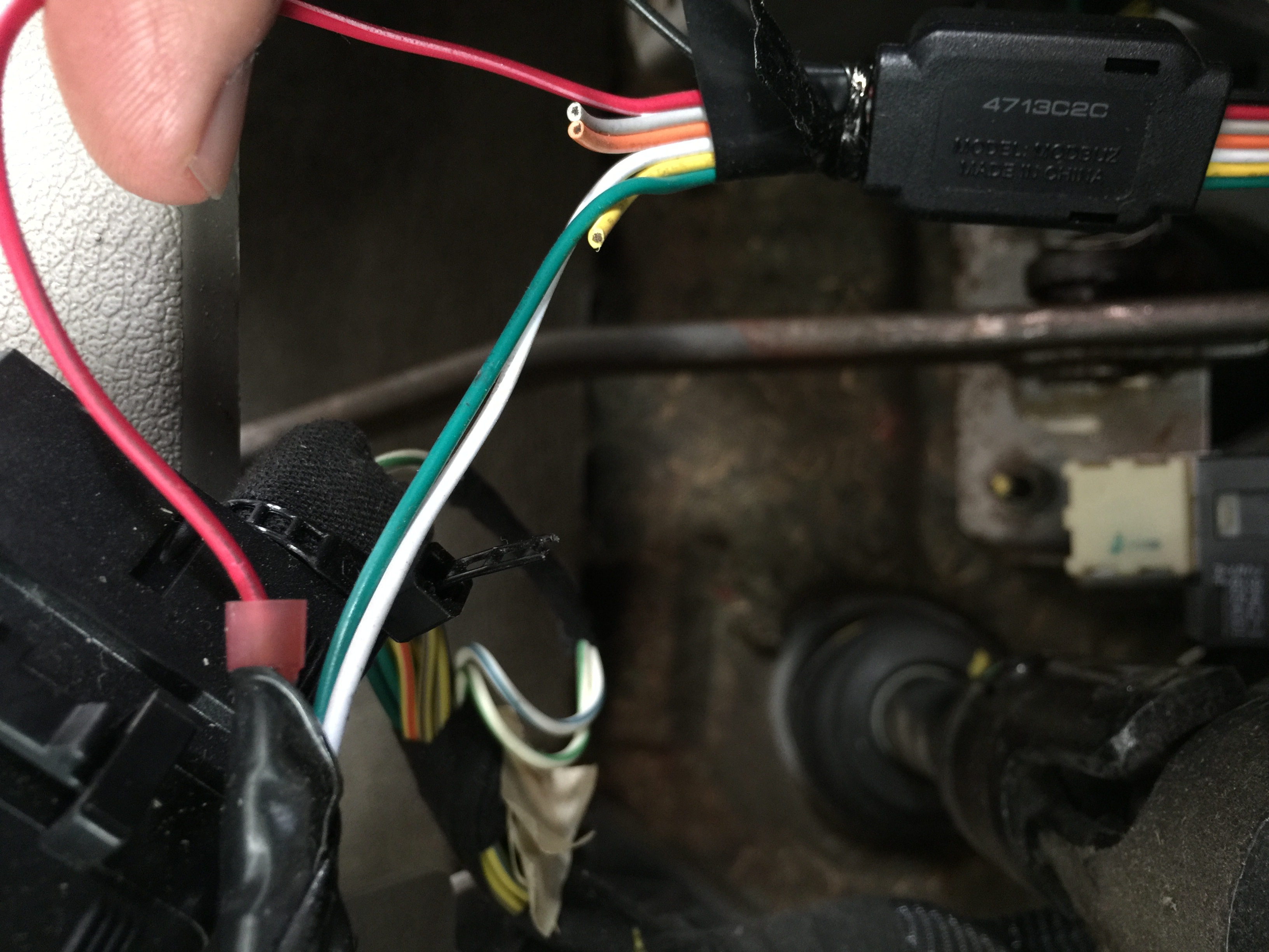

In process of putting in different TCM (with plans to have it programmed), when I dropped the cover I noted some wires clipped (see pics) and was hoping to determine what these are for and rule this out as potentially being related to problem. The first thought that came to mind is this trailer wiring, but not sure and can't find info on what two parts are in line with these wires.
4713C2C (MODEL: MODBUZ ??possibly, can't read the pic have at moment well) is on part in line with wiring harness (which as green, yellow, white, orange, gray, red, black wires) . The yellow, orange, and gray are cut and I didn't see easily where wires may have used to run.
There is another component with following on it that after looking at pics I need to see if it is also inline with these wires (P/N S3000-S FCC ID:2AAQ6TALONCV001

yes, that's a wiring harness adapter for a trailer but why is it hooked up there? with how sensitive the new transmissions are to anomalies in electrical readings, I would think that connection would be made in the back near the tail lights
Thanks for the confirmation! I have no idea why it was put there. It was that way when I got it and I didn't even know it was under there until very recently. Sounds like you would suggest that be relocated? Are any of those wires common with any going to transmission (or specifically TCM since in that same area?)? Wondering if that is why you are concerned with it being hooked up in that area or if another reason.
