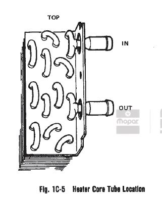

1979 CJ7 Heater Core Question - In and out hoses on heater Core
cjsit960
Just looking to see which is the in and out hoses
on the stock heater core of a 1979 CJ 7 Jeeps - or it does not Matter
the hose at both 5/8
Thx
The upper hose that comes from the thermostat housing is in. But in most cases it doesn't matter what way the fluid flows. Many do not have a directional check valve.
Regards,
JPNinPA
Sent using TapTalk
No it shouldn't. It's a heater core. Hot water in and slightly cooler water out. The only concern would be if you ran a radiator cap higher than 18psi.
