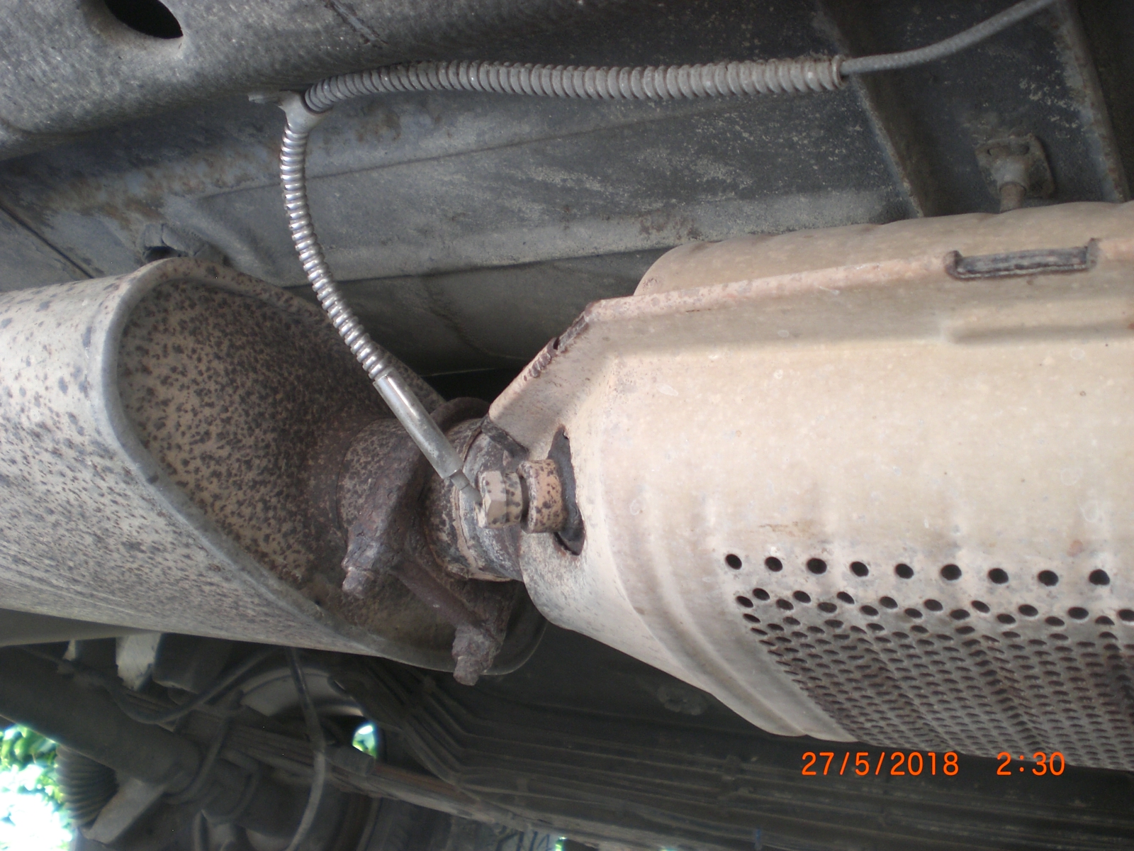

I will be fitting a new cat shortly and may have to fit a new rear, (after cat) oxygen sensor if the current one gets broken.
I have hunted high and low but can find nothing like the one currently fitted so can someone please help.
Apart from the baffling number of choices and equivalent information which seems to differ depending on where you look I am still none the wiser.
As the picture shows it looks normal enough at the bottom end, but there is no connection nearby instead it goes up past the starter motor picks up the hood release cable in a conduit and goes inside behind the dash.
There surplus length is coiled up and the plug connects to a little black box. The cable must be at least 2 metres long.
Does anyone know what I have got and where can I find one? All suggestions welcome.

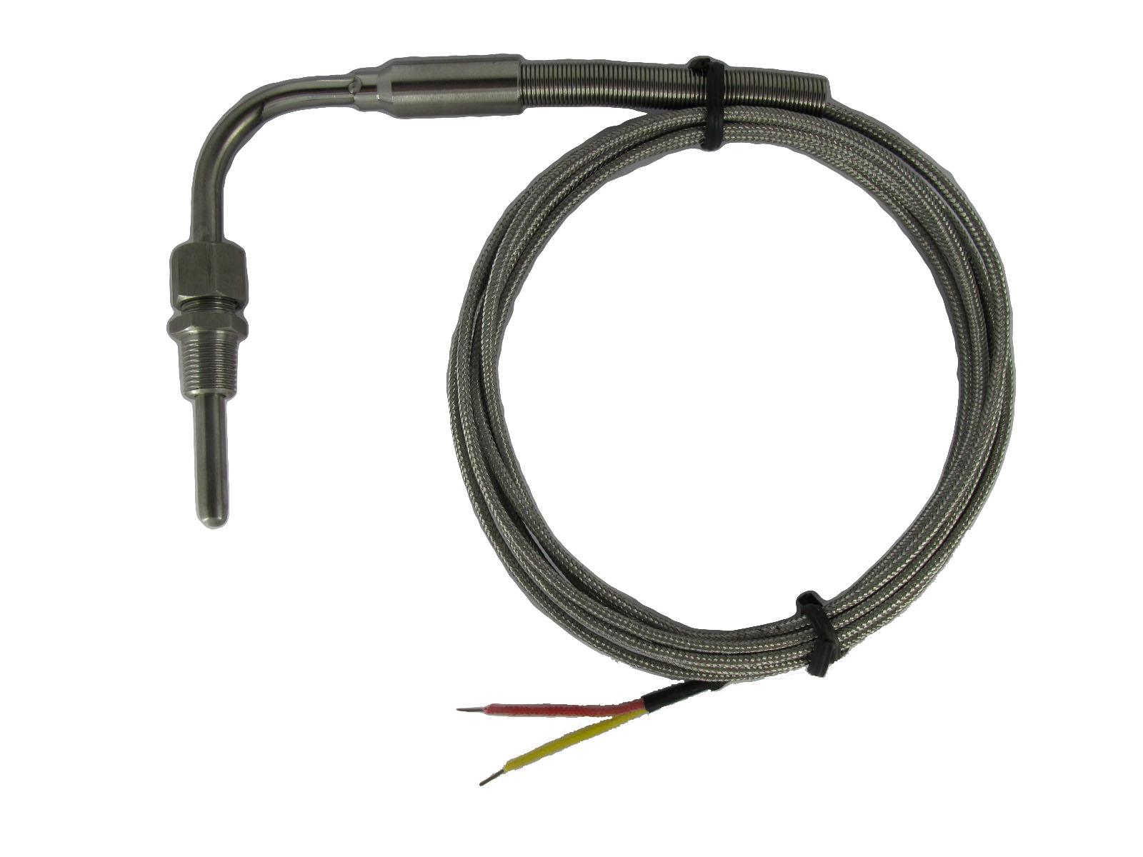

Firstly, you cannot buy a replacement cat for a temp probe.The thread is NOT M18 x 1.5. If you order one by model and year for your car it will come WITHOUT a welded on boss, so buy one with a boss and save the hassle of having to buy it separately and weld it on yourself (like I did).
The temp sensor is a K Type EGT (exhaust gas temperature)and can easily be found on Ebay. Ensure it has a 3m (9.8 ft) cable and afitting on the probe with a 1/8 NPT male thread. Buy one with a 90deg bend soit sticks out less under the car. It should look a bit like this and will costless than £5 ($6 or €5.70) incl p&p.
2Q==
Z
There will be no plug on the end so use the old one and follow the colour code of the wires. Solder the connection and put heat-shrink overthe joint. Do the joint a couple of inches (50mm) from the plug.

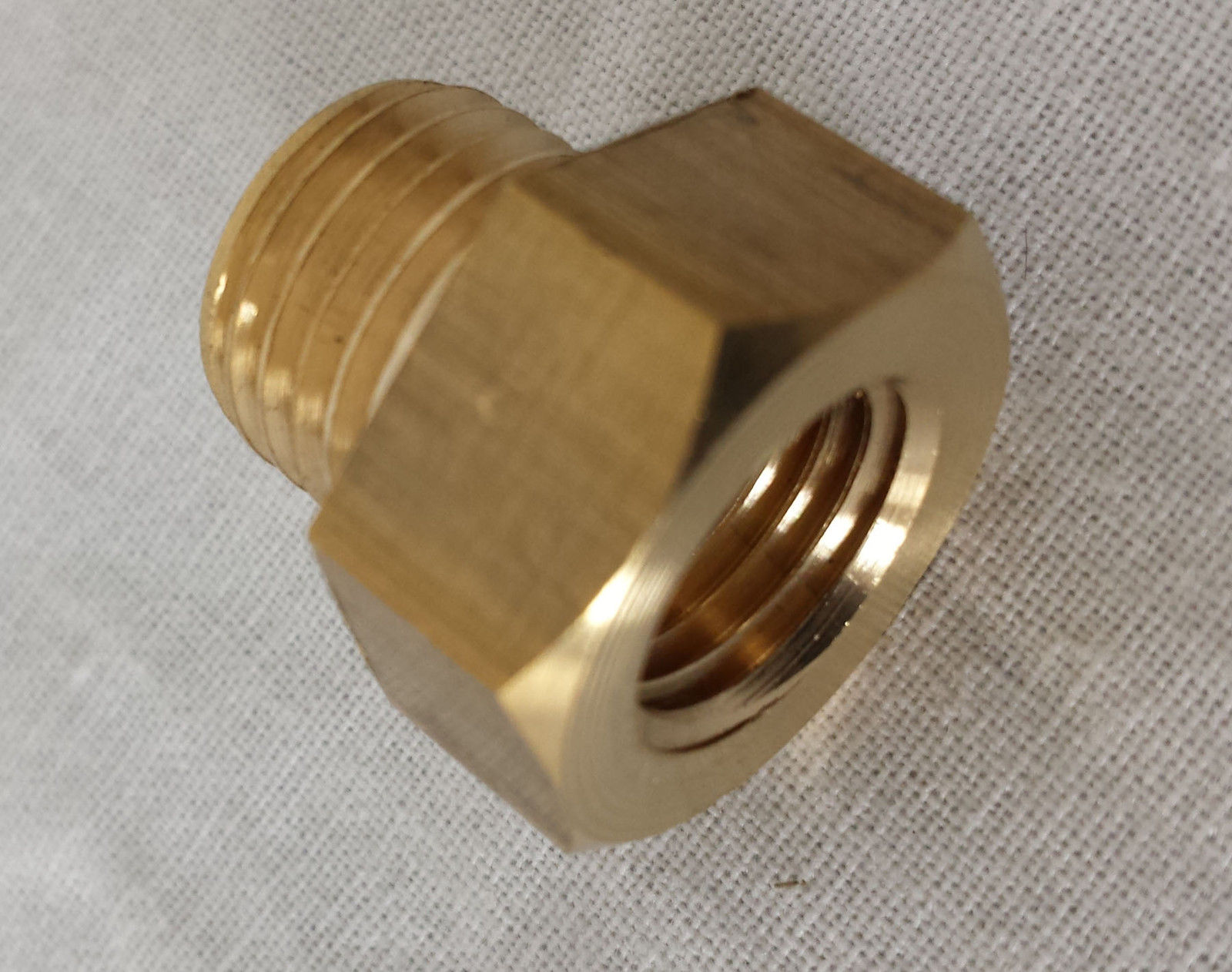

Next you need an M18 to 1/8NPT Adaptor. Again, you can find these on Ebay described as a sump (oil pan) plug adaptor. I got a brass one for £12 ($16 or €13.70) incl p&p.Itlooks like the one above.
Now all you have to do is put it all together.
