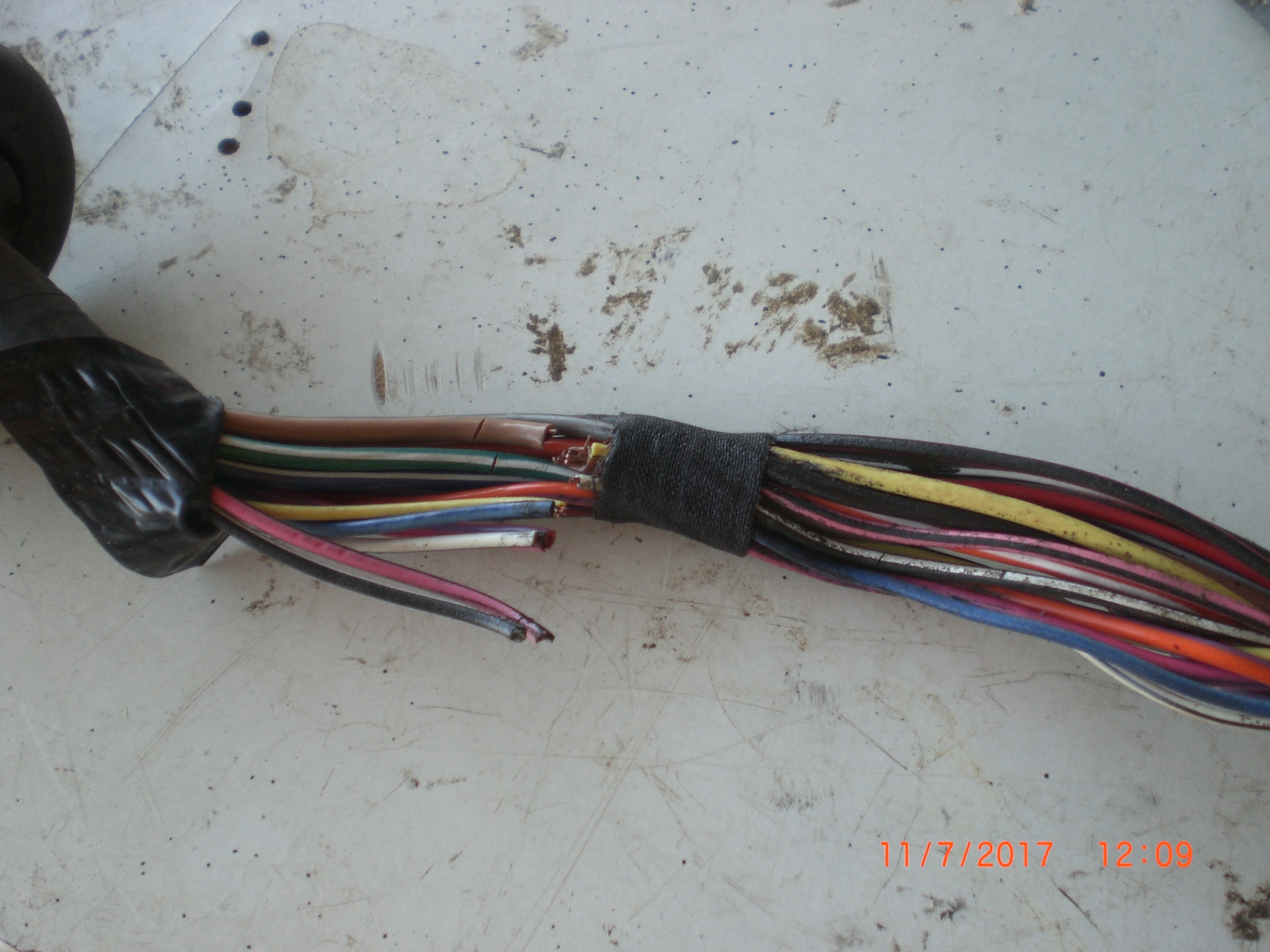

I have run into the usual problem of broken wires in the door jam/hinge area. I removed the door harness and found no less than seven completely broken wires and three cracked ones all at the same point where binding tape had been wrapped round the harness presumably during manufacture.
Bad practice since this will concentrate the bending stresses.

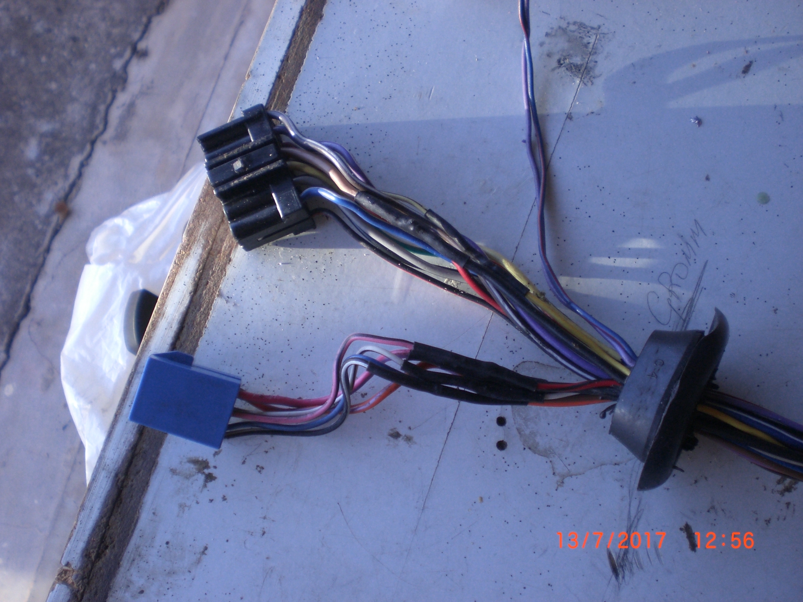

Anyway, I have soldered in all new wires covering the joint with heat shrink ensuring all the joints are out of the bending area. Continuity is good on every wire and all the colours have been checked.

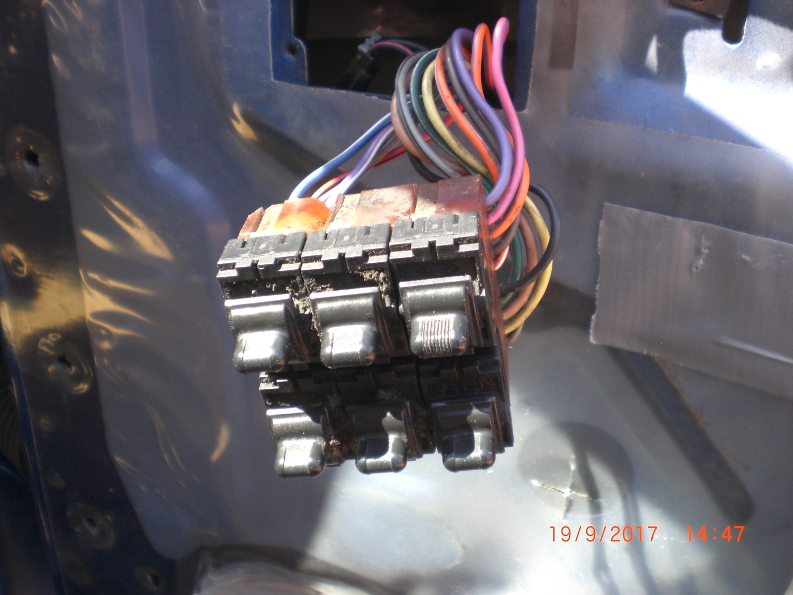

The six switches in the door panel plug into a multi pin socket on the harness as an assembly. I don't think it is possible to get this wrong.

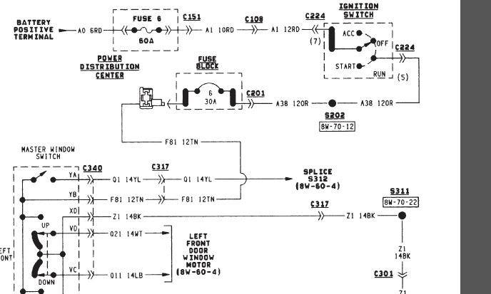

Ataced is the LHD diagram OR logic - us the diagram to confirm power thru key switch to controls - it has fuses and relay names...
looking for RHD easy all in 1 diagram. Jeep lists all door circuits separate PW. PL, PM etc

Everything is working again. Thank you for the wiring diagrams they helped with the power supply and fuses.
The actual problem was entirely my fault. I said above that you could not get the six door switches wrong, well you can, there are actually four options.
There are six connections on each switch except one which has two, so there 32 pins and a socket with 36 holes, not all of which are used. Put them together 90degrees out nothing works and you pop a few fuses.
There is no keyway to ensure you get it the right way round.
The moral to this saga is to mark the connection with a spot of paint before disconnecting it.
As a precaution I have put a securing wire round the switches to hold them into the door facia plate since the Jeep clips are useless.
