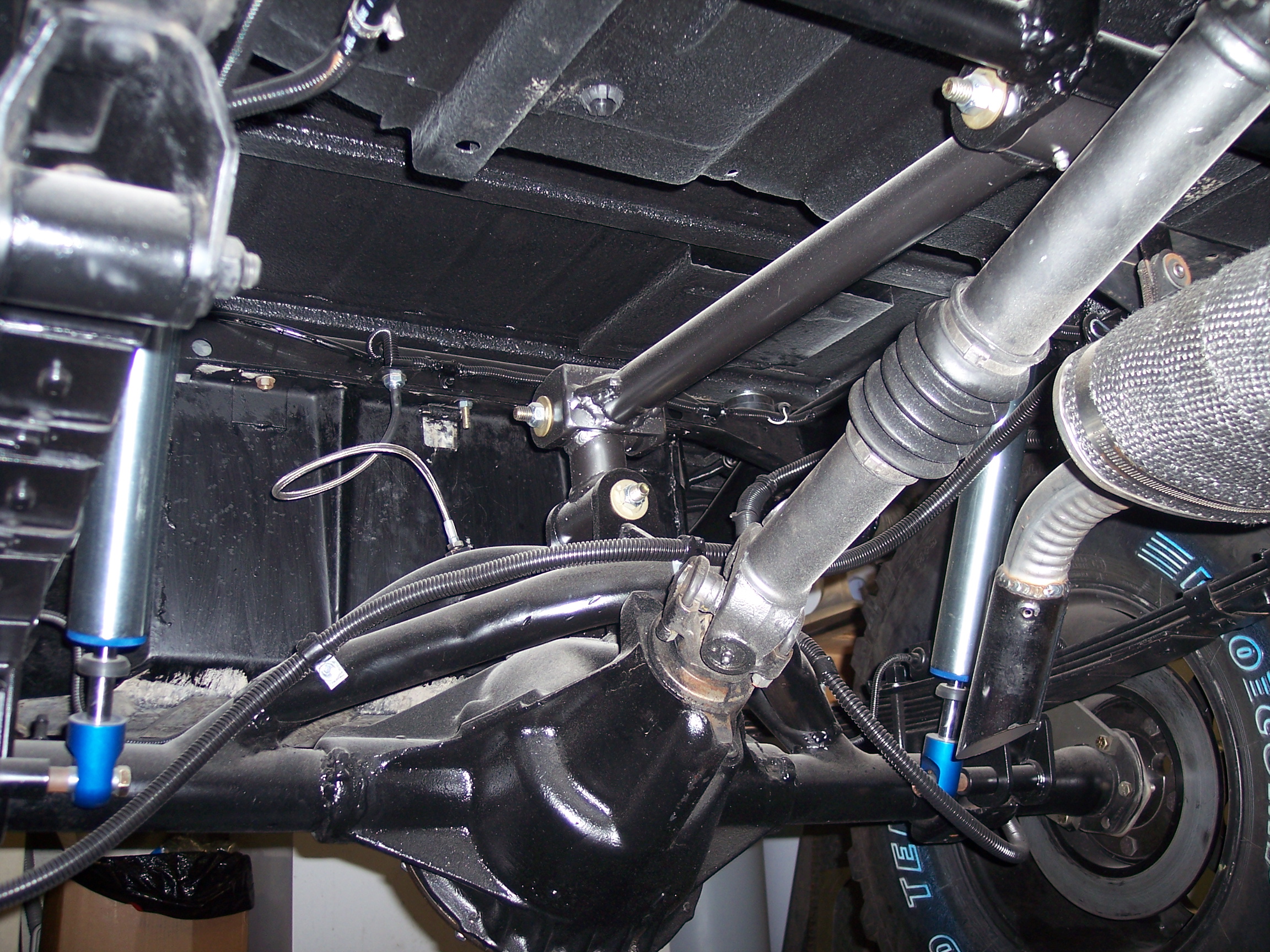

A quick pic of the 20 in my '84 CJ7...
Uh, I just want to know how you keep the underside of your jeep that clean? Living in the rain/snow zone I guess the whole idea of a pretty undercarriage is just a foreign concept.

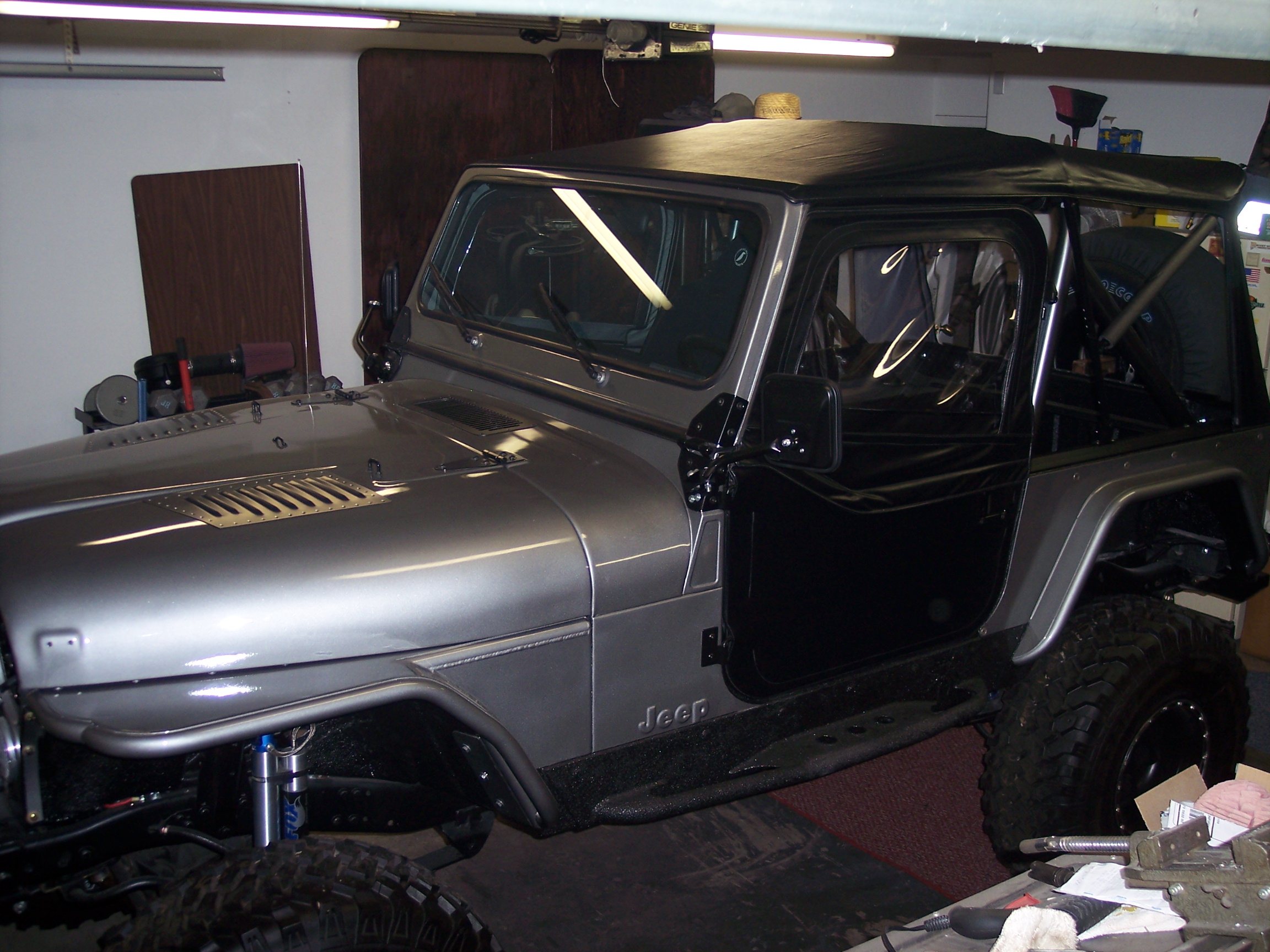

It hasn't left the garage yet! :D
I bought the Jeep from my brother, brought it home and discovered there was literally nothing salvageable. Did a complete body-off, bumper to bumper. Spent more money than any sane man should. Still not complete, got some fuel injection/electronic ignition bugs to work out and a few other do-dads.
Here's another quick pic I snapped. Not a good one - my garage is air conditioned and I didn't want to open the door! ;)
