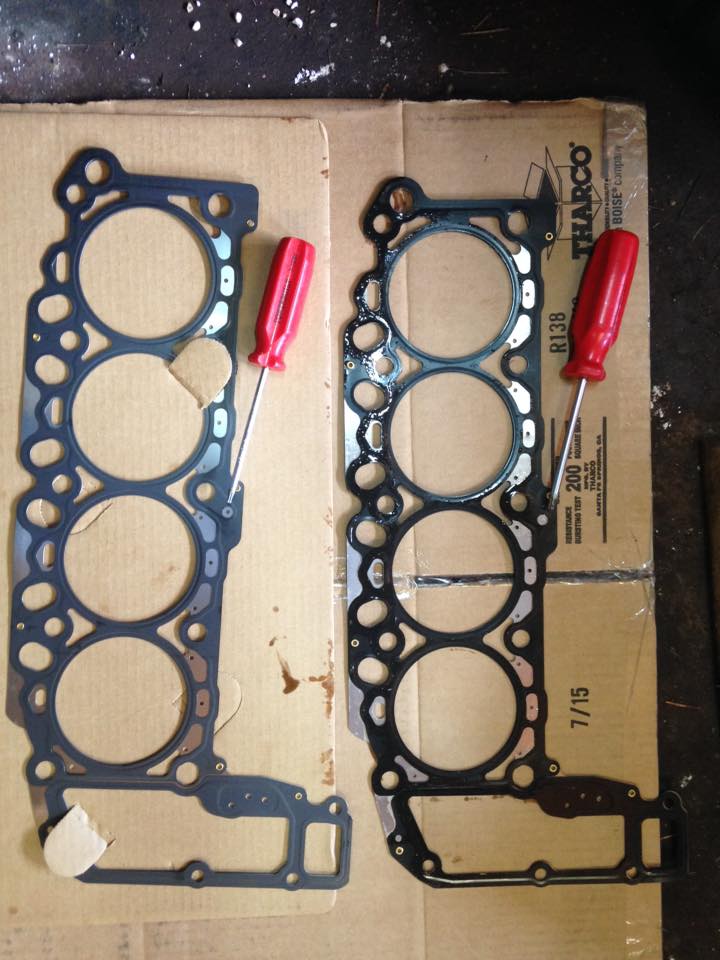

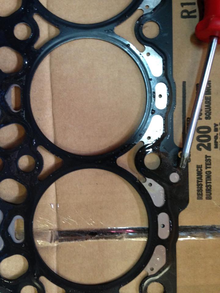

I finally got it sorted out! I verified it wasn't getting oil to the passenger side head. After blowing compressed air into all the lash adjuster holes and not fixing it, I decided I needed to pull the passenger side head again and verify the oil passeges that way, possibly blow air through the head and block, and inspect the gasket.
The hole in the head gasket for the oil passege was missing 😒
Take a look at the photos comparing another new gasket to the one I had installed. The gasket I installed was defective as it is missing the hole to let oil into the head.
