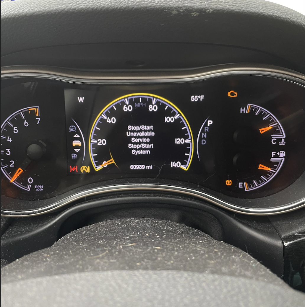

So my wife's jeep just randomly went into limp mode and wont go over 40mph. Yesterday it was running just fine, no issues at all. When I ran the code it looks like the throttle sensor is getting inconsistent power or bad signals. Per a mechanic's advice I replaced the whole accelerator assembly/sensor and cleared the codes but I am still getting the same lights and its still in limp mode. The next suggestion was replacing the throttle body but I'm hesitant to keep changing parts out.
Does anyone here have experience with this? We're pretty broke so I'm willing to keep working on it as long as I'm not risking permanently f***ing it up. My main experience with vehicle repair just operator-level shit in the army (on tracked vics) so I'm competent but not a pro.
Any advice is appreciated. Please let me know if more info is needed.

First make sure battery is good. All connections are clean no corrosion. And point of ground connections to the engine and body are clean and polished.
Bad battery and grounds throw many bad codes.
Then did you do the reset/relearn for the new accelerator?
Without the relearn the PCM may not know the new resistance readings and keep you in limp mode.
Thanks for the reply, I had the battery checked by one shop and autozone and they both said it was good (I replaced those about a year and change ago).
As for resetting the accelerator, I followed a few different videos and nothing seemed to work so far. The recommendations so far had to do with pressing the pedal 3 times while the car is in "Run" with the engine off but no luck. Is there a correct way to do that? I'm following youtube videos right now so any real info would be very appreciated.
