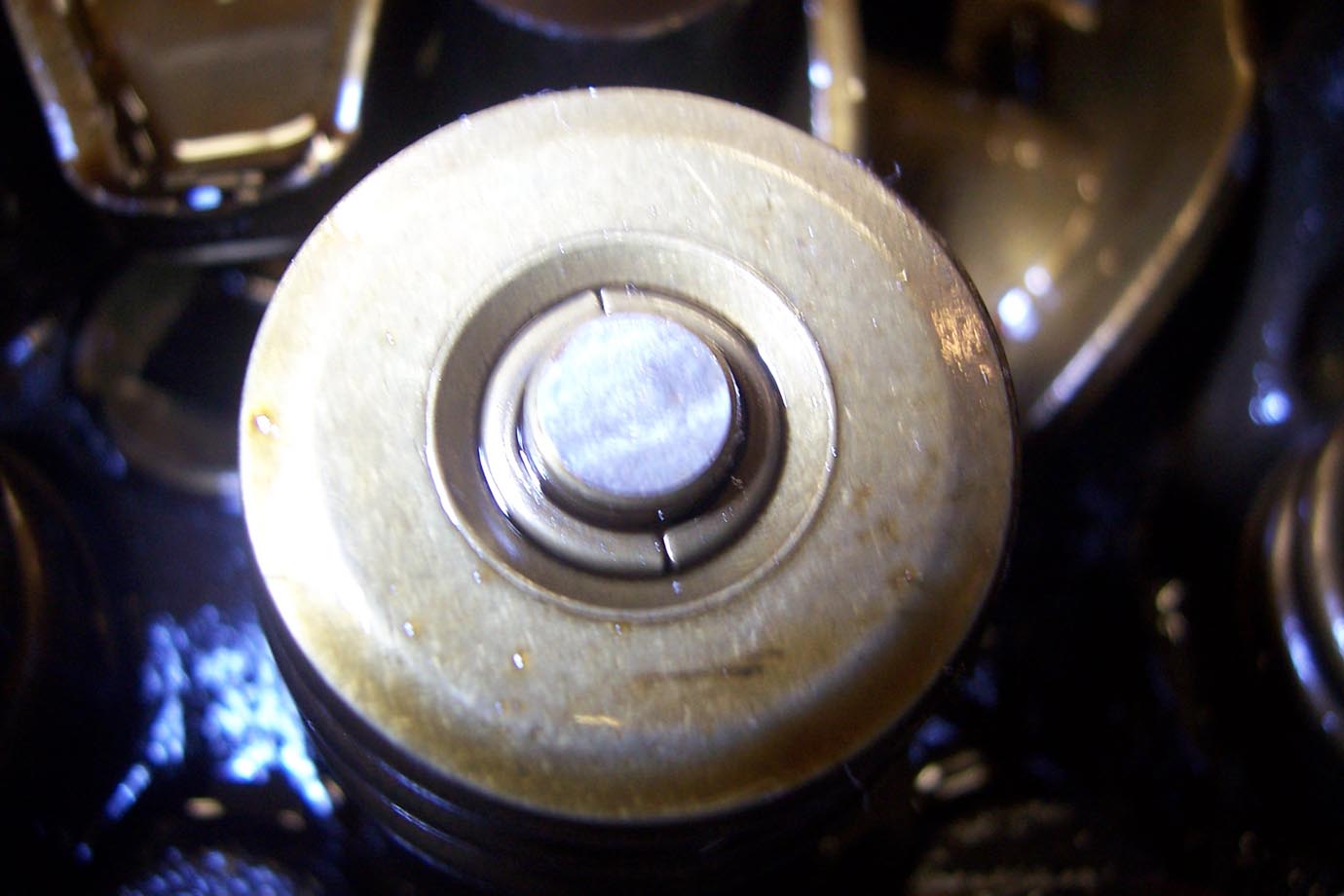

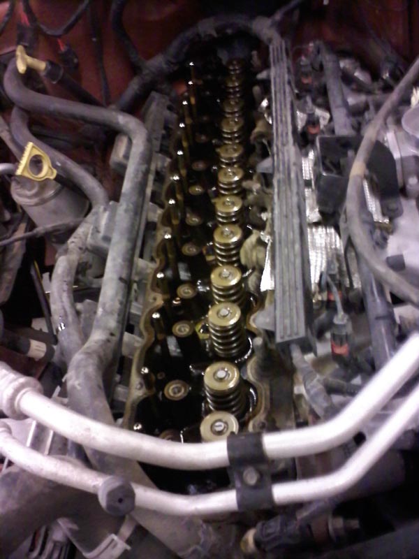

Well like I said I was going to manually turn my exhaust valves, I tore the valve cover off and removed the rocker arms, marking each one with a number 1-6 and with an I or a E for exhaust or intake.
After careful inspection I didn't see any of the valve stem tops with distinctive parallel lines, all had good circular or bulls eyes on top.

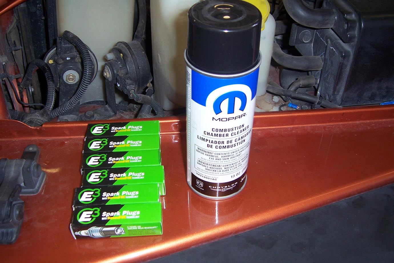

With nothing better to do I turned them anyway. afterwords I installed new plugs and heat-soaked the motor with DC's de-carbonizer in the cylinders 4+ hours.

Did you really use the E3 plugs?? I had bad luck with them . I'd put origional NGK or normal Champion or Autolite plugs in before doing anythnig else. Be sure to gap them.
The E3's reduced my MPG 10%+ and I could hear puttering like misfires but didn't throw a code.

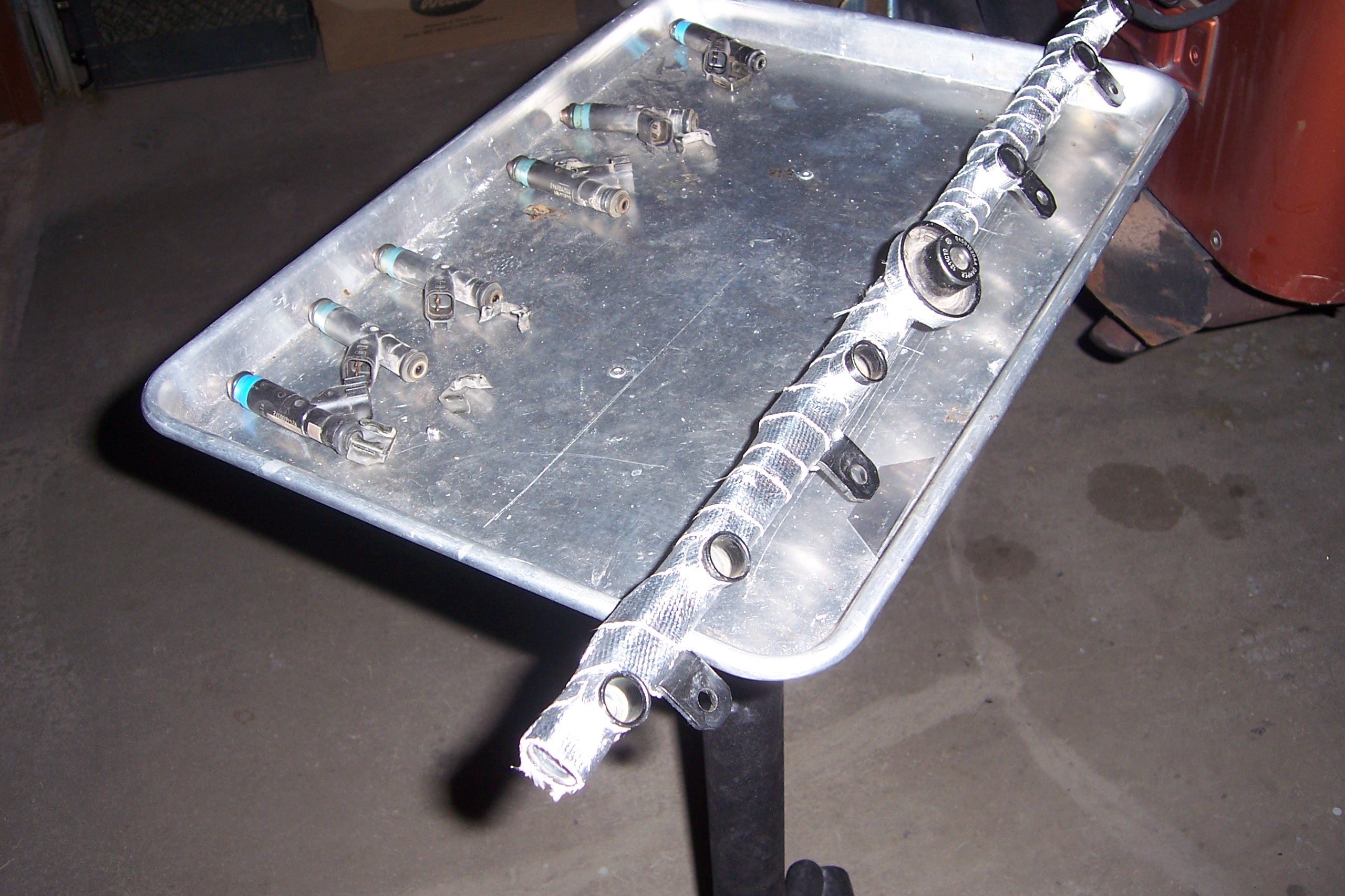

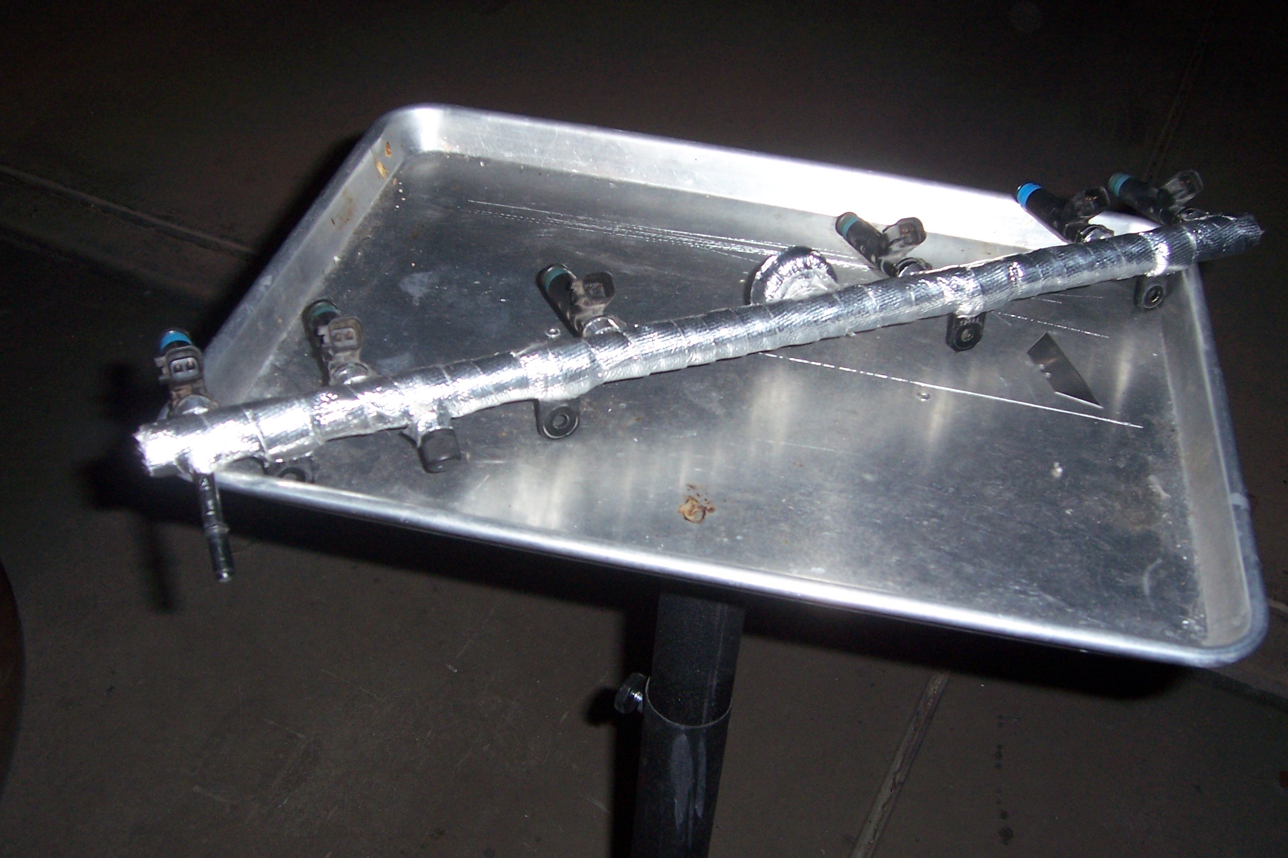

Well here is the latest progress report, I found a listing it might be a slight vapor lock with the fuel rail, so with nothing better to do I wrapped the fuel rail with heat shield tape, a 20$ investment and several hours of tapping fun. Will drive it tomorrow and let everyone know.
