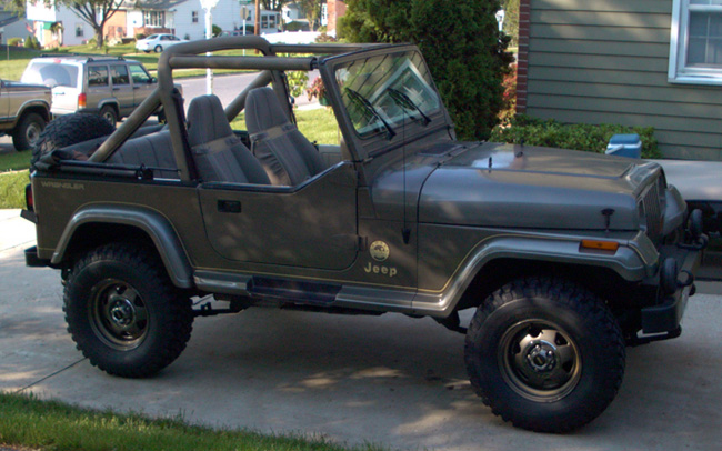

Here's my 91 YJ with a 2.5" lift on 31" tires... no rubbing at all, not even when I disconnect the swaybar:
