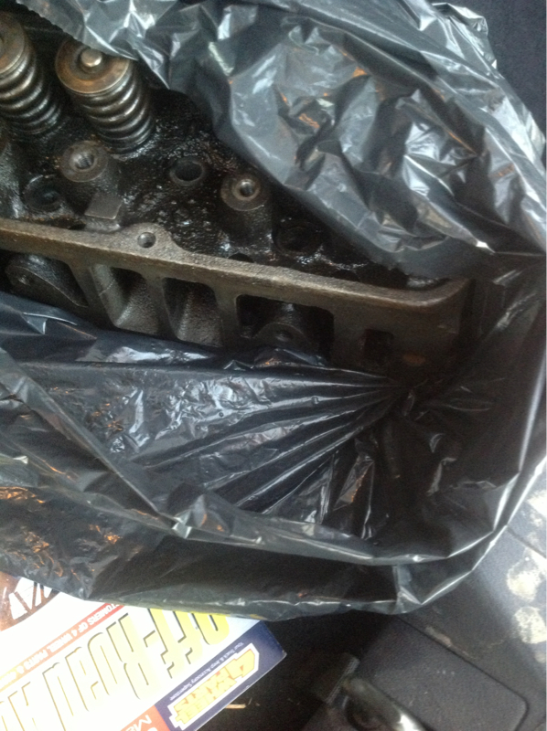

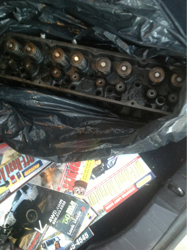

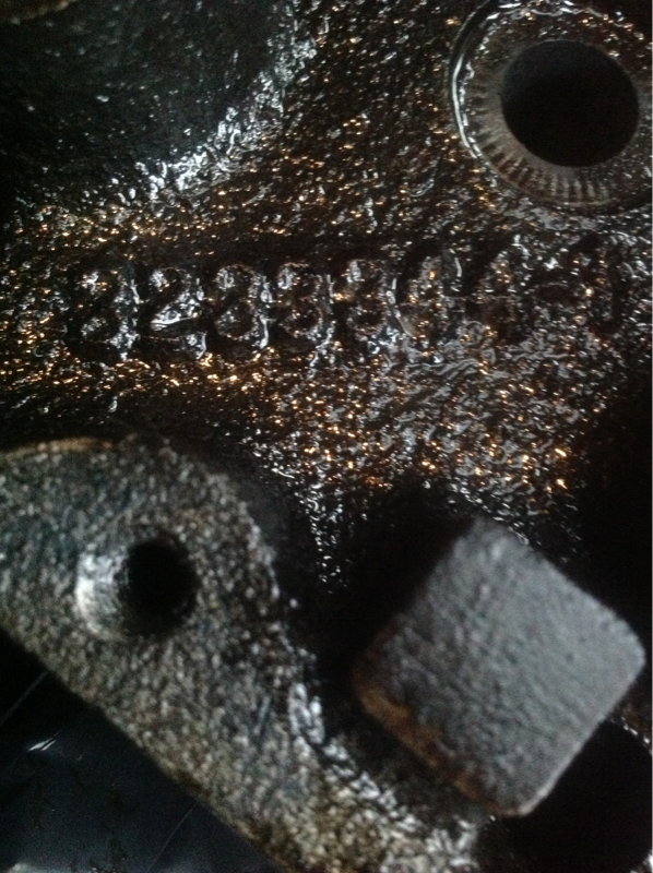

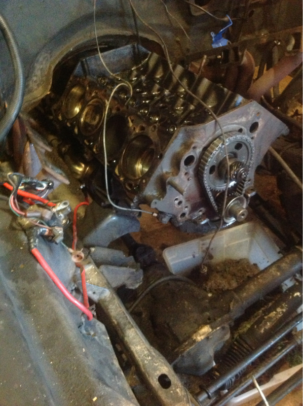

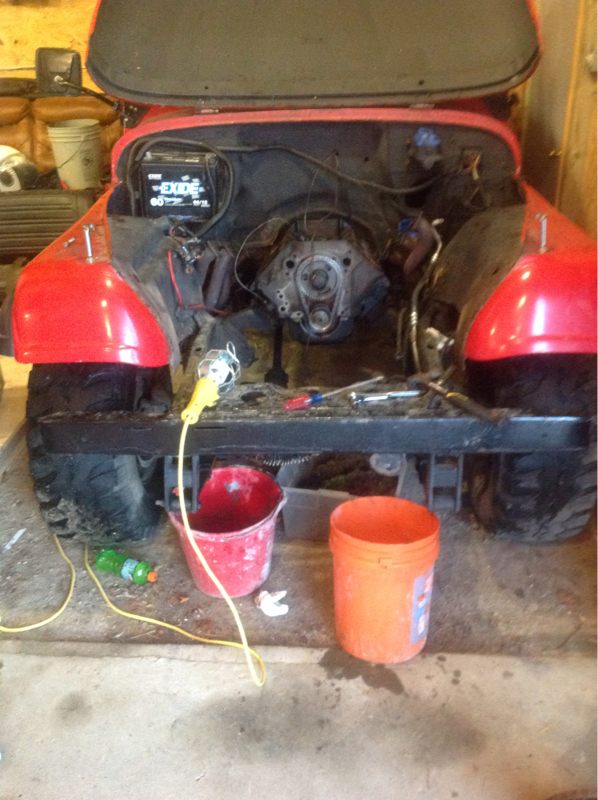

Home, got my "new" steering column ready to be mocked up. Looked at the casting of the block, says 360, measured the bore, 4.108 so they are .030 over 360 making it a 365 I believe. Got pics of the heads and the block in the jeep, little rough looking.

I have no idea about the ajustable rods, sorry, I dont know enough about rebuilding. I dont know what you mean about shaft or stud mounted rockers, sorry. can you post a pic. If you havent cleaned up those heads, they look better than a lot I have seen. most I have seen were caked in oil sludge.
