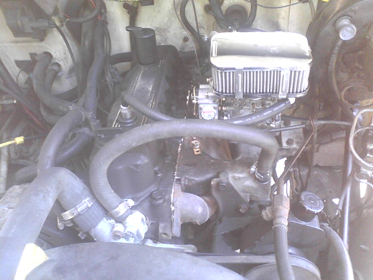

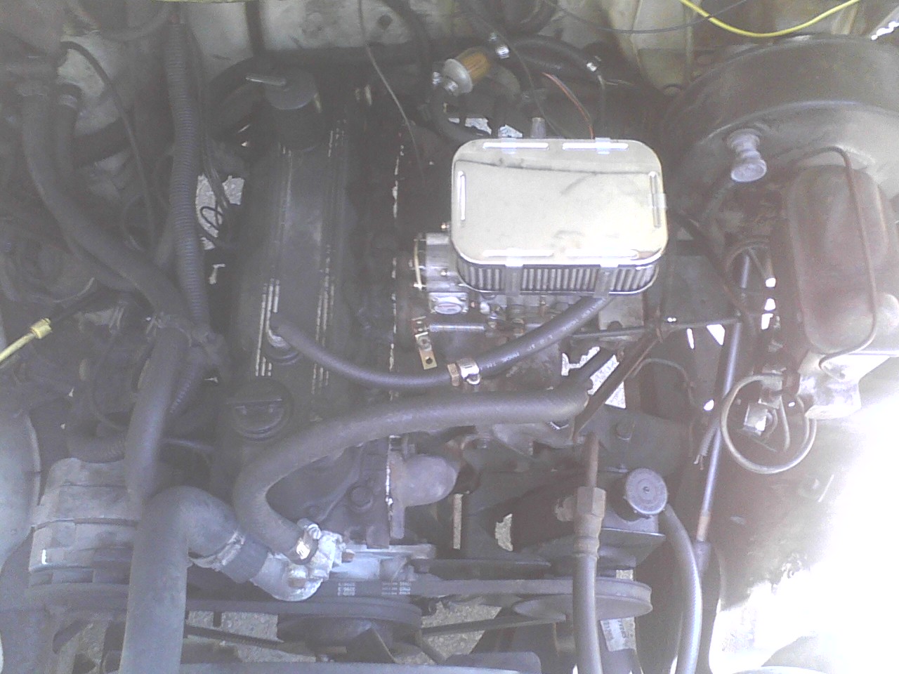

This is my first post here. Ive been searching far and wide for some information that can help me with a problem I'm having but have so far come up dry. I'm hoping Ive finally come to the right place.
I have an 87 YJ with a 2.5L GM 4 cyl that was EFI but I have started to convert it to a carburetor setup. I just got tired of chasing down all the faults with the original system and the horrible performance that came with the EFI system. I replaced the throttle body with a 36/38 2bbl Weber for the 6 cylinder and modified the intake to accept it. Replaced the original fuel pump with a low pressure pump for use with a carb and am now at the point that I need an ignition system. For a while the original distributor worked and the Jeep ran great, better fuel mileage and much more power but an electrical issue caused the original ignition system to fry. So basically I need a distributor and ignition system that will work for me. I havent been able to find an HEI distributor and I dont know if the Ford style module setup will work. What do I do? Any advice or information would be greatly appreciated.

I'm looking at your current vacuum lines and see a couple problems. You have your PCV valve routed to the air cleaner (A FRAM breather should go there instead) I have HEI distributors in stock if needed still. I own a Motorcraft conversion business.

were there any adapter plates involved ? i understand the center might have to be hogged out a little for the two throttle plates on the weber , but did the weber bolt right up to the intake ?
