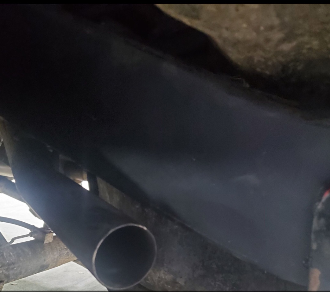

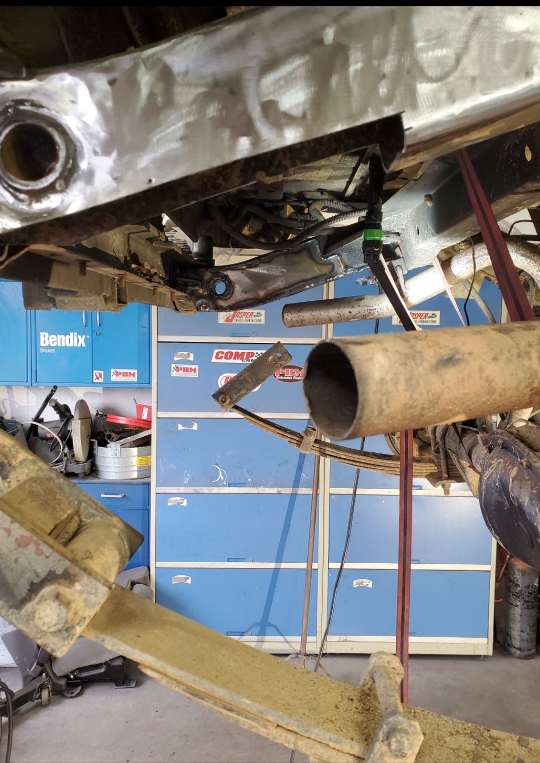

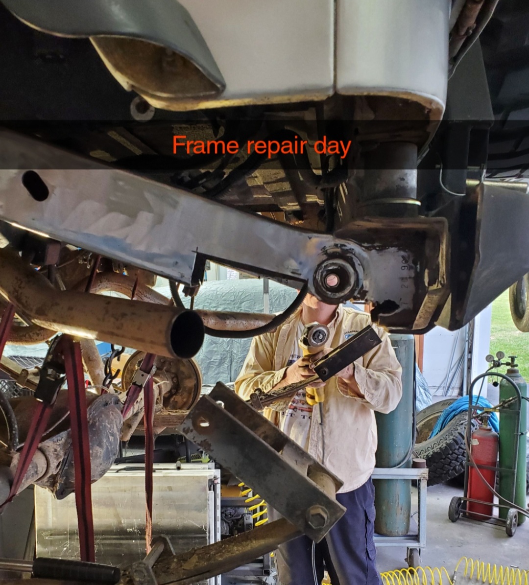

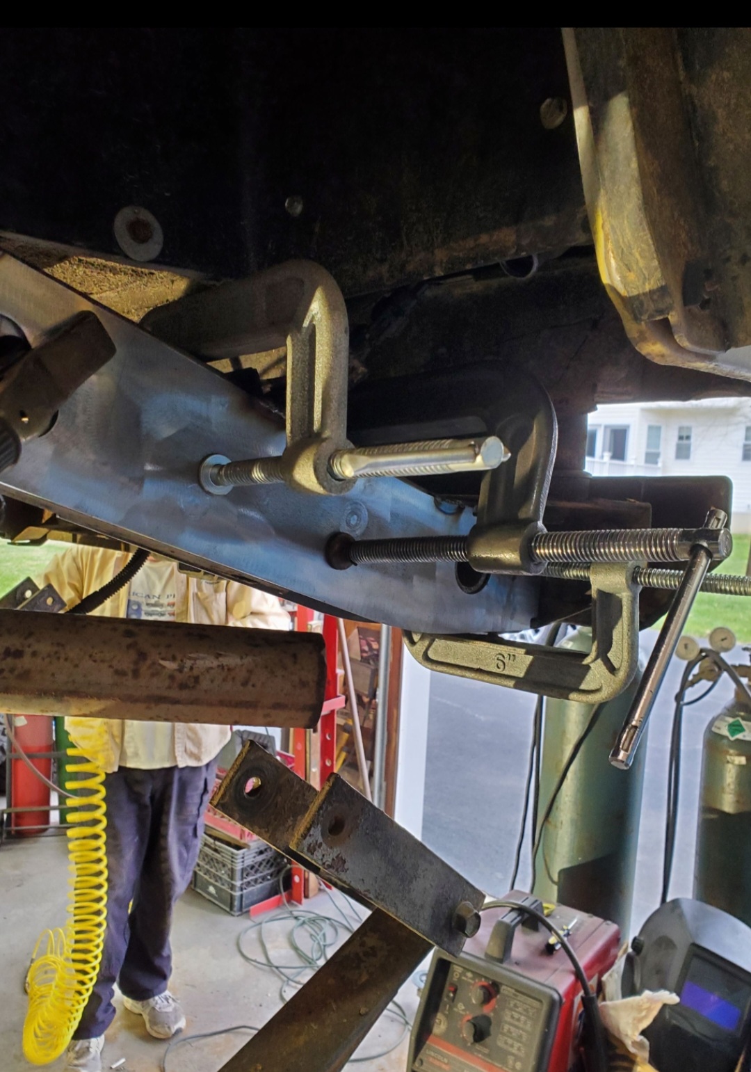

I just recently did my rear frame ends. I got the stuff from Taboo Customs. He also posted a well informed video of the process involved. I was a little intimidated before I started but I was surprised that I got everything done for both sides in about six hours. I dropped my tank and used a lift. Also be sure you have the correct spring bushings. The ones I ordered only fit the stock size spring eye. I had to wait a few days to completely finish the job.
