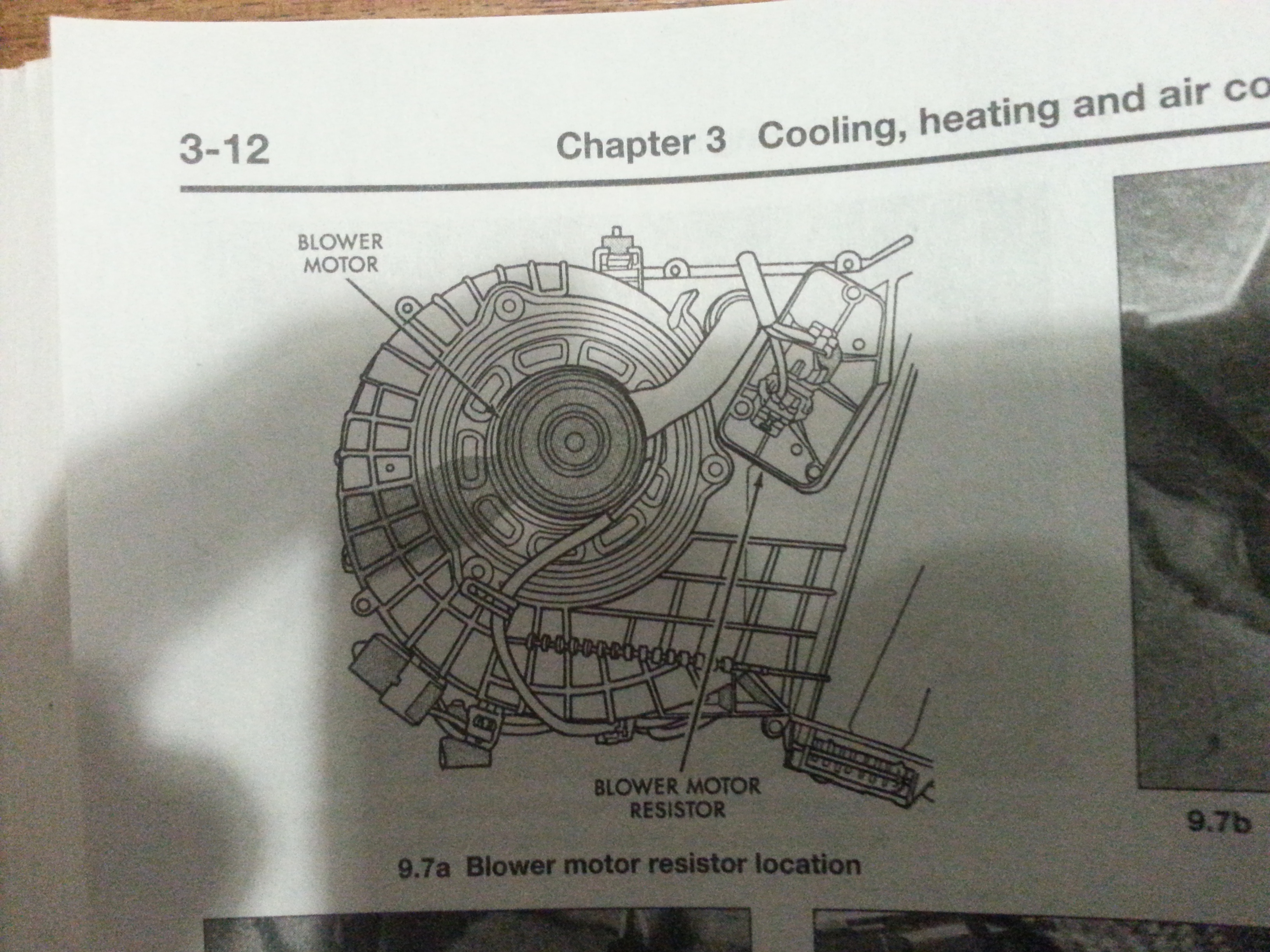

I have a manual, I''l try to take a pic and post a wiring diagram. For the vents, may have to check your actuators behind the dash/nobs that control vent settings. Had an escort that disconnected so didn't work right, was doing what you described. would work a little but not right. Definitely a resistance or short if your blowing a 50A fuse. Too high of a resistance in the motor could slow air flow if motor too working hard. As well check the vent channels, they may have come apart when switching the blower motor causing improper flow. It kind of sounds like the dealer messed thing up more than fixing anything. Did you have any of these issues before you took it in for repair? If you had a meter you could check where the resistance is coming from

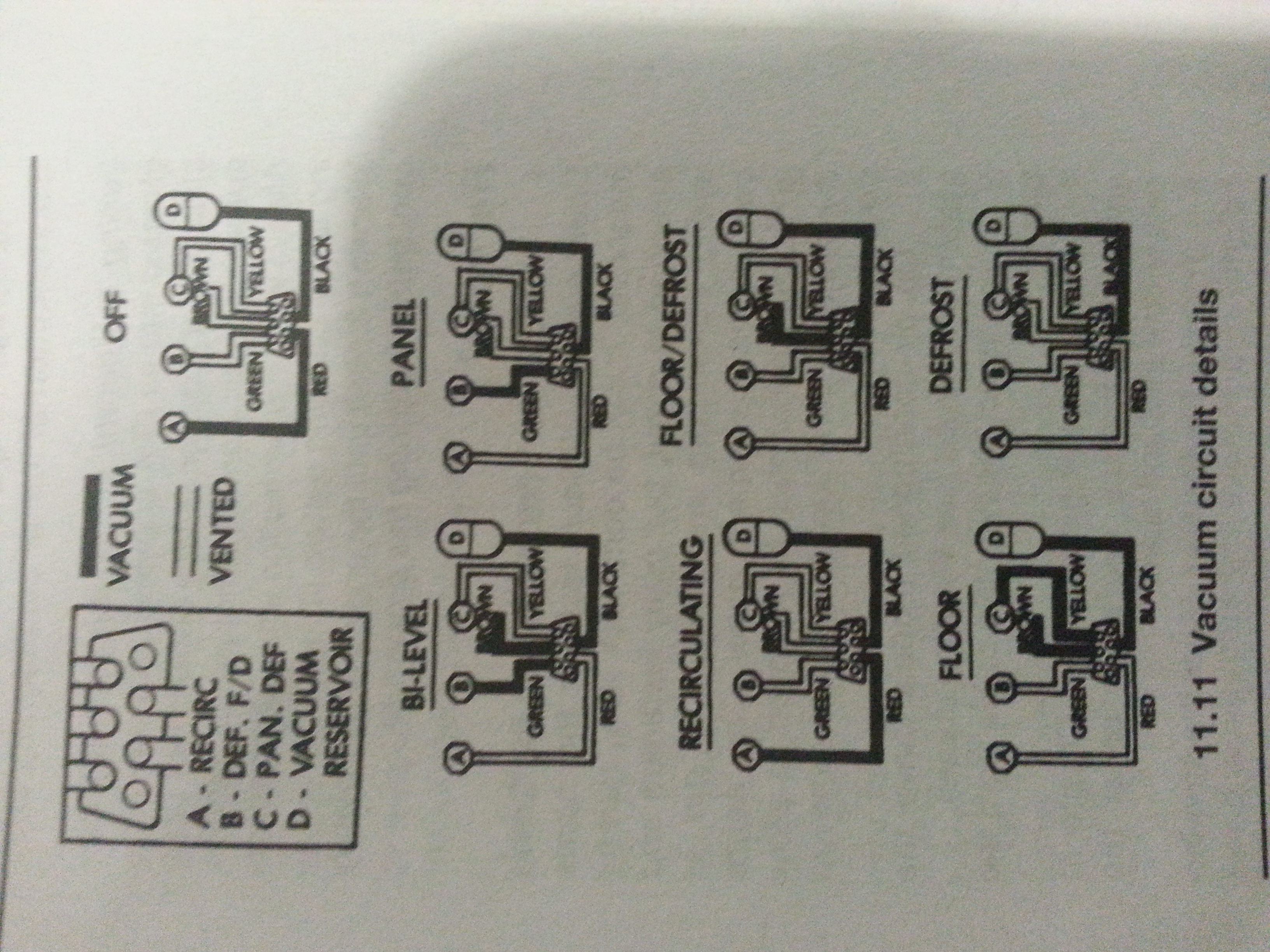

Ok so no schematic for heating circuit in the manual and no actuators for control, is vacuum lines
Manual is lacking for this, but this is what I got, hope it helps
