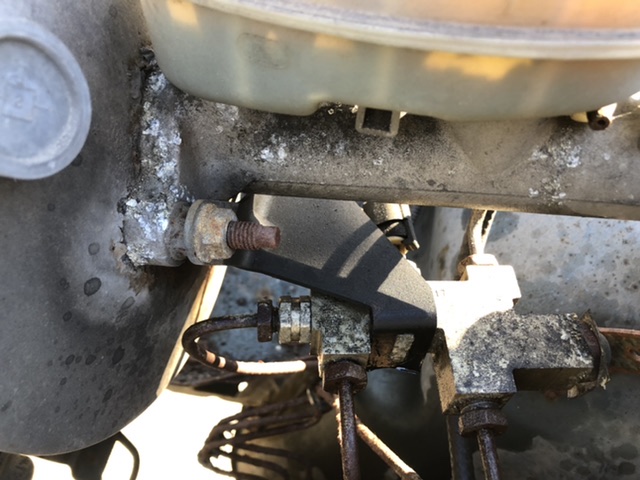

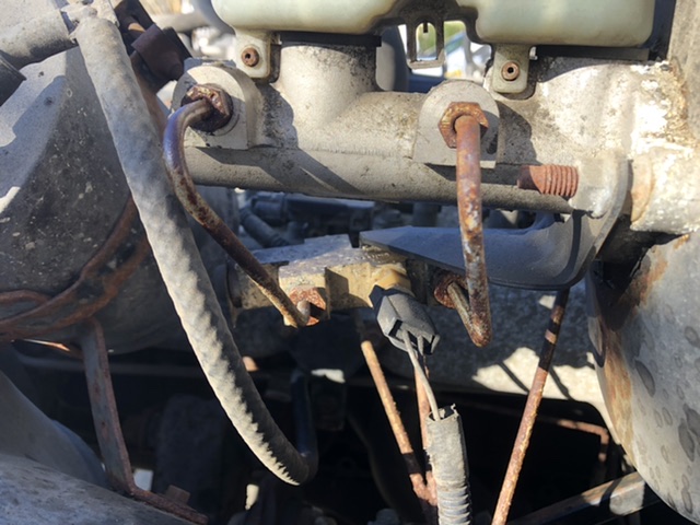

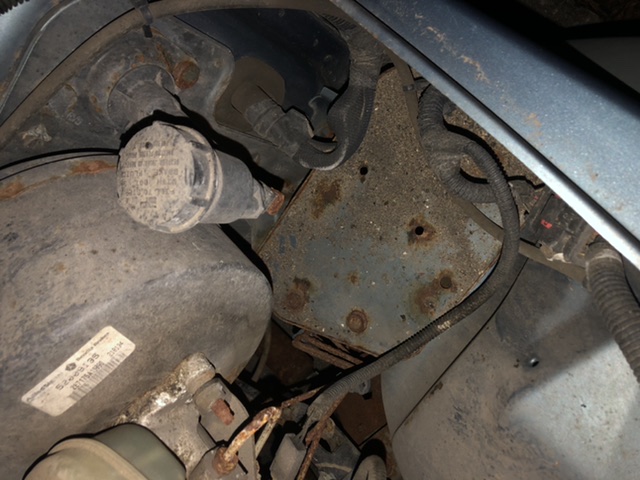

So my 97 tj sport has blown a brake line. The rest are just as bad. I can’t determine based on what new lines to by if I need abs replacement lines based on what I see under the hood.
non abs doesn’t seem to have enough lines while abs replacement lines have all the seemingly correct brake lines. 🤔🤔🤔
see my pix as I’m at a loss as to what buy to replace all the brake lines from master to wheels.
Is the splitter just a brake warning system? I don’t see/find an abs pump anywhere. The two lines from the master to the splitter don’t appear anywhere in the non abs lines available for sale that I can see.

Not an expert here, but don't you need a abs sensor (with a wire connected) to each wheel to have ABS? You may look for that.
Yes. I don’t see one at any wheel. The replacement for non abs doesn’t include the two short lines from master to splitter hence my hesitation. The abs version does have the lines and the lines to the wheels are different lengths for each version.
So it’s not abs. I found the right lines that include all the correct parts. 🙄.
didn’t realize that was a proportion valve.
new to jeep ownership. Old to mechanics.
friend gave me his 97 tj. Have a lot to learn.
ABS was an option on the 97 TJ.

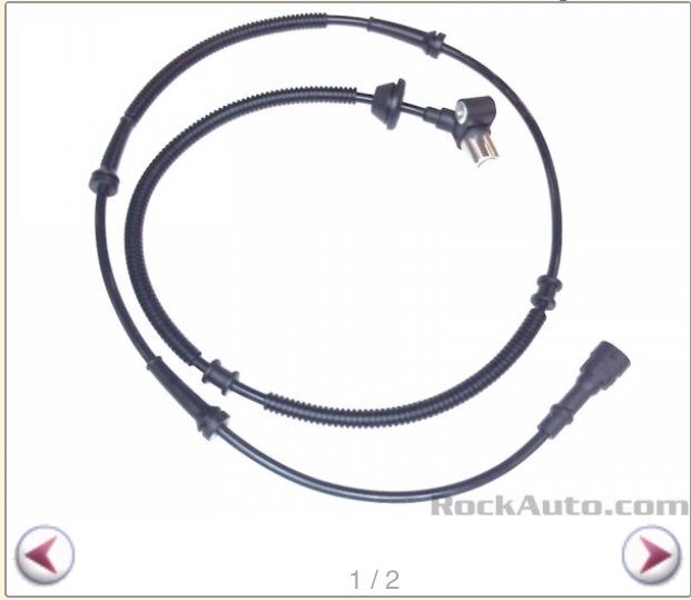

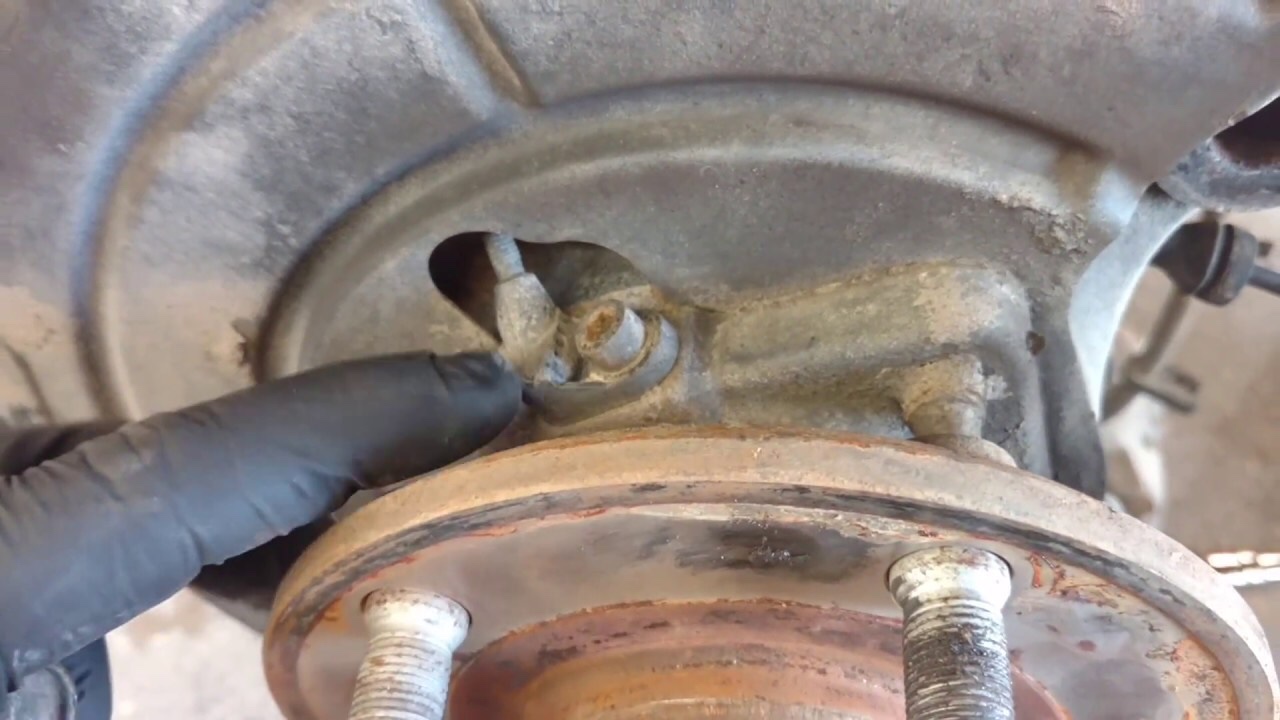

Here is a rear speed sensor image and what it looks like installed.
