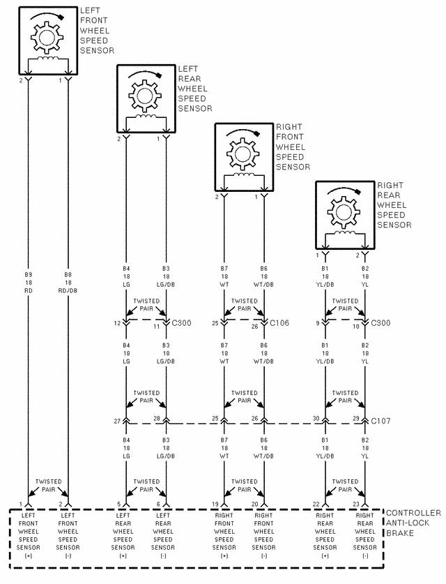

Anyone happen to have a schematic on this? I could read the wheel sensors with my oscilioscope if I knew where to look. I hate to go to the dealer, not only the cost/incompetance factor, but it's a big hassle to get there while they are open. :cry:
Oh, I see a toothed ring near the front end sensors, I assume the sensor counts teeth. Do these get gunked up? Is there any point to pulling the sensors to inspect or clean them?

The DRB 3 is a Chrysler Scantool that reads/scans all the modules for DTCs, Monitors and actuates sensors and is also used to Program or Flash the Modules. It also has a built in Labscope..Anyways, Schematic diagram is not a biggie, i've attached the wheel speed sensor diagram for you. if you need additional schematics, let me know what component you need it for. and , YES , the Teeth you see on the back of the wheel bearing assemblies are the TONE RINGS.. each of the wheel speed sensors are Hall effect sensors, it relies on the gaps between the toothed rings for reference of speed. if at any point in time that one of the tooth breaks or get's mangled or even an accumulation or metal particles stuck together with grease, the reference signal from that sensor is no longer true. in this case, you may encounter a premature engagement of the ABS during a turn or even in a light braking situation.. also, the Air Gap on these sensors are preset and are not adjustable, however if the sensor has been pulled from the wire or any other means and disfigured the sensor away from its proper position, this will also give you a false signal.. If i was in your shoes, i would correct the calibration of the speedometer first just to take that out of the question.i think i've said enough or too much, but let me know what info. you need that i can help you with.

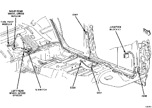

Thank you so much. Perfect explanation on all accounts. Two out of three have connectors between them and the CPU, so I should be able to get a scope on then without piercing the wires or anything. You don't happen to have the component locator that tells where the connectors are, do you?

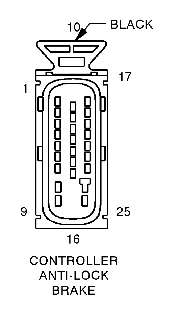

Here's the Connector locations. All the Sensors have connectors on them, just follow the sensor wire from the sensor and you will find a connector at the end of it. Also ,here's the Controller pinout's.
CONTROLLER ANTI-LOCK BRAKE - BLACK 25 WAYCAVCIRCUITFUNCTION1B9 18RDLEFT FRONT WHEEL SPEED SENSOR (+)2B8 28RD/DBLEFT FRONT WHEEL SPEED SENSOR (-)3G7 18WT/ORVEHICLE SPEED SENSOR SIGNAL4F20 18DG/PKFUSED IGNITION SWITCH OUTPUT (RUN)5B4 18LGLEFT REAR WHEEL SPEED SENSOR (+)6B3 18LG/DBLEFT REAR WHEEL SPEED SENSOR (-)7--8Z3 12BK/ORGROUND9A20 12RD/DBFUSED B(+)10D25 18YL/VTPCI BUS11--12Z1 18BKGROUND13B43 18PK/ORG SWITCH TEST SIGNAL14B41 18YL/PKG SWITCH #1 SENSE15--16--17B42 18TN/WTG SWITCH #2 SENSE18L50 18WT/TNBRAKE LAMP SWITCH OUTPUT19B7 18WTRIGHT FRONT WHEEL SPEED SENSOR (+)20B6 18WT/DBRIGHT FRONT WHEEL SPEED SENSOR (-)21G9 18GY/BKRED BRAKE WARNING INDICATOR DRIVER22B1 18YL/DBRIGHT REAR WHEEL SPEED SENSOR (+)23B2 18YLRIGHT REAR WHEEL SPEED SENSOR (-)24Z3 12BK/ORGROUND25A10 12RD/DGFUSED B(+)
