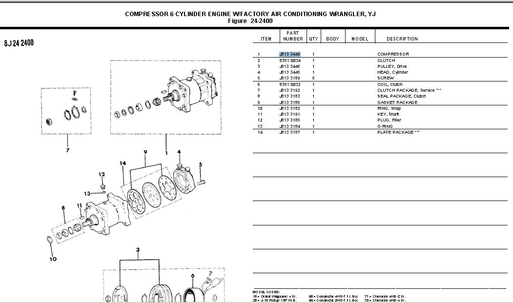

I'm considering adding AC to a 89YJ 4.2 with a serpentine belt. While there are kits available for this none appear for the serpentine set-up. I have a flat mounting spot on the right side of the engine with the alternator below and have seen routing diagrams supporting this. Is there a compressor that bolts directly to that and if so is this a standard compressor for the 4.0?
Thanks for any input.
Paul
89 YJ
this is compressor factory air...
be sure to get pulley/clutch for serpentine.
Look for a sane year jeep engine in junk yard might be helpful - brackets etc.....
