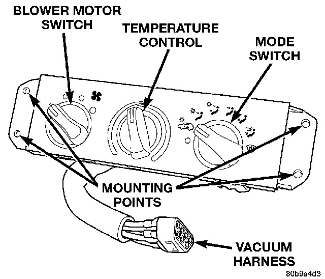

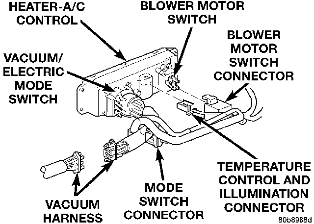

To me it sounds like the Vacuum control mounted behind the HVAC control head. it would have a 3 or 4 electrical spade connector and a series of colored Vacuum lines plugged on to it. the detent section has probbably fallen apart. if thats whats broken, I've got one just laying around. Free but you pay for the shipping. Take a Picture of what you found so we know if i have the correct part for you. and for anybody who needs a Knob, i have 2 of them, also for free, you pay for the shipping. send me a P.M. to who ever is interested.
