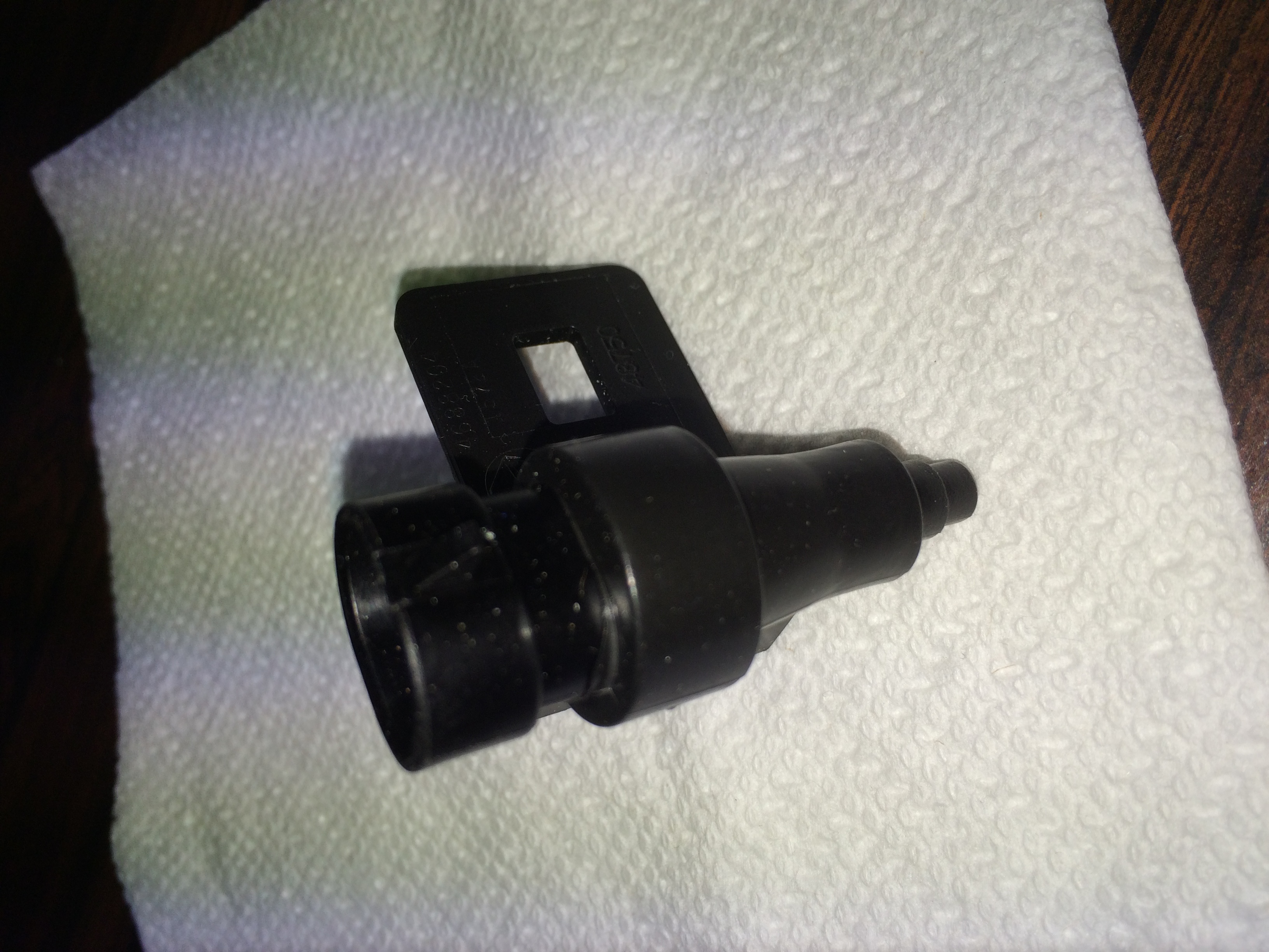

My check engine light was on so I went to my local Advanced Auto and bought a new (after they probed my computer) ambient air temperature sensor.

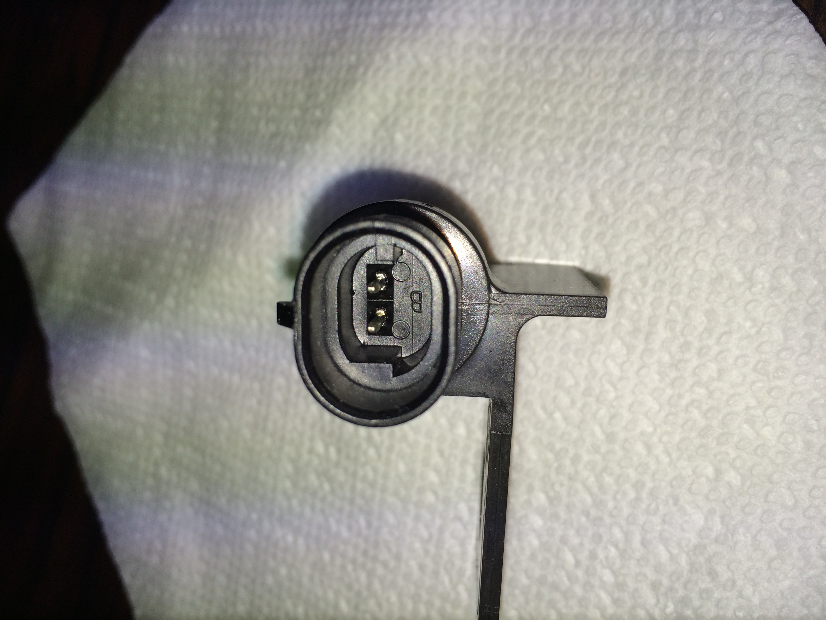

It's a two wire module with a sensor on one end.
My problem is that I can not find where they hid the sensor.

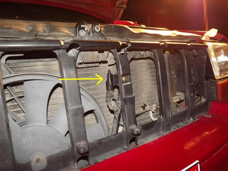

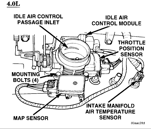

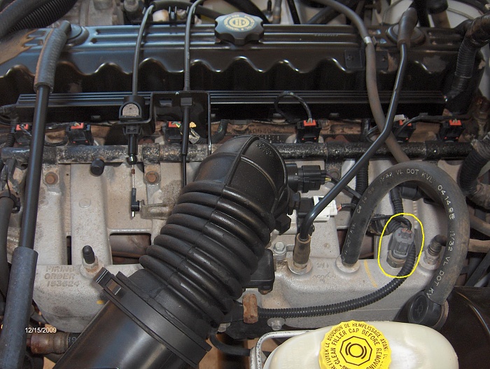

Wow! Thank You JPNinPA. Good information and great photos.

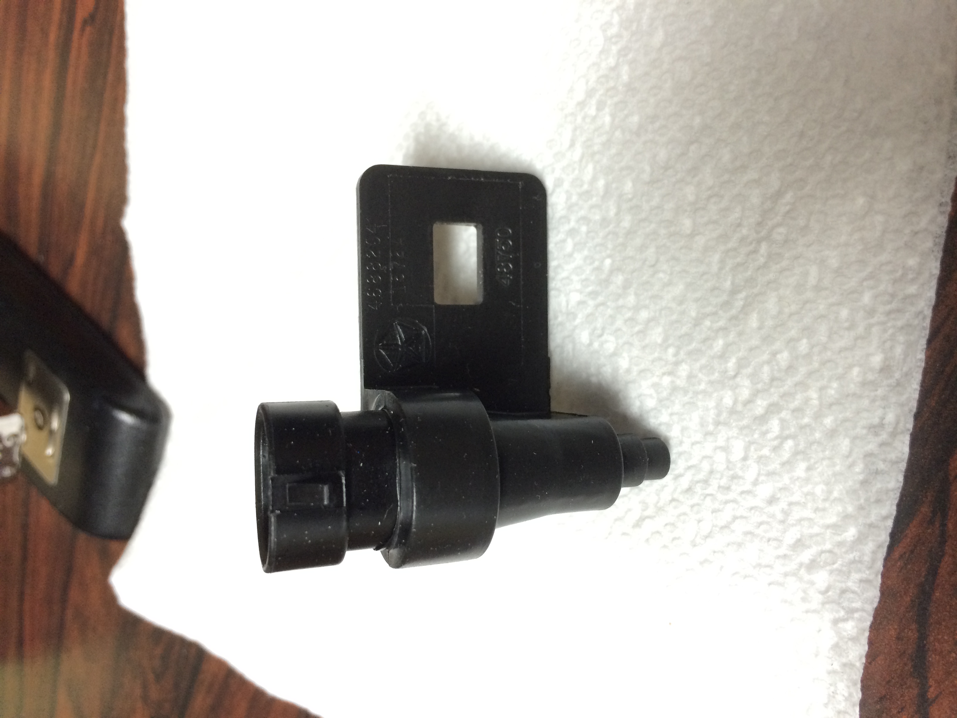

What I am looking for is the "ambient" air sensor. It is mounted somewhere with a bolt.
I will attach photos so you can see.

You da man.
Would never have guessed.
Thanks JPNinPA
