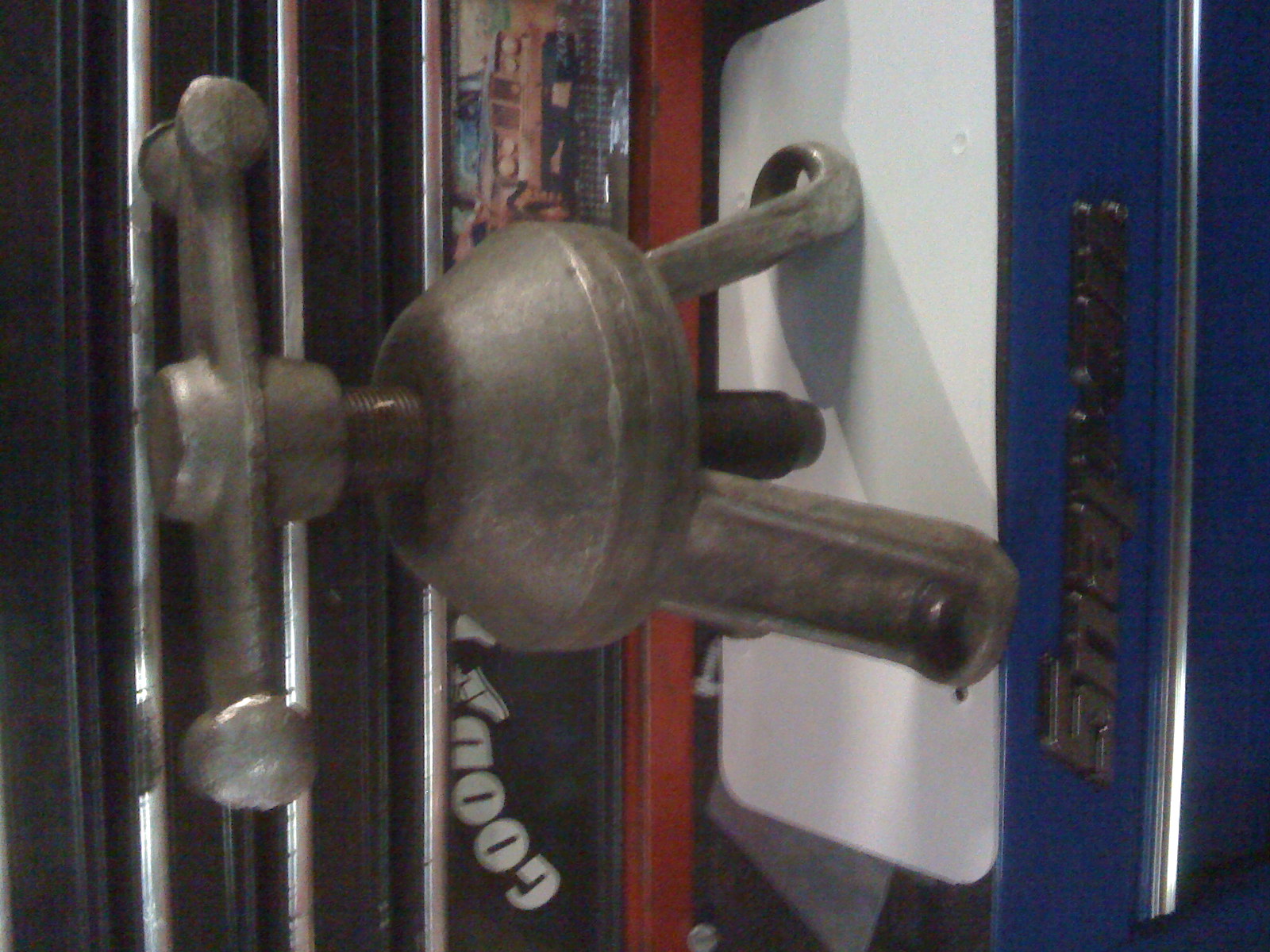

Have you tried calling your local parts store to see if they would lend one to you or rent it?.. I used the Factory tool to remove the hub off the axles on my AMC 20, and even with that tool, it was tough breaking the hub loose . It's a conical shaped tool. the outside of the cone has a lip with holes that matches the hub's bolt pattern. the center has a large bolt with the end having a T handle. You install the tool on the hub using the Lug bolts from your wheel and screw in the center bolt tight and use a dead blow hammer to break the hub loose.
Thanks. If I can't find one to borrow, what are my other options? how do i know I have the right one? have you run across these online anywhere?
This is what the tool looks like. It's made by Snap-on tools. Part#4567-G. I dont know if its still available.

I didn't have one and couldn't find one when I pulled my axels about three weeks ago. I just pulled everything off but the hub and smacked it with a hammer... they slide out surprisingly easy.... I definatley suggest the puller if you can find one though
yeah we used one of those when we pulled the hubs off my friends cj5 we had a h*ll of a time with the tool. they would have never come off without it.
