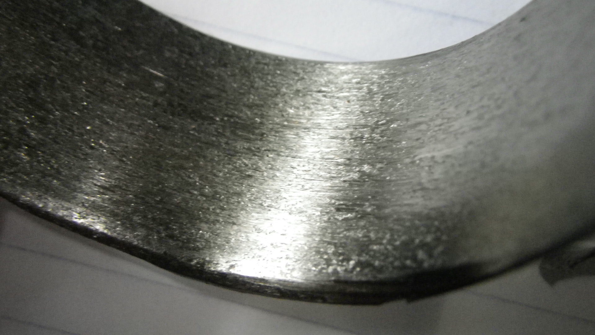

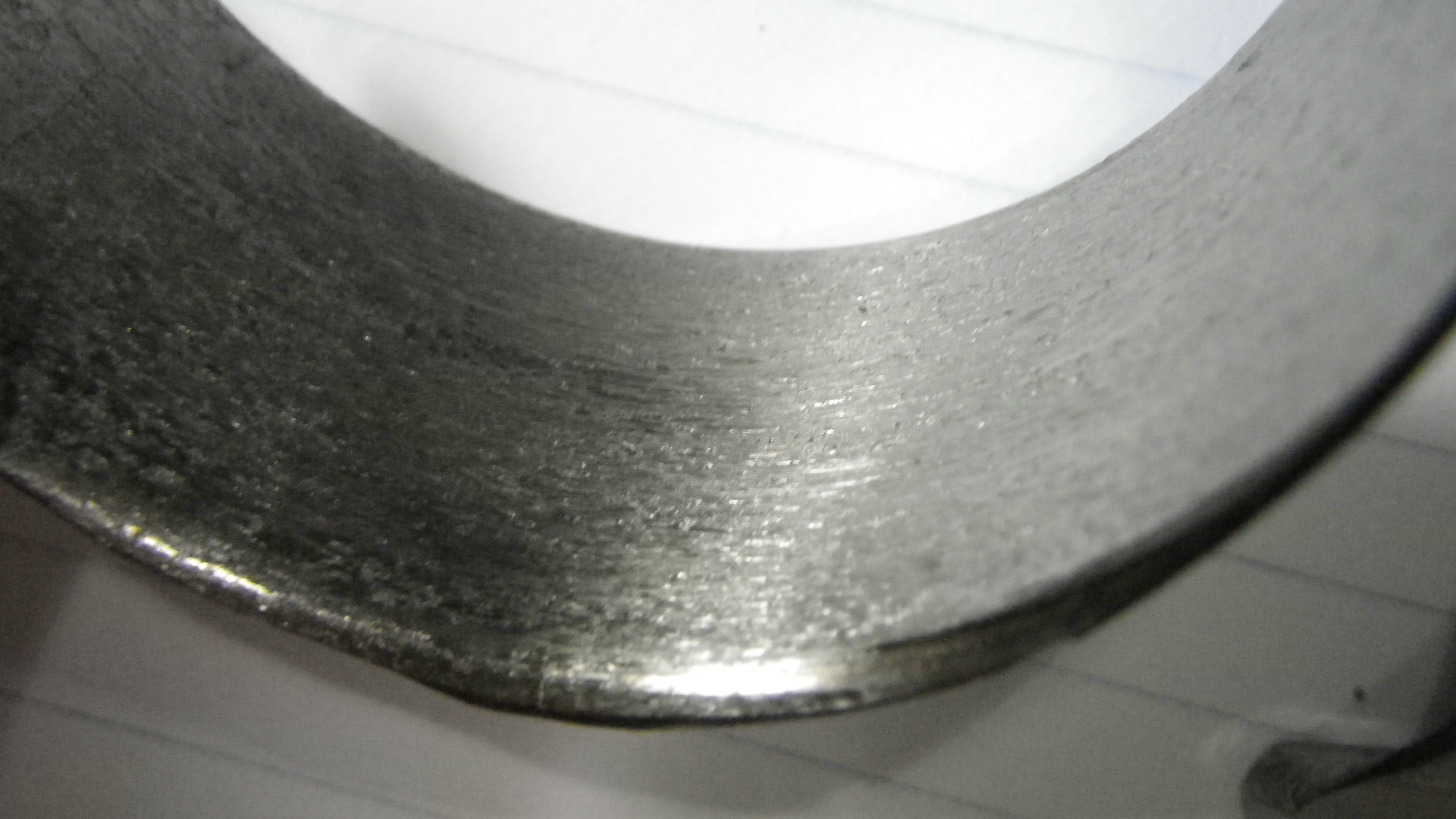

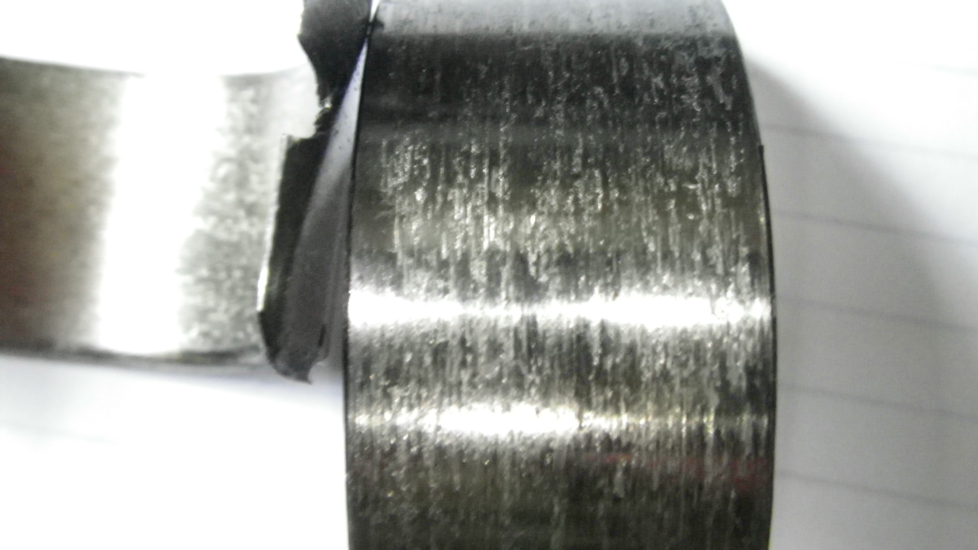

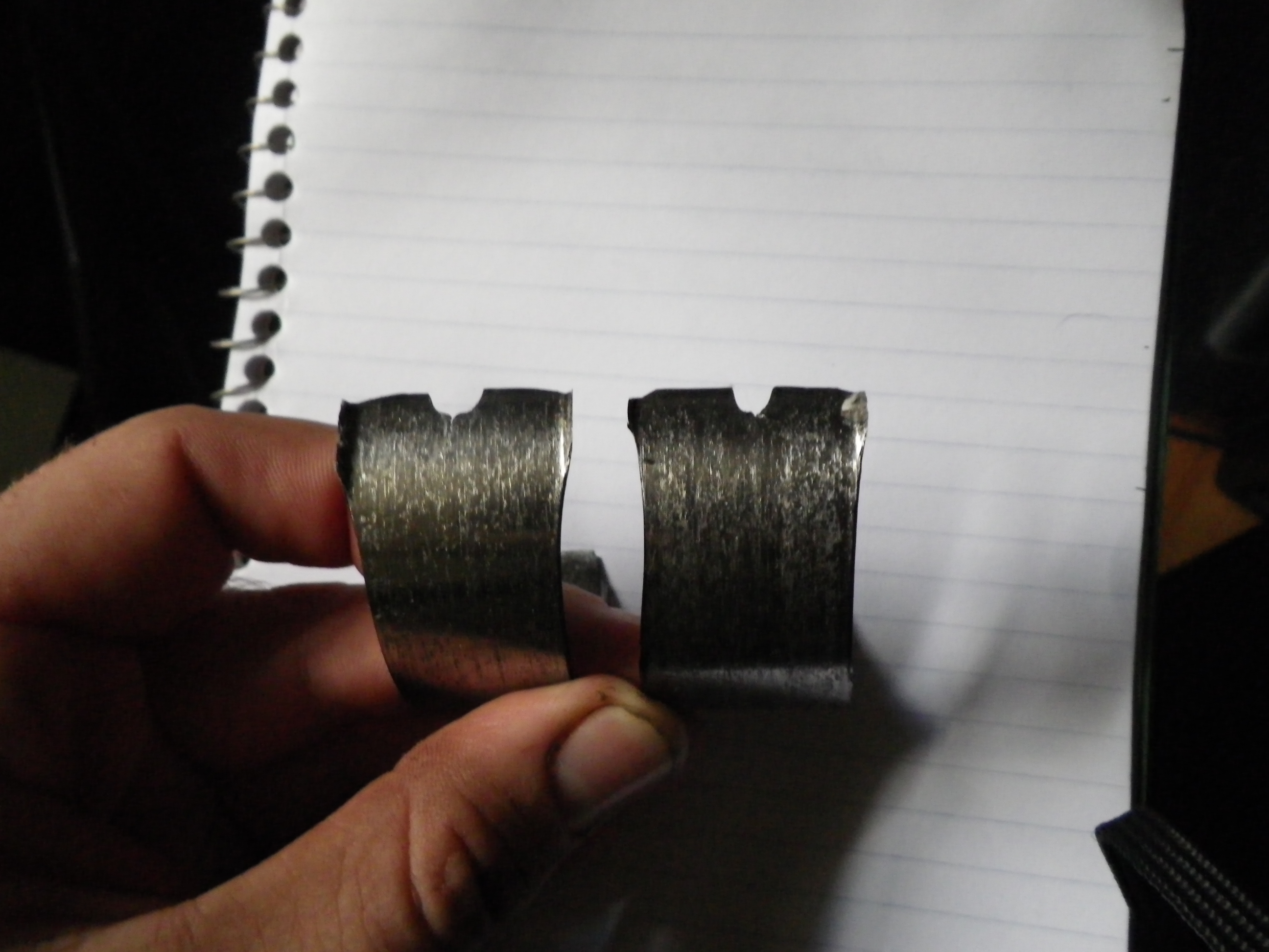

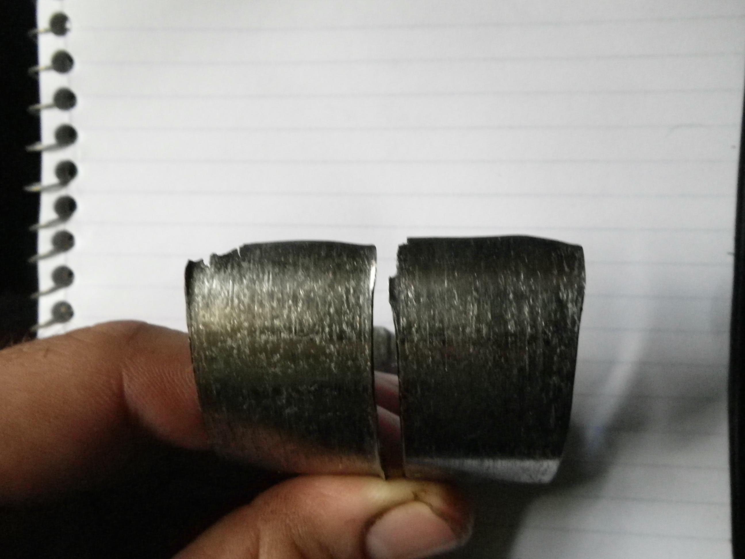

Another sunny day leads to more Jeep fixery. Found my 6th piston bearing to be down-right SLOPPY. :( But it's certainly what the terrible noise was. I'm going to check tappets when I finally get them out and I think my oil pump is fine (you're right Tyler Bates) but now that I went through the trouble I'm checking as much as I can. Thanks for all the help, and I'll let you all know when I get it back together.
Here are some pictures of the bad bearing. I just wanted an opinion on the minor scoring, and if that is going to mean that I need to get the crankshaft re-worked. It seems to have LESS scoring on it than these do.
They still FEEL perfectly smooth, but obviously, have been worn.

Winner winner chicken dinner.
Regardless of being smooth, it's pretty worn and you can see the highs and lows. you can just replace that bearing, plasti-gauge it and se if you are with in tolerence, you SHOULD be fine, but if it were me, I would pull the motor, strip it, line hone the crank journals, polish the crank, all new bearings on the bottom end, put back together, new oil pump (your in there, might as well do it now) time it, and get another 30 some odd years out of it.
and while the block is at the machine shop, I'd re-ring the pistons and when you get the block back, hone the cylinder walls.
all in all, you do majority of the labor, shouldn't run more than $500-600 soup to nuts, then the motor will run another 30 some odd years

If it were me Id either buy a new crank or have yours turned maybe .20 over and then you could get bigger bearings on it. But I agree since you have it torn down save your self the trouble down the road and do the rebuild you will have all new gaskets rings bearings everything and be done with it for a lot of years
Understandable not having a garage to work in definatly creates additional challenges(i have been there) But in agreement with all the other advice ,if you are at the point of checking bearings do a rebuild and before you fire up the new one-----------Get an oil pressure guage. Then happy 4 wheelin!
