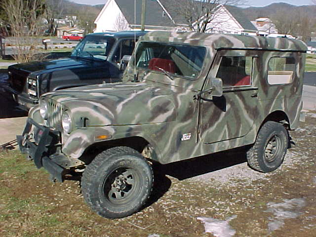

http://www.jeepz.com/forum/attachment.php?attachmentid=306&stc=1&d=1154656903
Well I hope this works! The above pic if it showes up is my dear old Tugly the CJ-7 dressed out in her rattle can camo via Wal-Mart and a sore finger from holding down the spray can top! Yes you can do a paint job with a spray can just dont think it will come out a nice even and shinny! Then again why would anyone one a nice shinny Jeep to start with with a dull old jeep you do not have to think if you should you just do and if your paint job does suffer a little a quick trip to wally world and a few bucks in fresh camo colors and your all set to go again. No problems hehehehe tug
