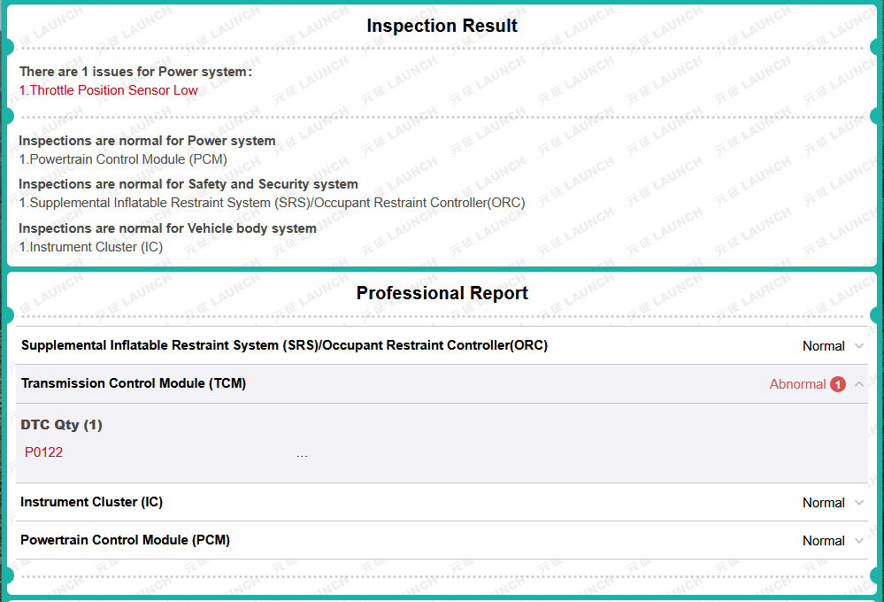

My 2005 TJ has started having a high idle. I'll start it up, and the idle will be normal for two seconds, then shoot up to about 1900. Once warmed up it will idle at 1200 RPM. My code scanner said that I've got a bad TPS.

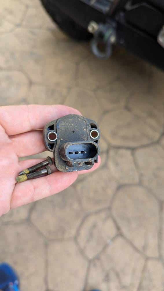

Ordered a new Mopar TPS from Amazon. It was easy enough to swap in, and the engine sounds good. Now. Idles are where I'd expect.
I probably need to put more miles on it before claiming success, but things are looking pretty good.

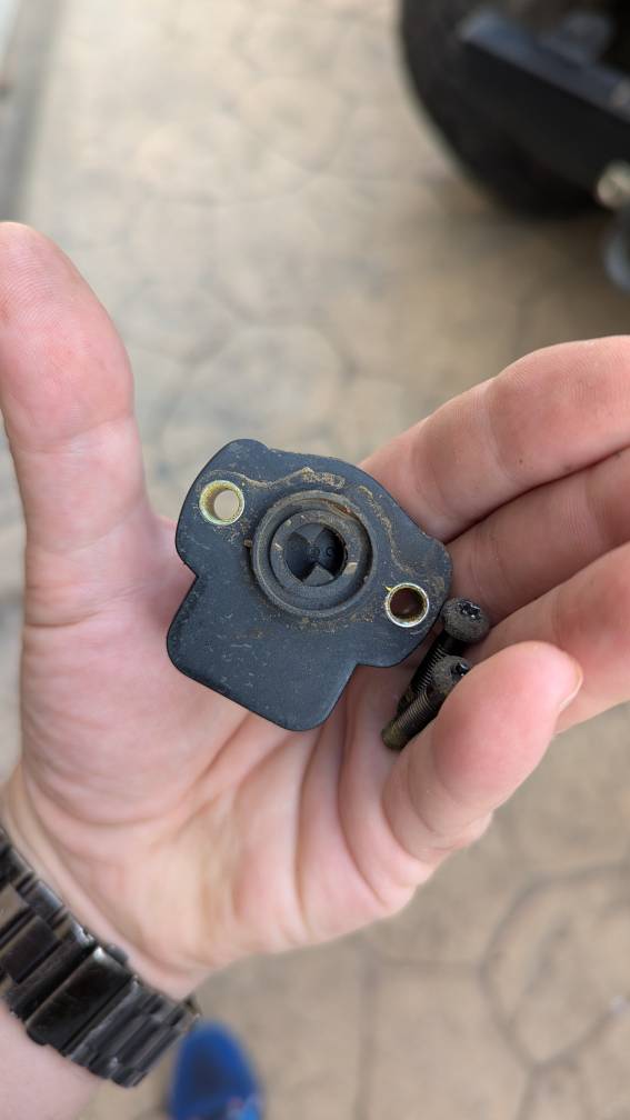

The old one, as well as the wiring didn't look very bad. Is there a way to clean these?
Sent from my Pixel 7 using Tapatalk
Dirt gets inside. Actuating it 1/3-1/2 turns and compressed air.
