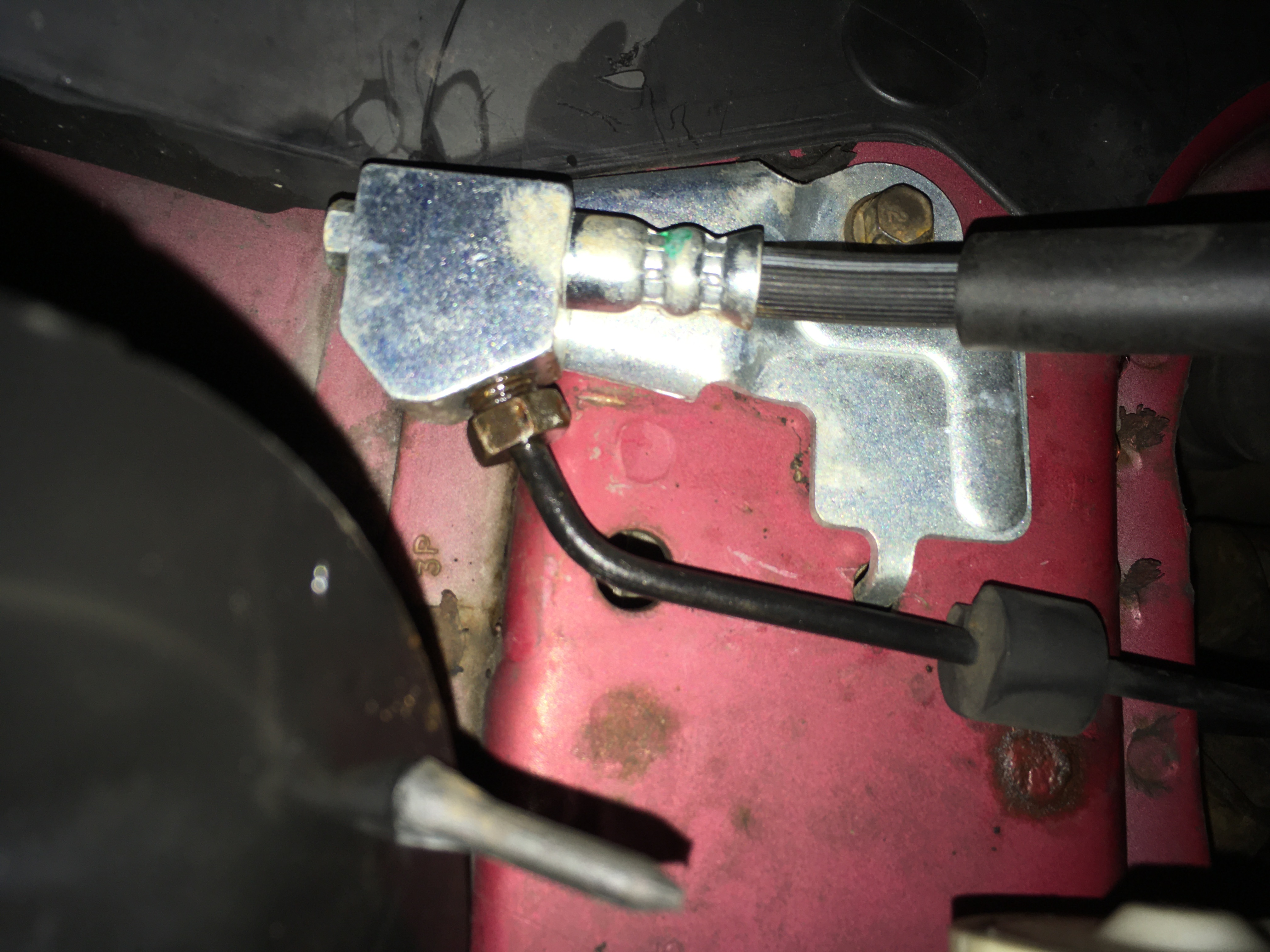

Only thing I can think of is that I got turned around somehow and when I went to loosen the first old front brake line from the solid line I ended up tightening the compression fitting (?) about 2 full turns instead of loosening. Not having replaced a brake line in a while I'd forgotten brake lines generally loosen right up once they're cracked. But dumb me forced that D#!& nut around twice and I'm guessing ruined the threads at that connection, and now that's what's giving me all the bubbles. The hex part or 'nut' I over-tightened is on the hard line that comes in from the left in the pic below.

Note, the picture shows some brake fluid on the threads of the nut I over-tightened. As a test I wiped the fluid off then pumped and mashed on the brake pedal hard (spongy) but no fluid came out again at that connection, it stayed dry. I guess it was on there from when I put it back together.
Any advice on what to do next or how to figure out if the bubbles are coming from the connection I may have ruined?
