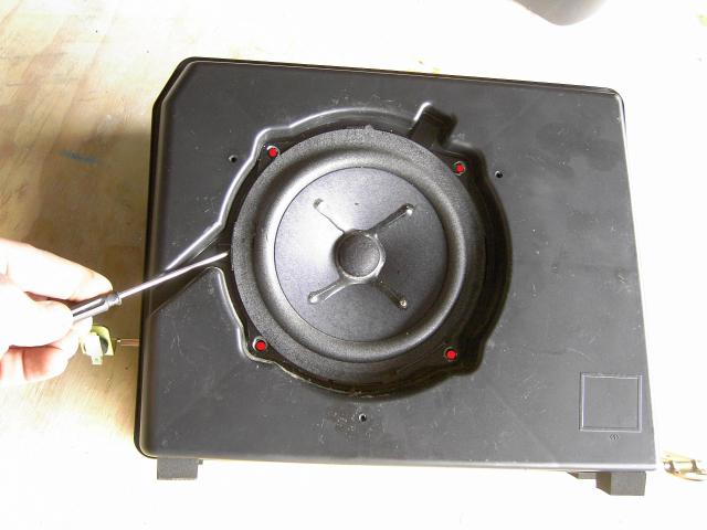

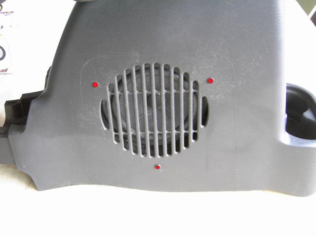

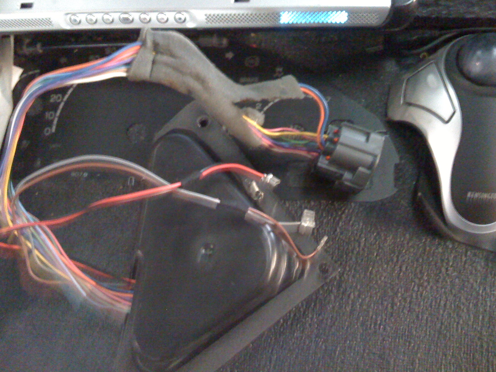

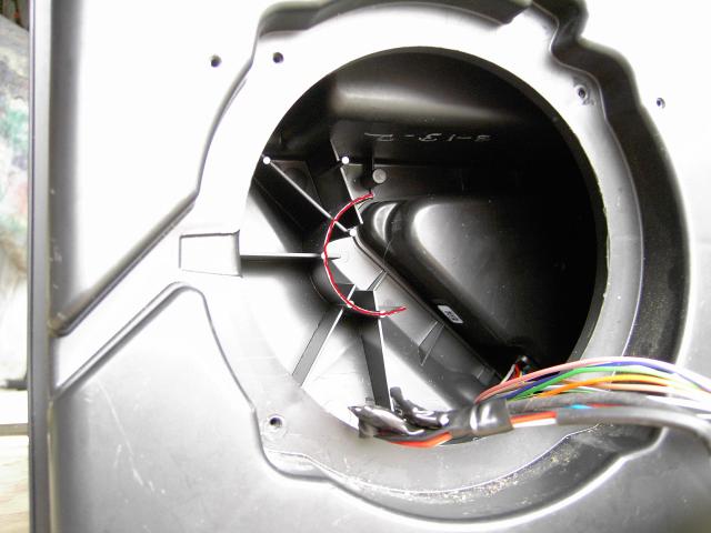

Here are a couple of photos of the stock subwoofer. The black enclosure that holds the sub also has the stock amp built in.

There's no way that you can put anything larger than a 6.5 in the stock enclosure. Take a look at those photos - a 12" sub would be larger than the box itself. As it stands, anything larger than a 6.5 will be too deep for that box.

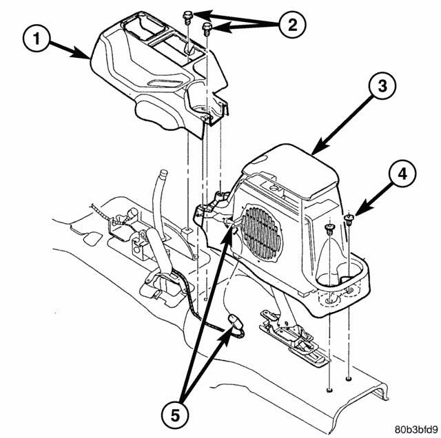

Here's a stupid question: how do you get to the #$%& stock subwoofer to replace it? I've managed to get the front half of the console off when I had to replace my shifter assembly, but the back half vexes and taunts me for some reason. I feel like an idiot for asking, since I'm fairly mechanically inclined (hence being able to do the shifter assembly on my own).
It's probably something simple, which will make me look like an even bigger idiot...
But, my replacement sub is being delivered today, and I'm anxious to get my sound system back up and running - like my tunes loud when the top's down.
Thanks for any advice!!
Success!
Thanks, Steel.
Just as I thought - something simple. I offer myself to all for ridicule today for trying to overcomplicate it.

To anyone else who might need to do this - wiring the new sub from Parts Express was a little different than the stock one. The stock sub had 4 wires connected to it, but doing so on the new one produced no audible response. Hooking up 2 wires only (in my '03, at least) did the trick nicely. Long term affects? Eh, we'll see. It's a $13 sub, so I'm not terribly concerned. Also, I recommend not reusing the screen from the stock sub. Not only did it seem to contribute to the blowout by chaffing the cone where it connects to the frame, but I couldn't see how it would fit with the new one without some mods. Plus, it looks kinda nice.
