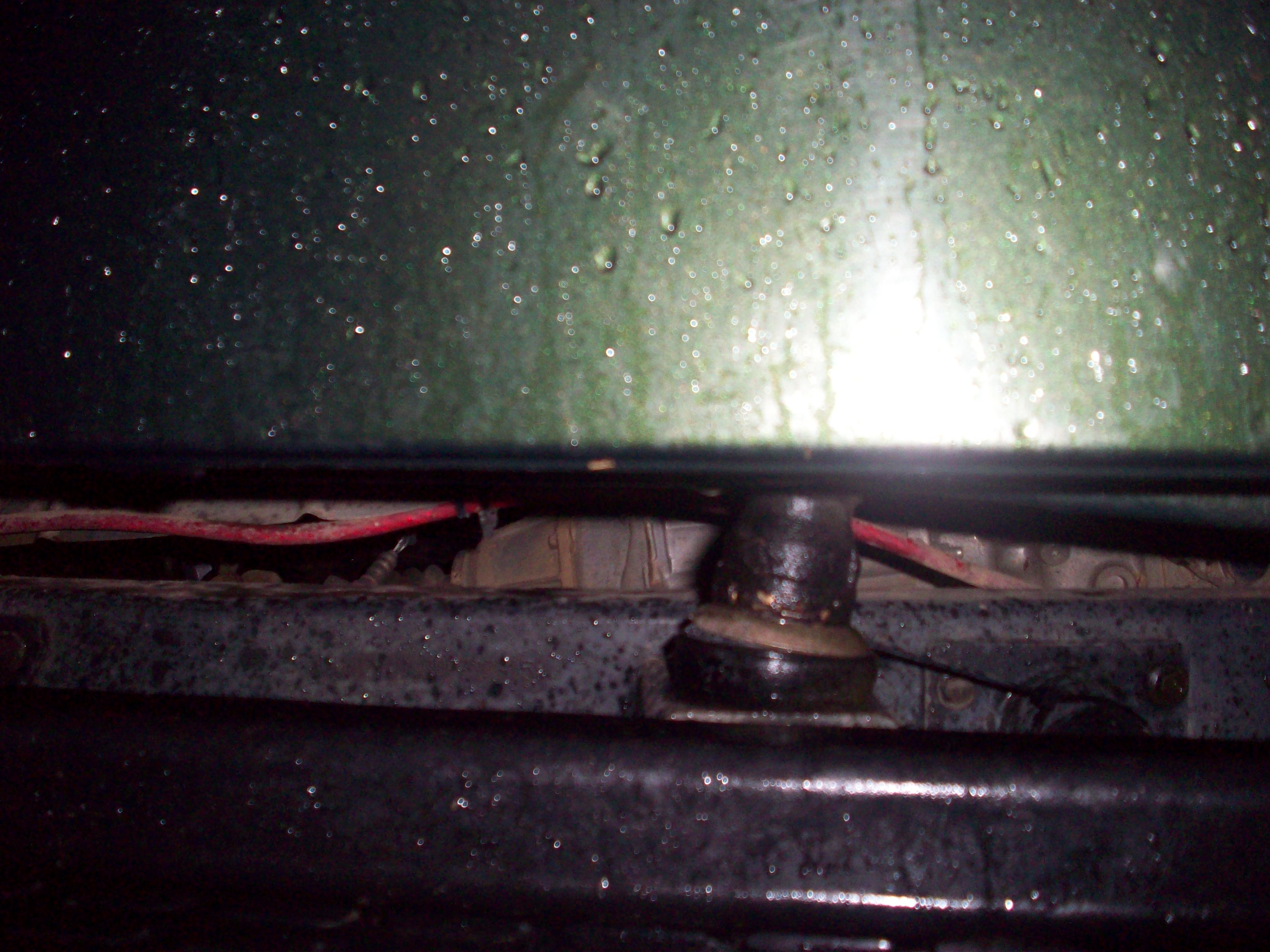

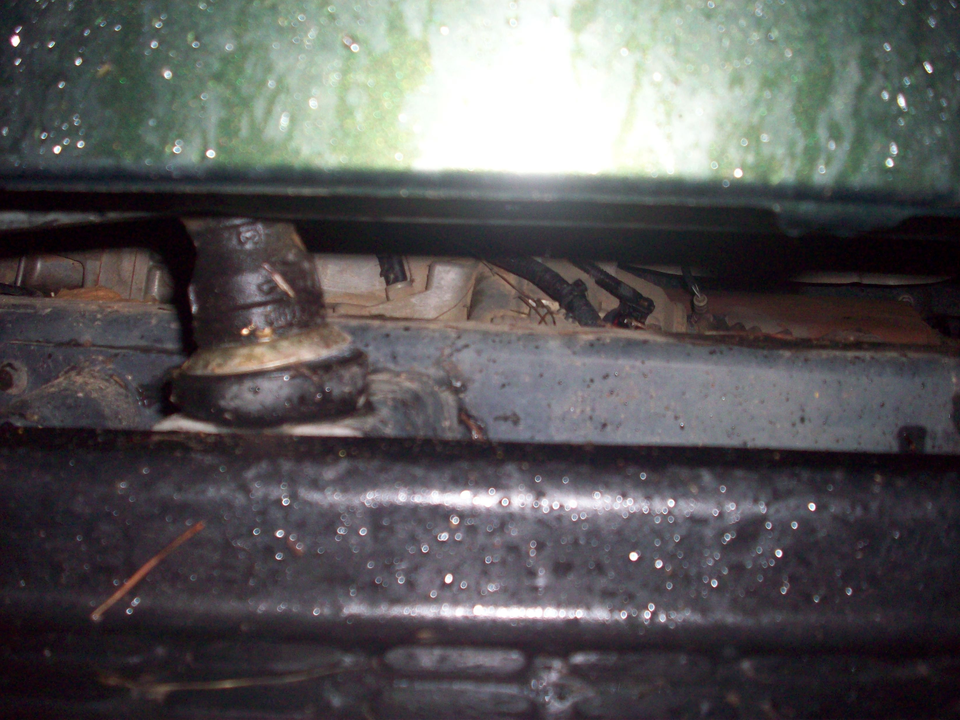

This is what happens when you have a body lift and have a minor wreck.....
Yeah well all I got say about body lifts is that they're a piece of crap! My jeep has a 2" body lift on it right now from the previous owner being a cheapass. But anyways long story short my jeep leans to one side now because i took a somewhat sharp curve one morning and heard the passenger side start to give way. The bolts through the body lifts were breaking under the stress of going around a curve and now 2 on the passenger side are missing must've fell out going down the road. So yeah definitely go with suspension lift, its both stronger and safer in the long run
