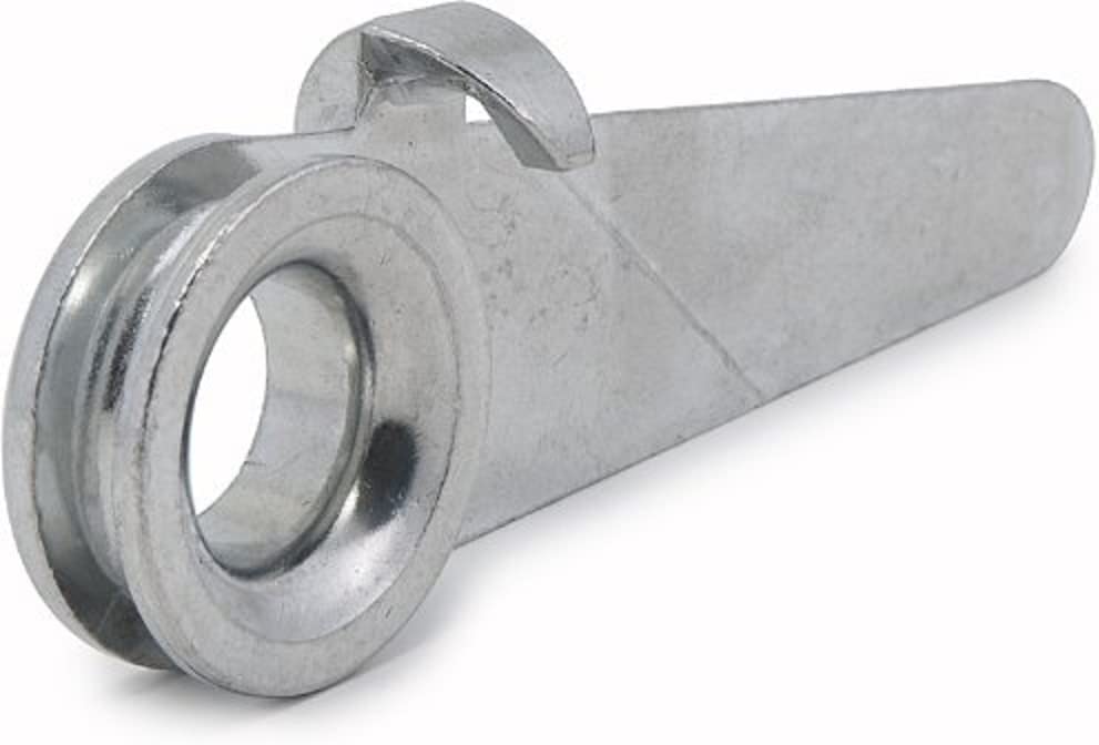

I'm with Mark on this. Head over to your local auto parts store and buy a pre-flared tube. Something like this will help you bend it without kinking it
https://www.amazon.com/Titan-Tools-11487-Tubing-Bender/dp/B0069TROZA
