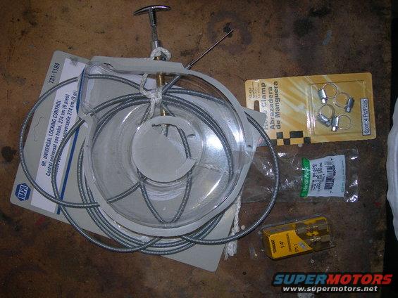

I am planning to get the cable to put the front axle in 4X4 and doing away with the vacuum is there anything I need to know about doing his and were is the most common place to mount the pull handle?

i did it on my 87 wrangler front end. you have the split axle on the passenger front side with a collar that slides over and lock it together when you put it in 4x4? thats the vacuum actuated part you want to replace, correct?
i used a cable that was a generic choke cable for a carbureted engine to pull the pull the collar back and forth.

I'm not seeing anything to do with wires so I am going assume that undoing any wires and plugging off vacuum lines is not going to bring warning lights on the dash.
