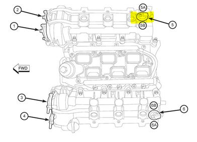

There are 2 cam position sensors on that engine. Be sure to use OEM sensors. Check the wiring. Also reset the codes after replacing. If resetting doesn't work the there is a relearn procedure the dealer can do for the new CPS.

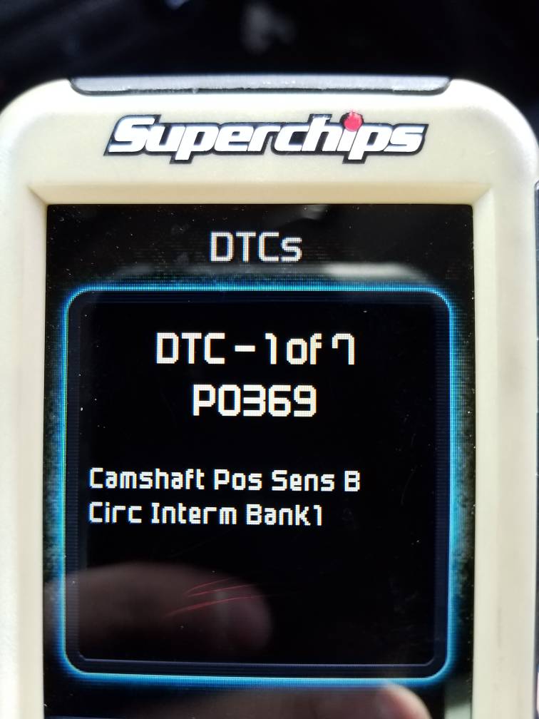

Here's the codes. Came on again today coming back from Martha's Vineyard.
Sent from my SAMSUNG-SM-G891A using Tapatalk
that is bank 1 - passenger side sensor.
check the connector - tight corrosion free ?
your code reader says 7 codes - am wrong? post them BEFORE we can go on.

I just realized this - seeing superchips on code reader -
PLEASE say the jeep does not have any aftermarket BS - reprograms 'tunes' miracle magnets etc
Still wondering about missing codes 1of 7?

No other after market stuff aside from headlights and radio. And those are the other codes. I upgraded to LED's so that's why I have 4 codes for the headlight both low and high beams and the radio one just says lost comm with radio. If I was worried about the other codes I would have posted them. And yes when o took it out I made sure it was right and free of corrosion.

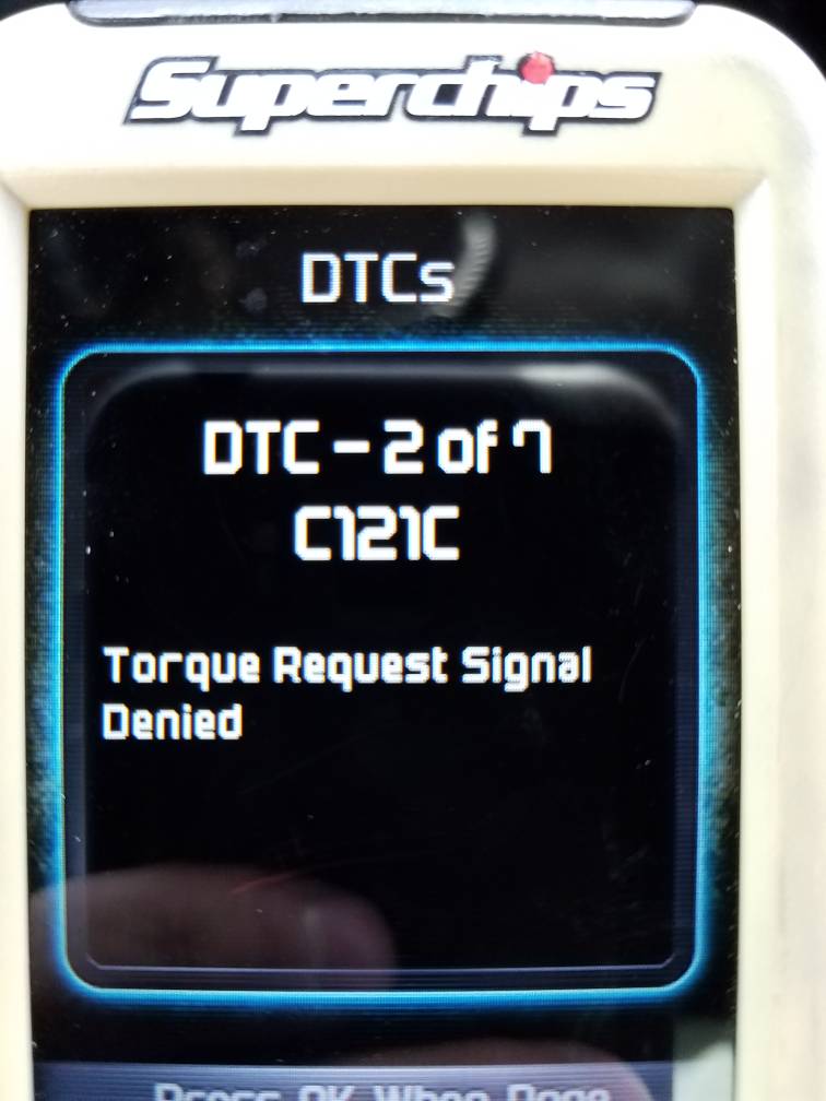

Codes help paint the big picture. The cam sensor issue - The los of signal I think a new sensor was installed ?
There is a strange notation I found in my notes - Try this add a bottle of RISOLONE oil detergent It will eliminate
a possibility easier than checking it out thru inspection. As next would be wiring troubleshooting OHM cheking ec.

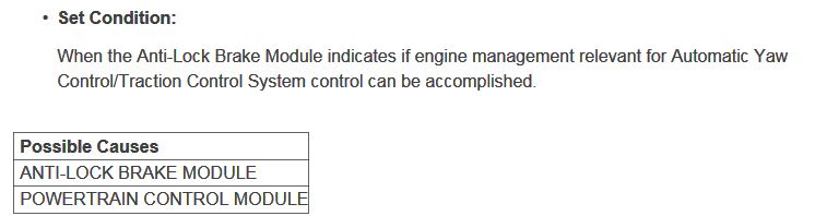

You C code will reqire a scanner our shop snappy is not capable of that jeep diagnostic path - really integrated system YAW input ect - Suspect a dealer only - I would do other codes* as they may affect (ABS) module logic.
*Meaning P and U codes
