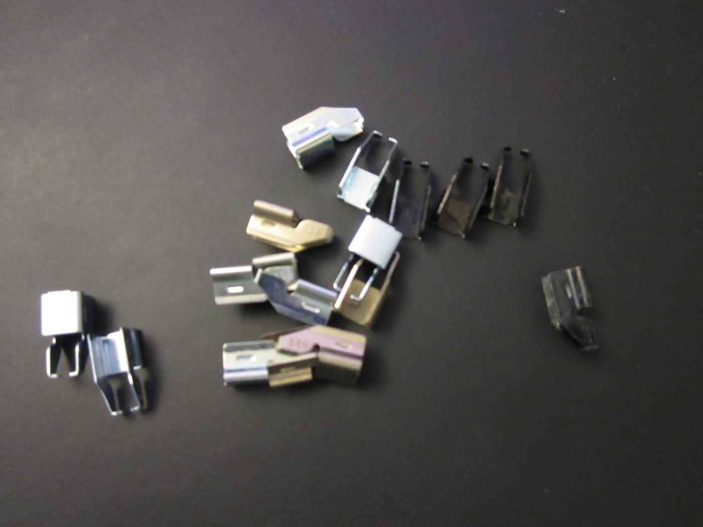

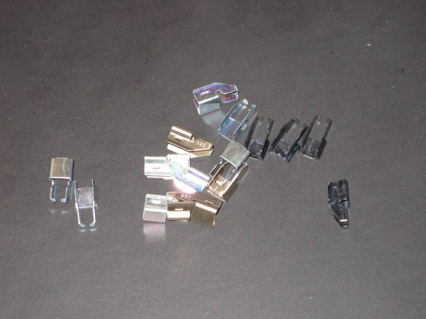

My new brake pads did include some clips to help with the grooves. I'm going to install them tonight (weather permitting)
