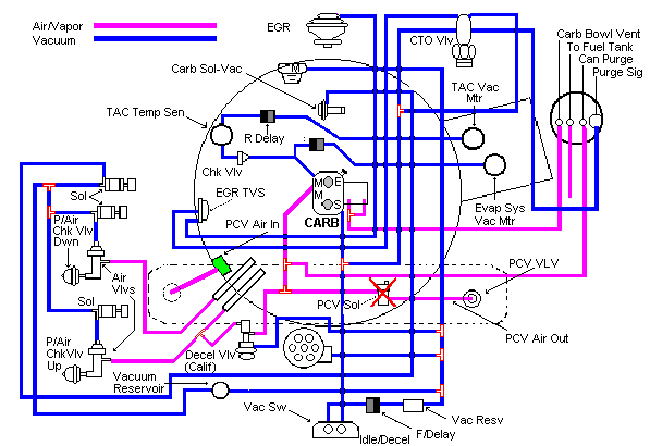

Ok so I just rebuilt my POS Carter 2 bbl and went to hook up vaccuum again and have a port on the back of my carb right below the stepper motor that is open and I cant figure out what goes there?

Rough, unsteady idle problems are all too common with the Carter BBD on the 258 CID engine. This can be caused by several different things, but the most common is a too-rich or too-lean fuel mixture. You can get a clue to which it might be by removing the lid of the air cleaner and looking down at the metering pins. If they are all the way forward, the mixture is too lean. If they are all the way back, it's too rich. This assumes of course that all the other systems are working. If it's too lean, check for air leaks around the carburetor base and the intake manifold gasket. Check all vacuum hoses for cracks, breaks, and leaks. A bunch of little leaks add up to one big one. If the hoses appear cracked and aged on an older engine, it would be worth your while to go to the auto parts store and buy new hose and just replace them all. It's inexpensive and not hard to do. Check the Evaporation Canister for correct operation. It should not be purging at idle.

However I still cant figure out where that port on the back of the carb right below the stepper motor is supposed to go to...anyone?

As the diagram above shows (which is mind numbing to look at), You should have one port going to the PCV tee'd off to the decel valve and upstream AIR tube. The other one should go under the air cleaner to the TAC sender and vac chamber.

Ok I am thankfull for everyones input but as I stated I have three manifold ports not just two.
