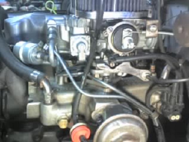

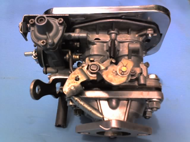

The Weber requires the small cup, like 1-7/8". Most all over the counter kits will have both the large (2-1/8")and small cup included whereas some only have the large cup. Simple and straight forward as mentioned. Here are photos of an install with a homemade bracket attached onto the filter housing.
