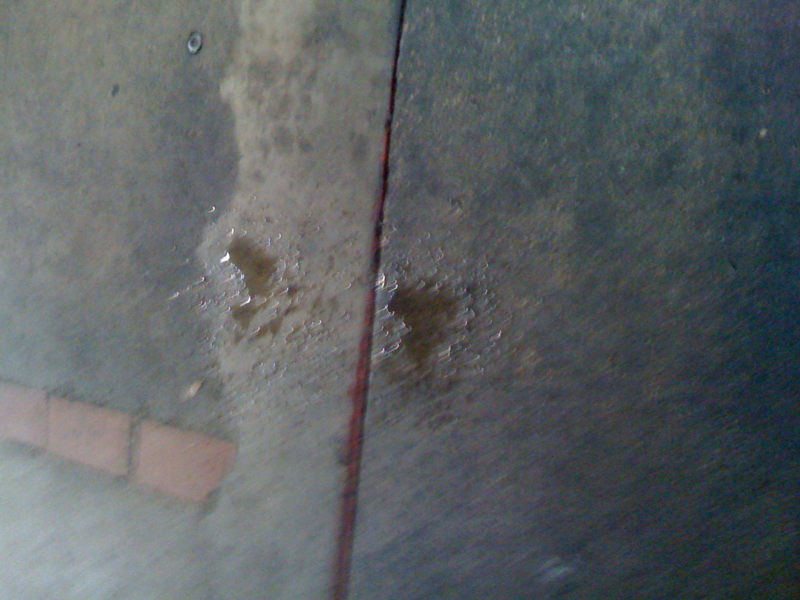

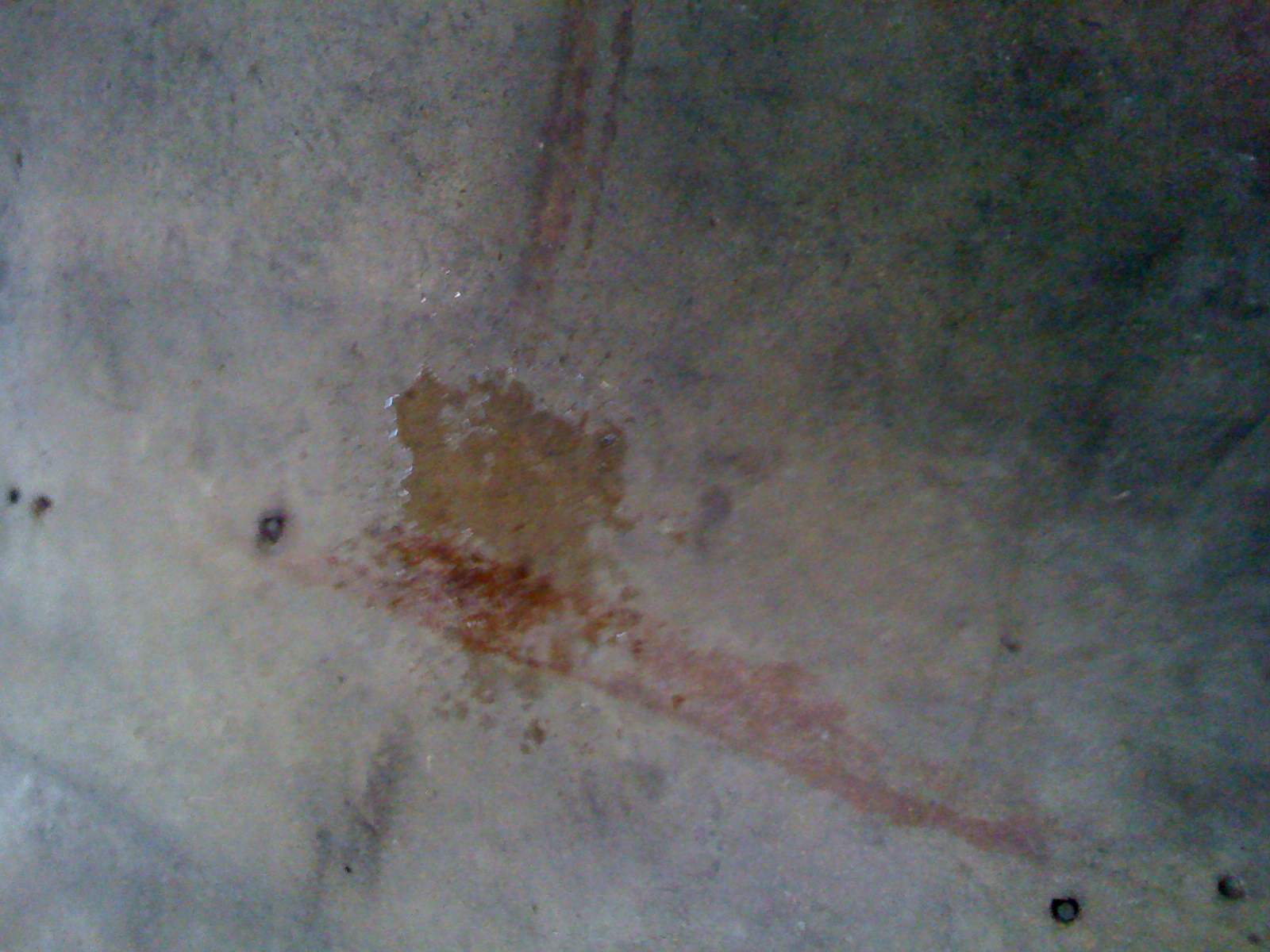

I've taken a picture of a puddle left from an 06 Jeep wrangler unlimited with a 4.0. Iphone's are not the fastest when it comes to sending pictures to an e-mail account so i can show you for comparisson on your part. I'll post it hopefully tonight.
A puddle from just normal engine warm-up condensation?
Nice.. that would be cool so I can compare. I think what I also need to do is dump the mostly distilled water from the cooling system and add straight 50/50 anti-freeze. When it's anti-freeze I can let it pool up in my hand and smell it... that's how I knew it was the cooling system leaking into the exhaust before. Now there's so much water in there it's hard to tell for sure.. I think I can make out the slight glycol smell from the little bit still in the mix though.. kinda discouraging.
These 2 pics. was taken this morning with a 10-12% relative humidity @ a 68 Degree temperature. Idle time for 3 mins. only. the one on the Left side is off the tail pipe and the one on the right is off the Weep hole of the muffler and flange.
