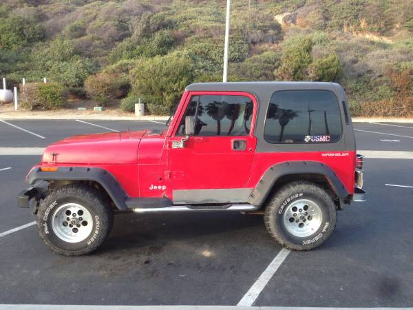

Prior to enlisting into the Marine Corp, i bought a Red 92 YJ wrangler. While in the Marines i put in a 3" skyjack lift, 1 in body lift. all done at the Off Road Warehouse. Ran 31' Super swampers...lowered the gear ratio... only bad thing was that it was a 4 cyl. Fast forward...sold the jeep in 2000 because i needed the money...regretted ever since!

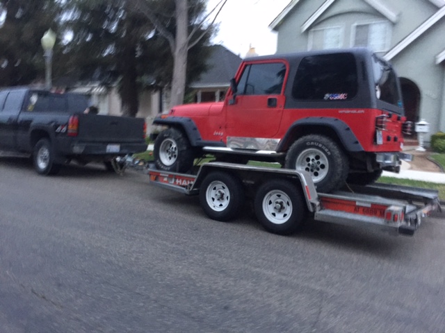

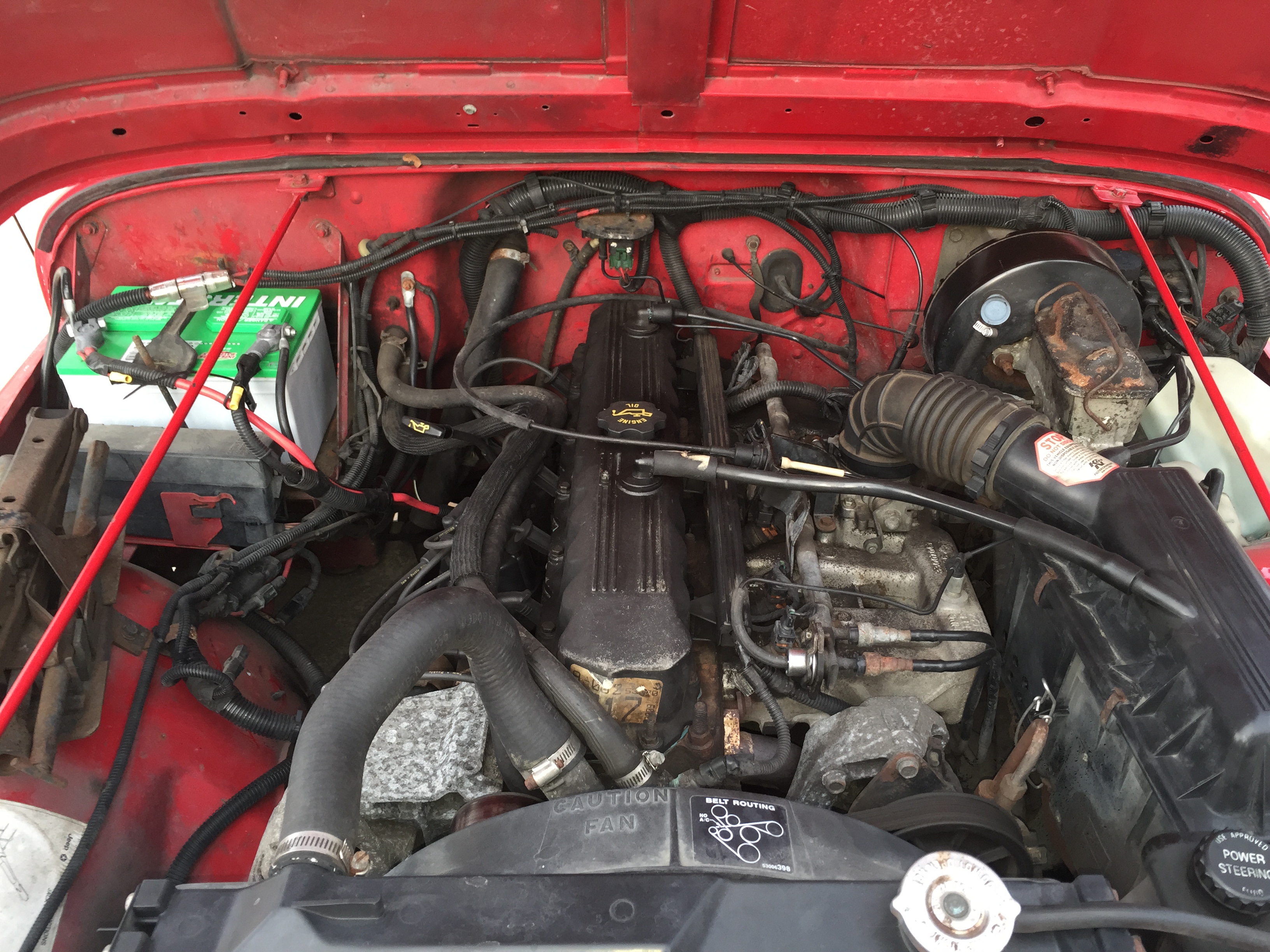

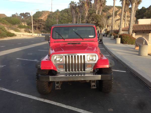

May 2015, after years of searching...I found and bought this one from a fellow Marine about to deploy: Red 92 Jeep Wrangler YJ, 4.0 Inline 6.

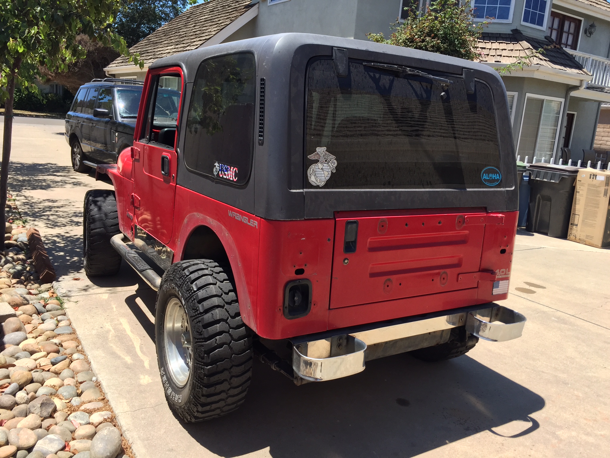

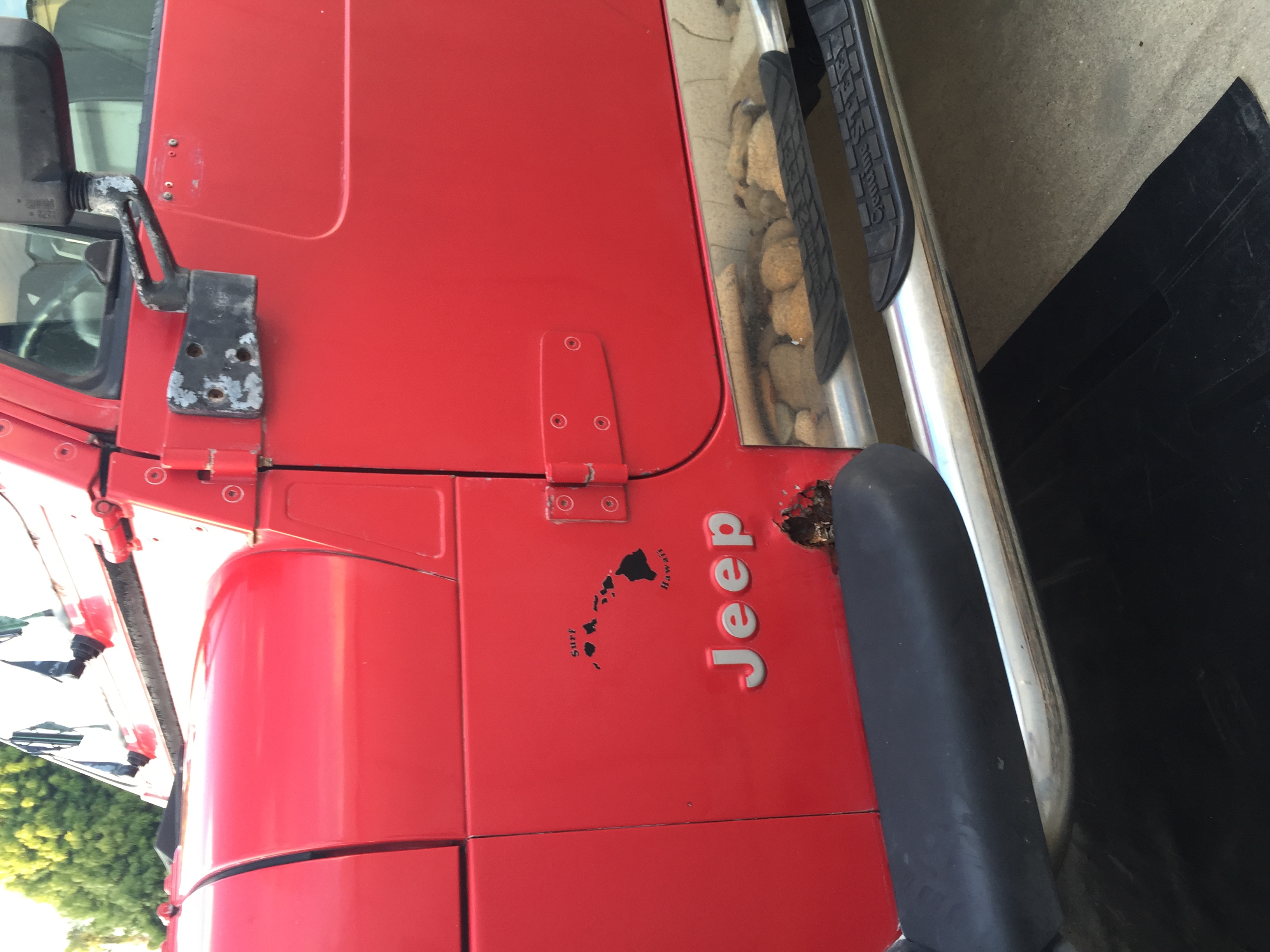

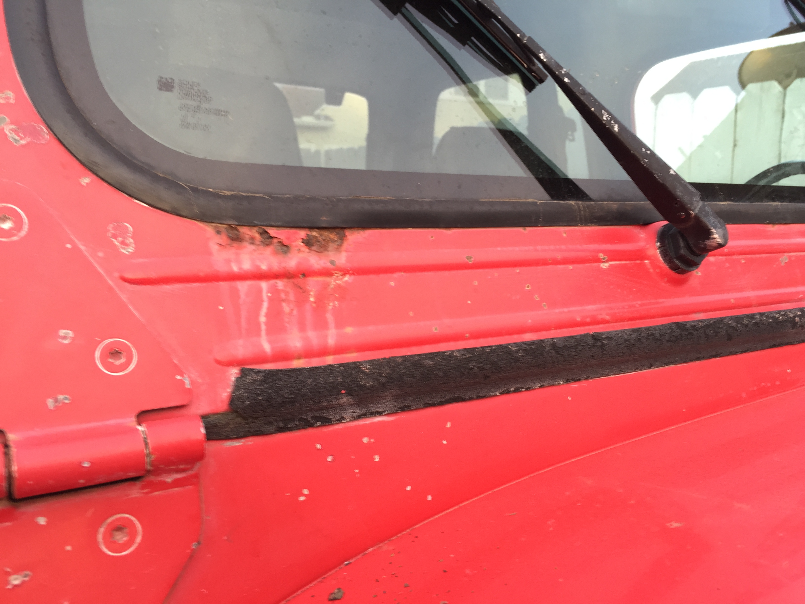

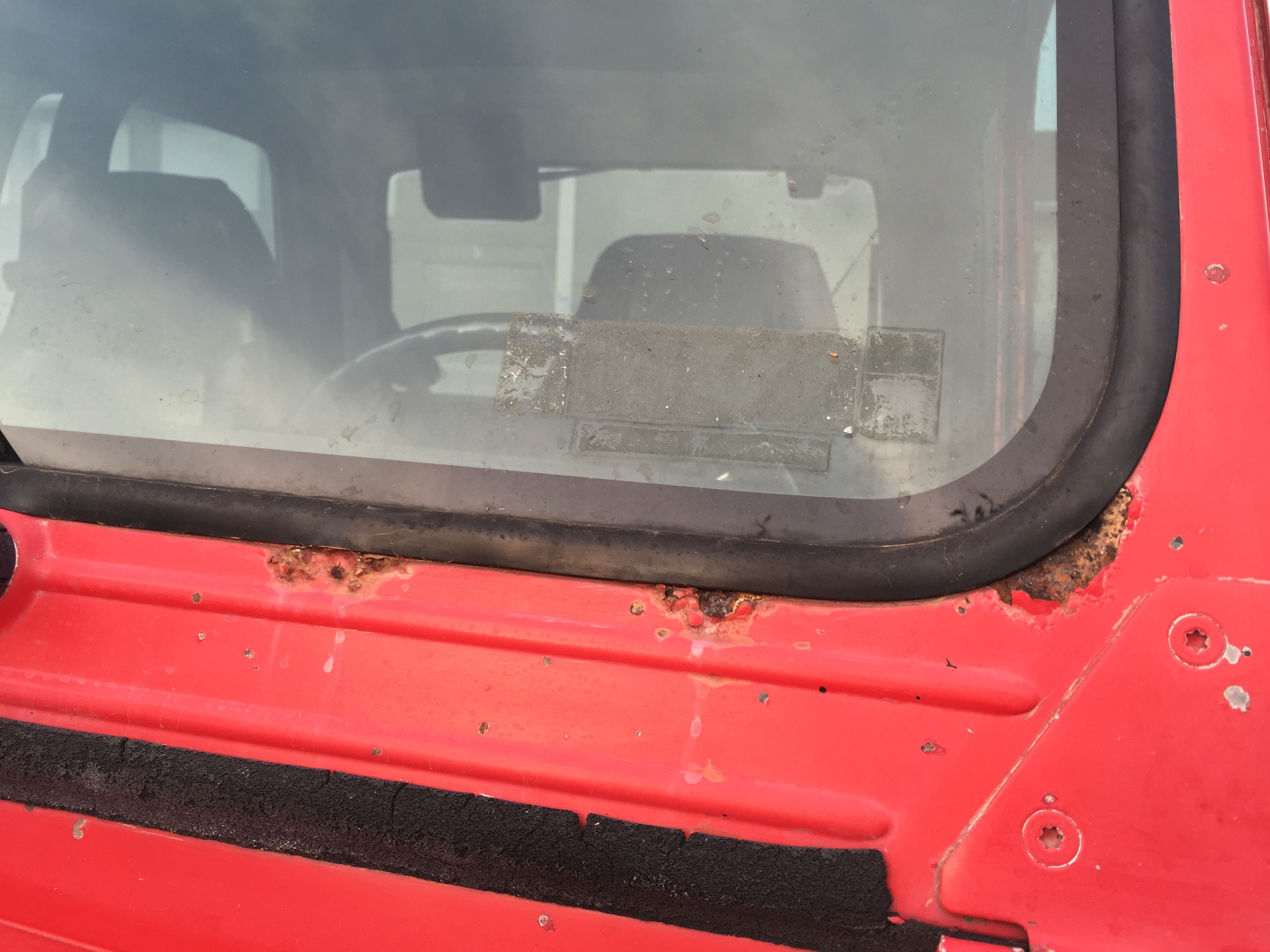

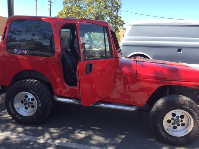

It's a fixer upper: Has rust around the windshield / Rust on the rear left side frame / Rust on the driver side Quarter panel. lastly, all the mirror / hood latches, everything that is black or chrome needs to be replace. Jeep has been sitting in storage and exposed to the elements while the Marine was on deployment so the jeep also needs paint.
IMG_4355.JPG483637DC-0B08-42FB-9124-57EDC0E805B6.JPG2641ADF1-2A82-4F98-83CB-8B4EB5B2E1B3.JPG39901900-FA76-4C44-9561-2947AFCFB3E7.JPG
The plan and work in progress..Started n June.

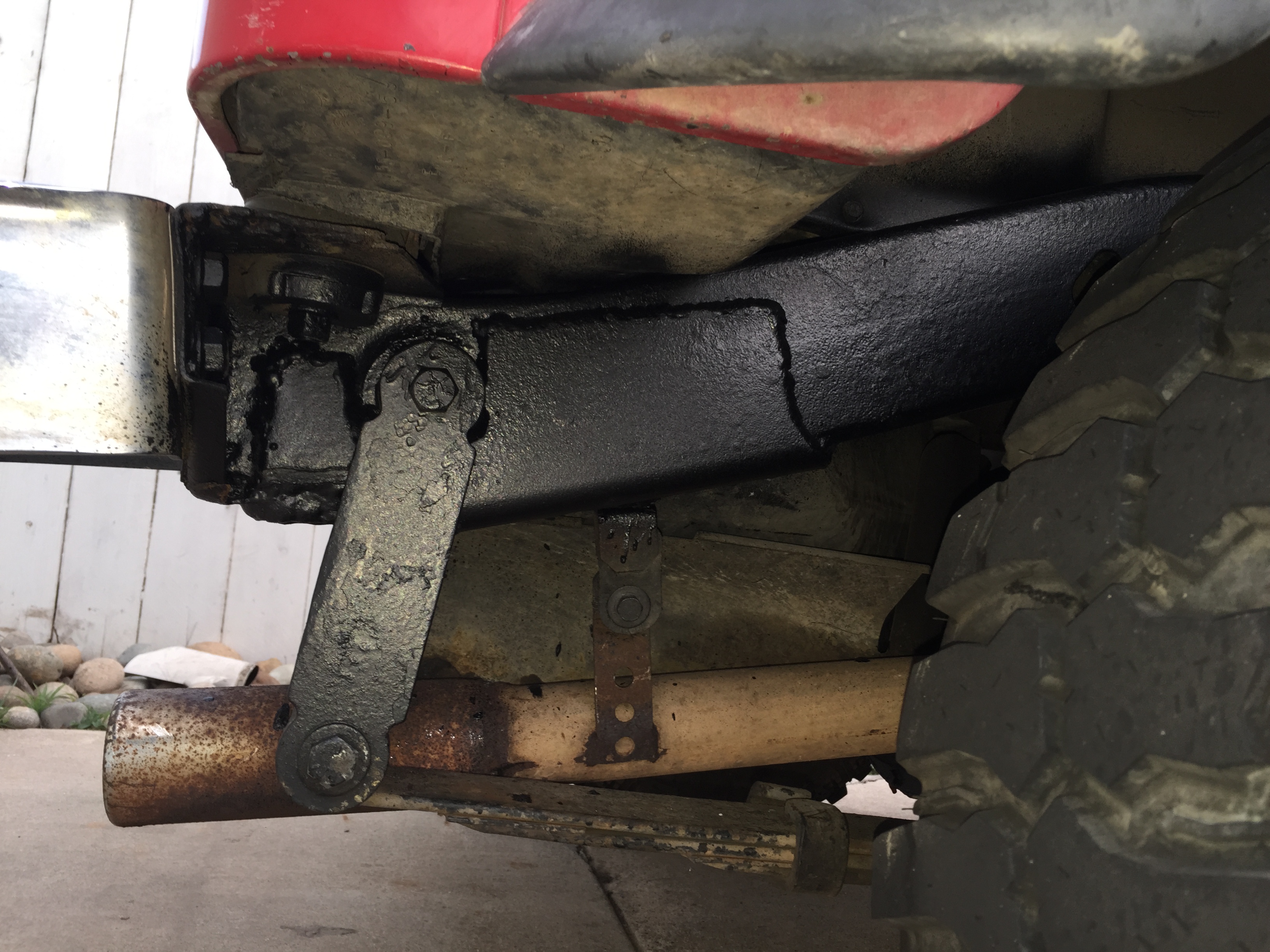

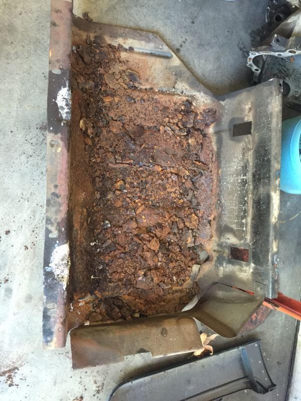

Repair Rust on the rear Frame (cut and weld new metal)

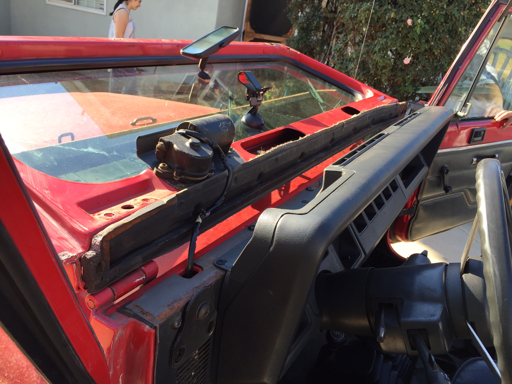

Replace wind shield frame
Replace quarter panel with new one

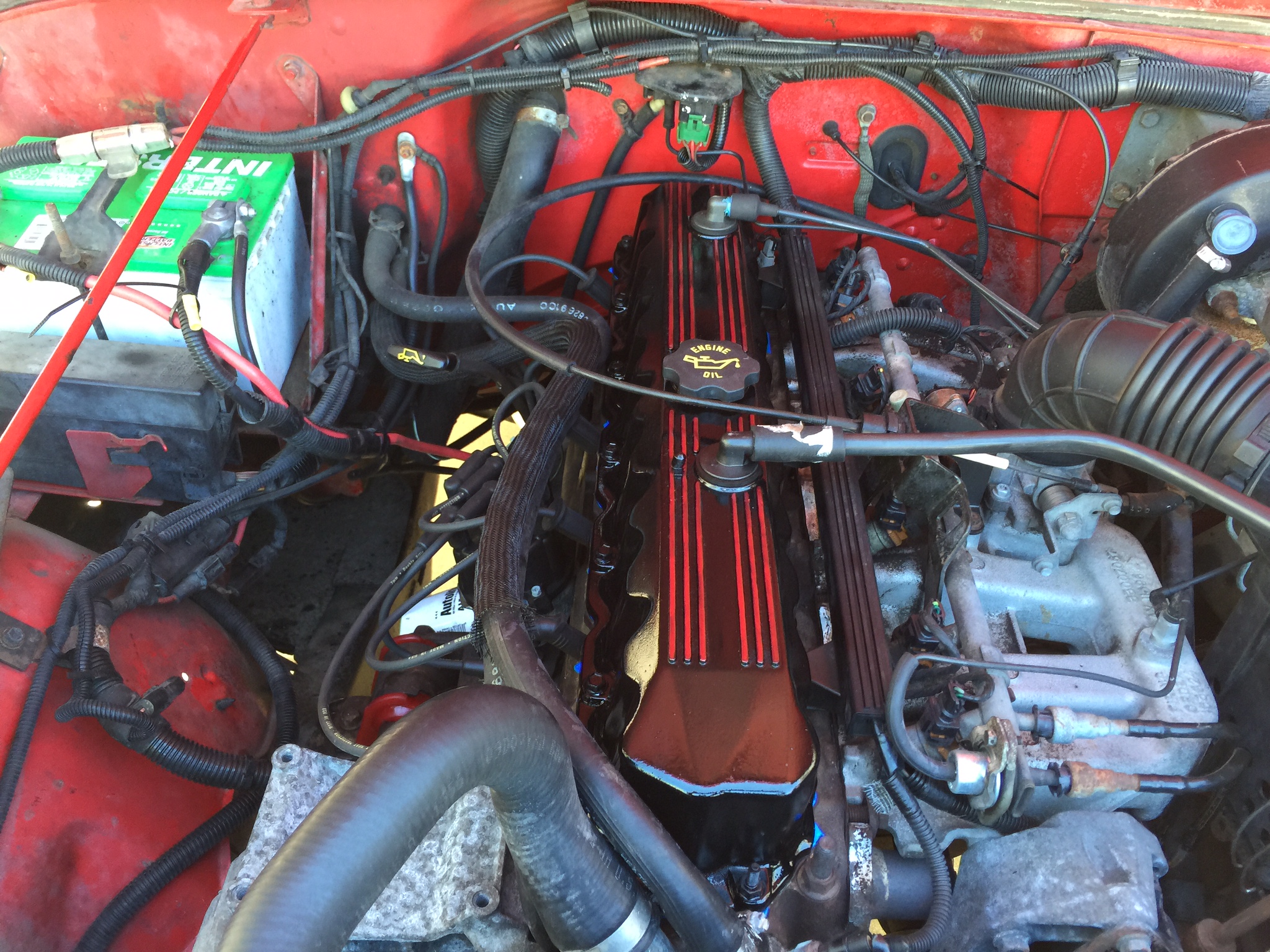

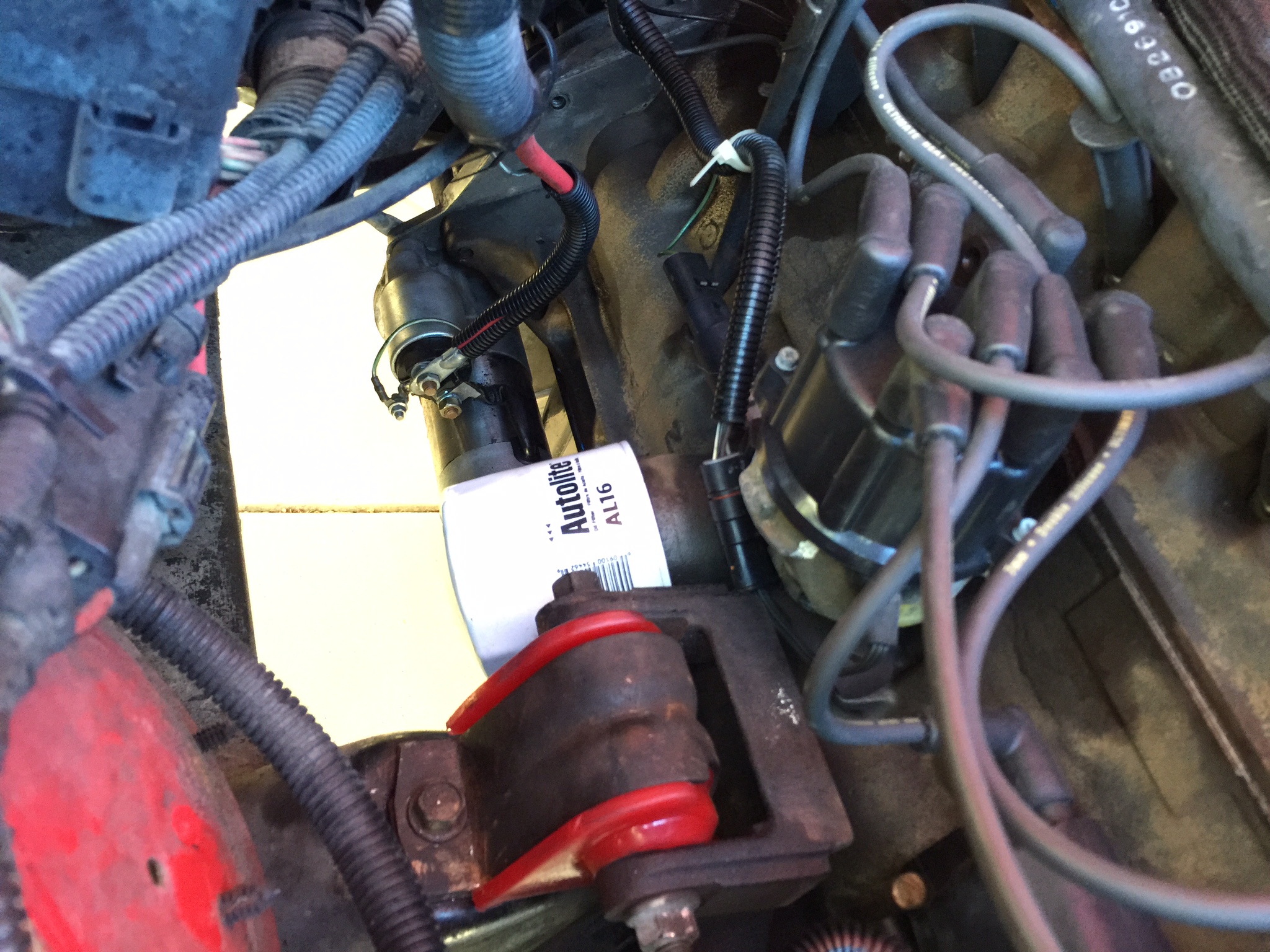

Engine tune up and cleaning and new motor mounts

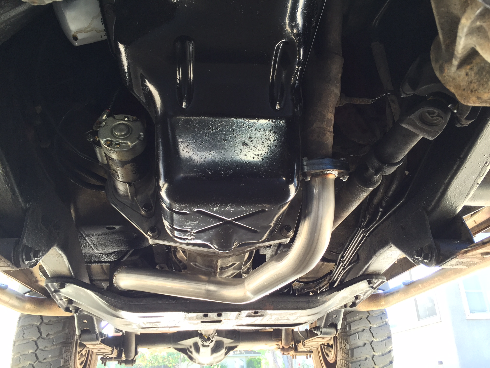

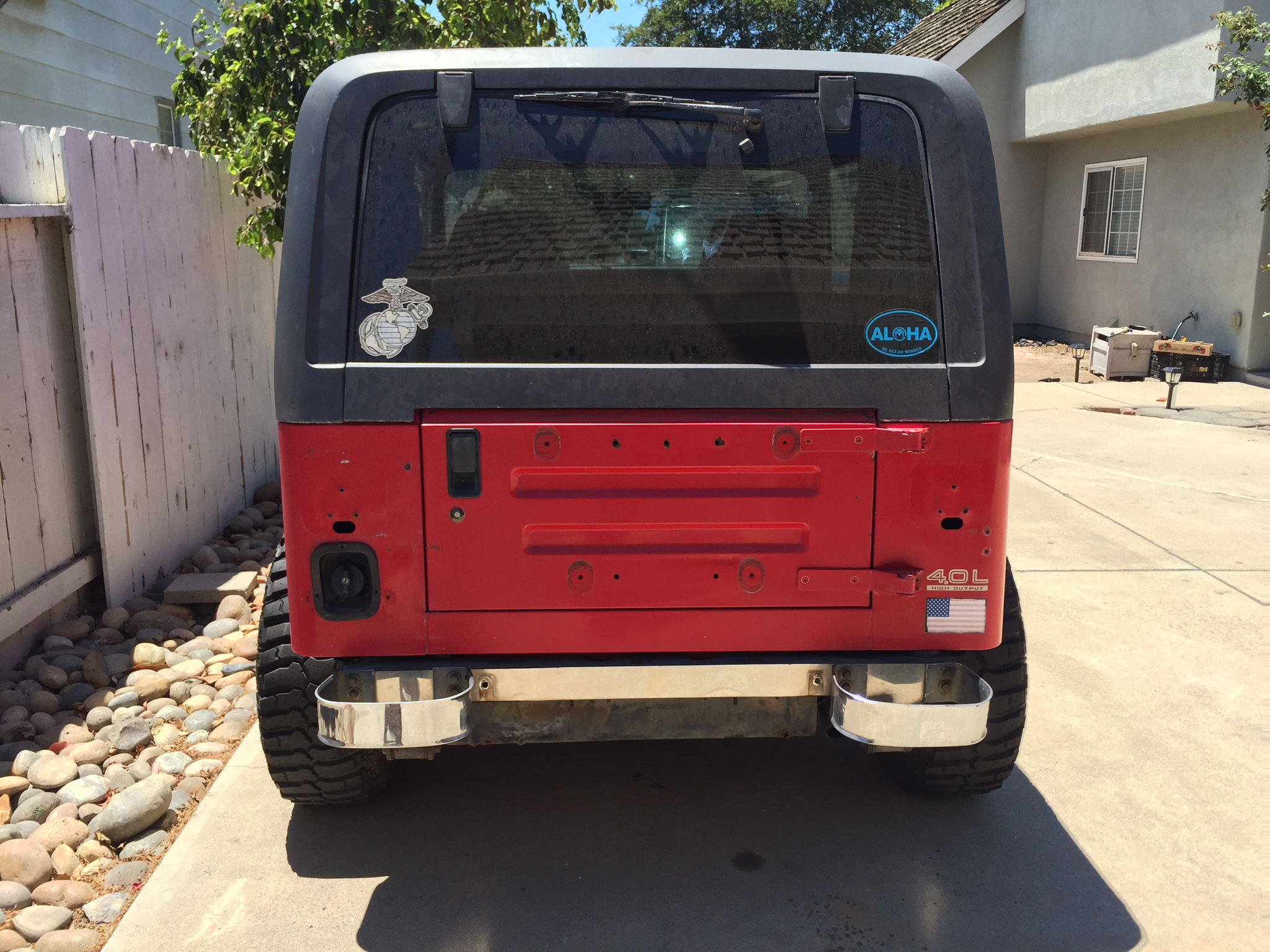

Replaced Muffler

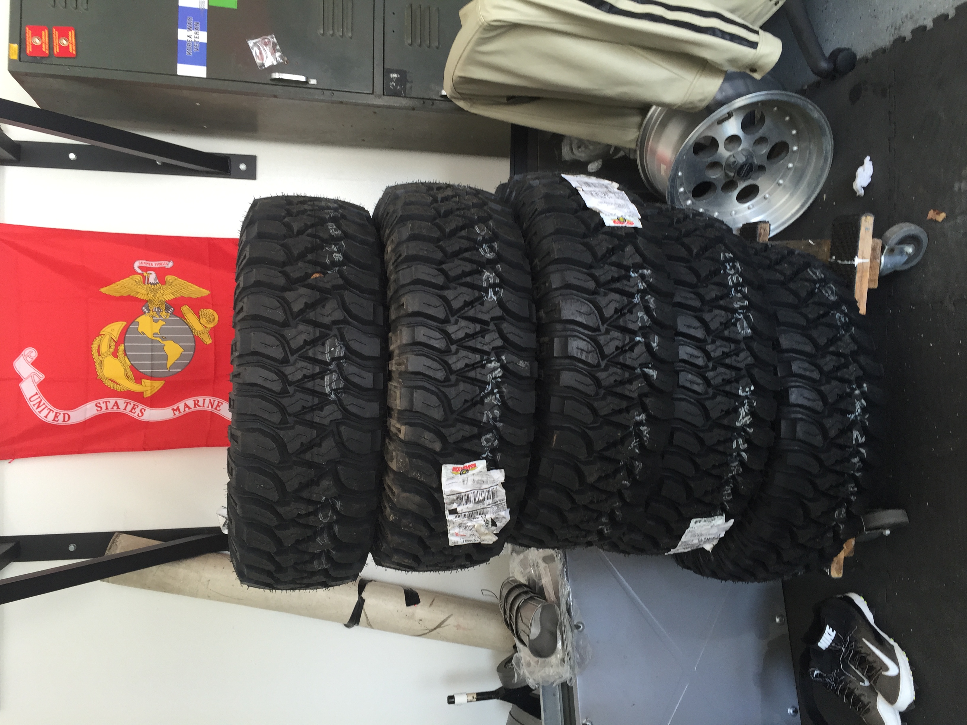

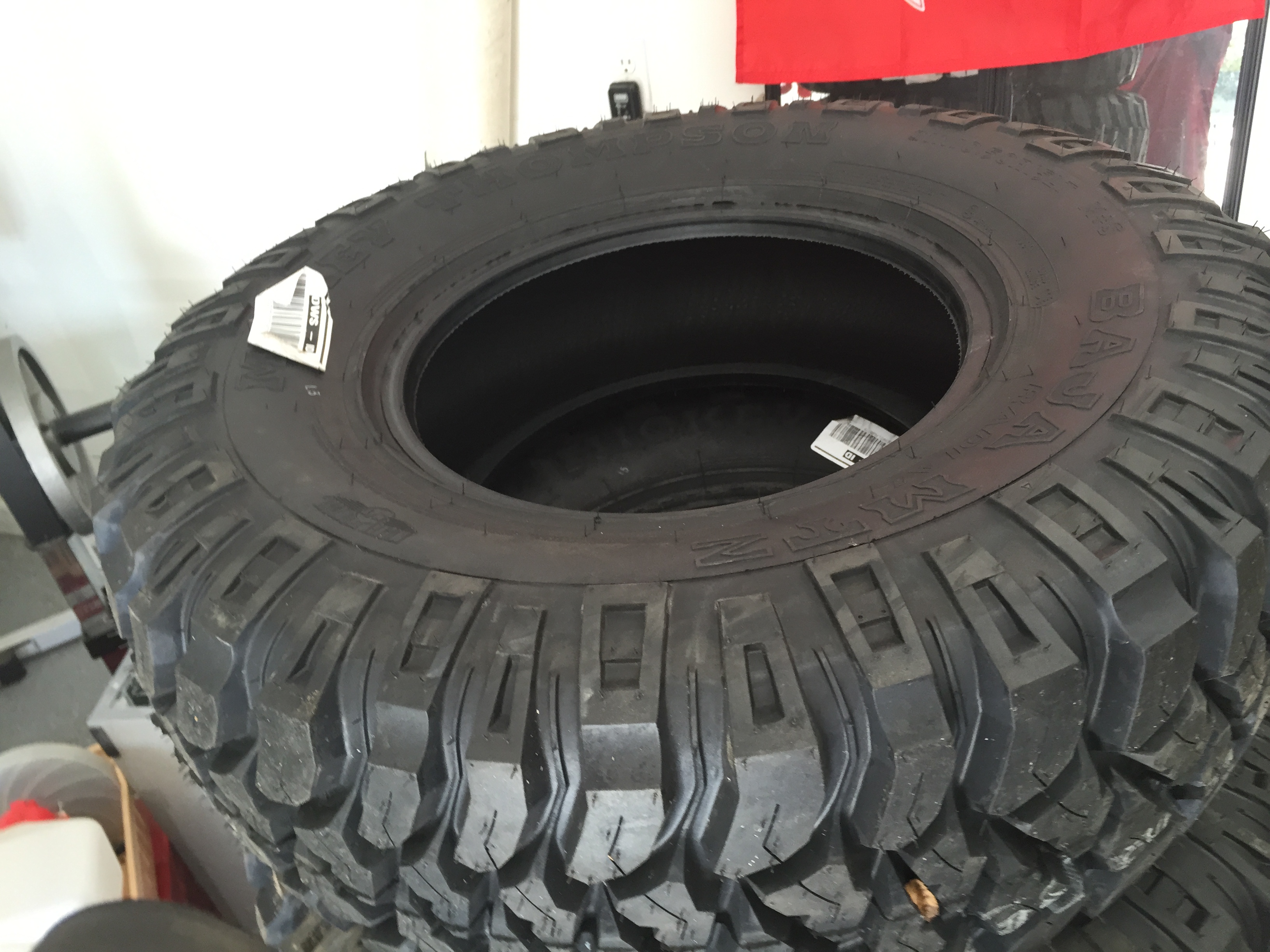

31' Mickey Thompsons tires (5) (arrived last week 7/3/15)
Dick Cepek Black outs 5 Wheels (Arrived 1 week before the tires)

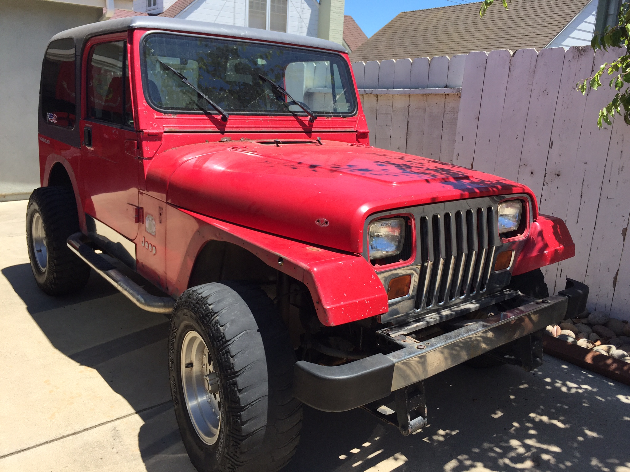

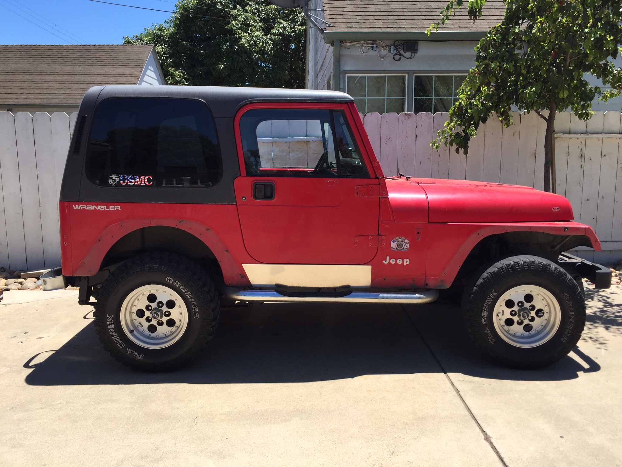

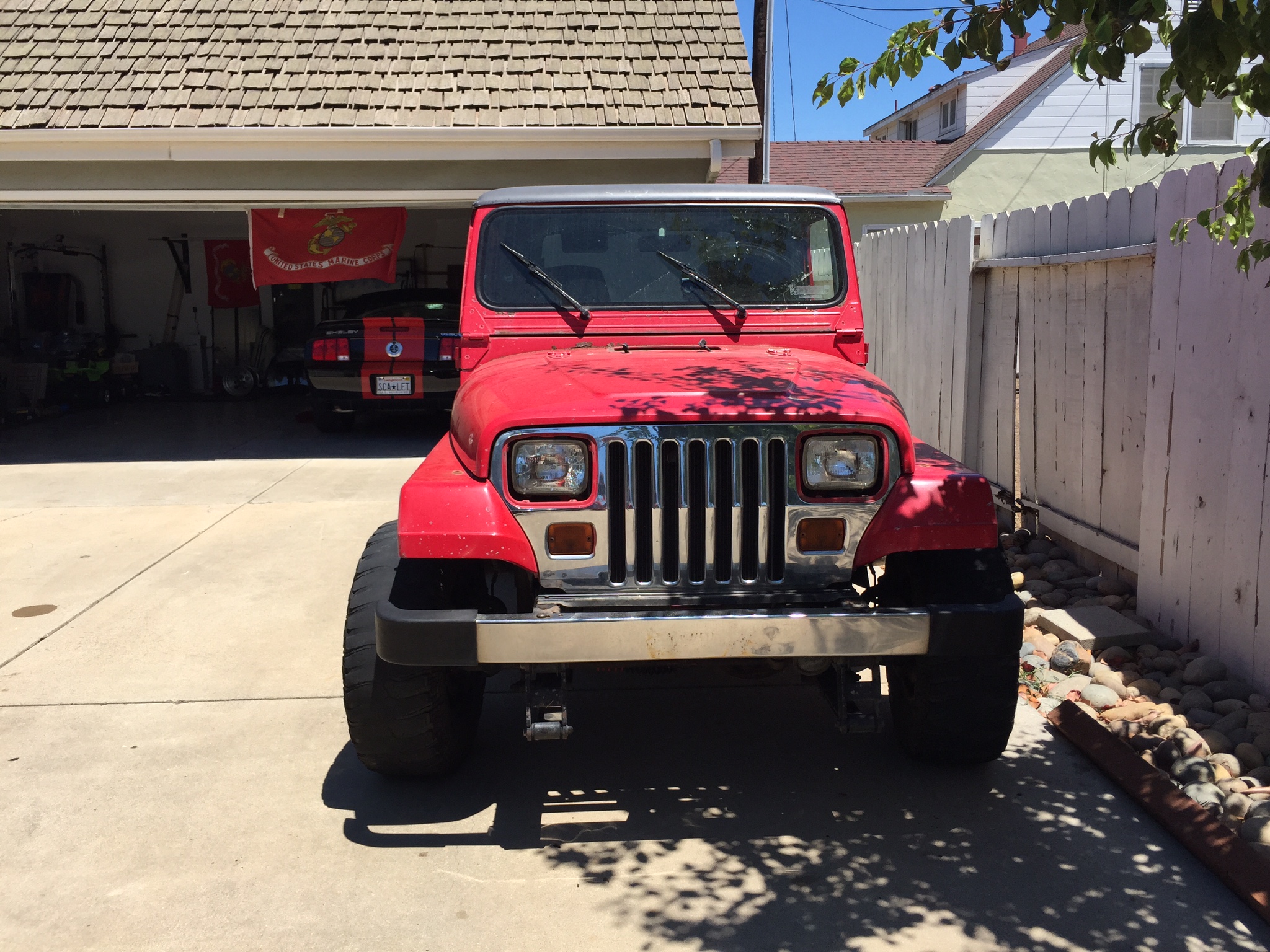

Friday (before 4th of july) i stripped the jeep and going in for paint and body work. Painting it RED. Here is what the jeep looked like as of Friday 7/3/15

The only problems i ran into is that there is more Rust than i expected (which i will fix) and the screws were rusted (which i will also replace).

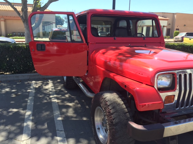

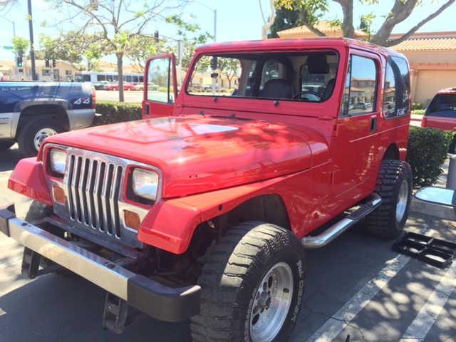

Here are some work in progress pics. Currently at the body/paint shop..installed new steel windshield Frame, new quarter panel which was rusted out. Should be ready Tuesday. Now on to Next Phase: not sure whether to put the tires on first before the lift or after...Any suggestions?
Looking good!

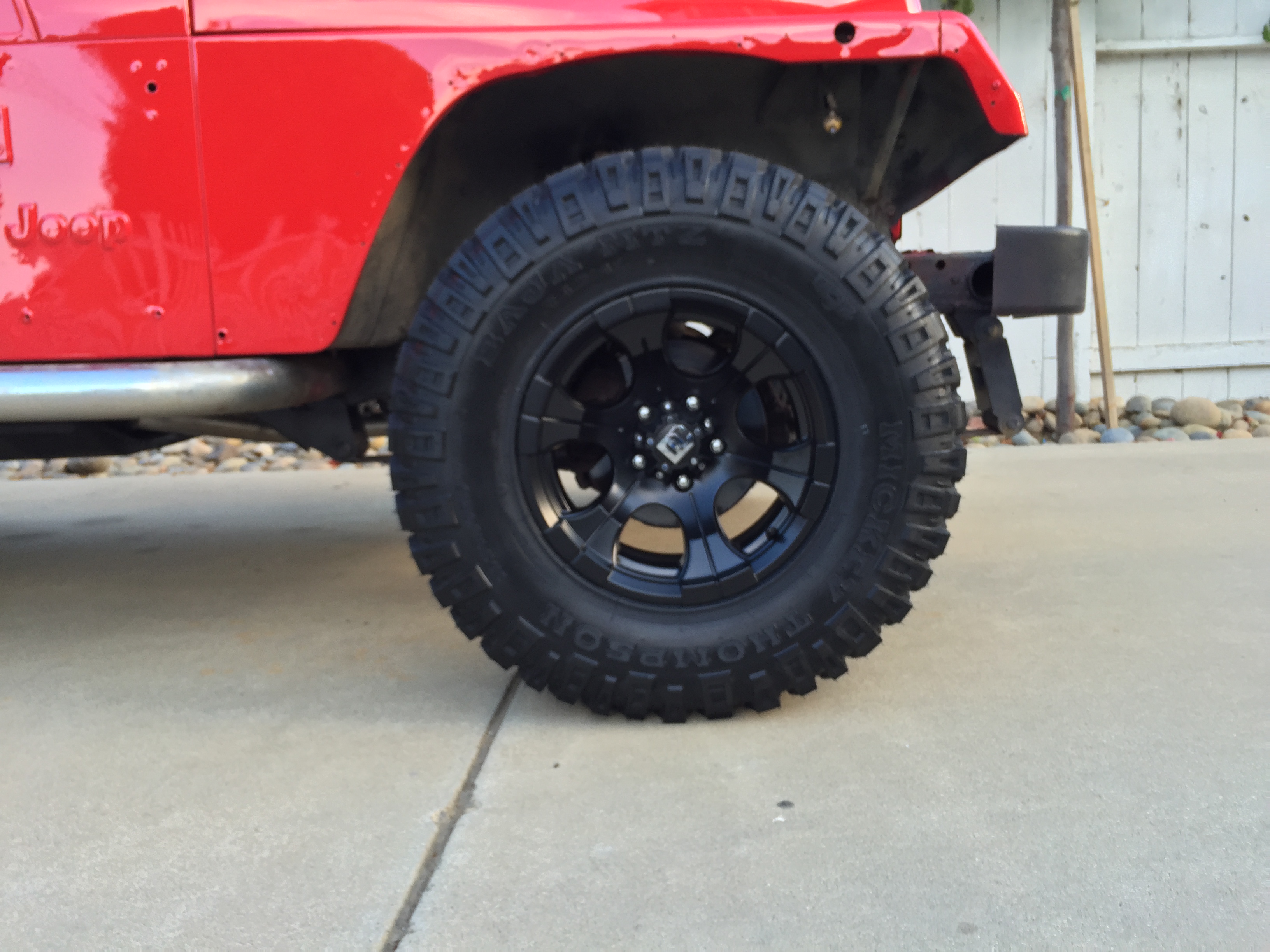

Update: 7/11/15.. Just got back from body shop and went directly to get the wheels put on. Dick Cepek wheels and Mickey Thompsons 31s. Currently getting lift kit. Should have back tomorrow (Thursday).

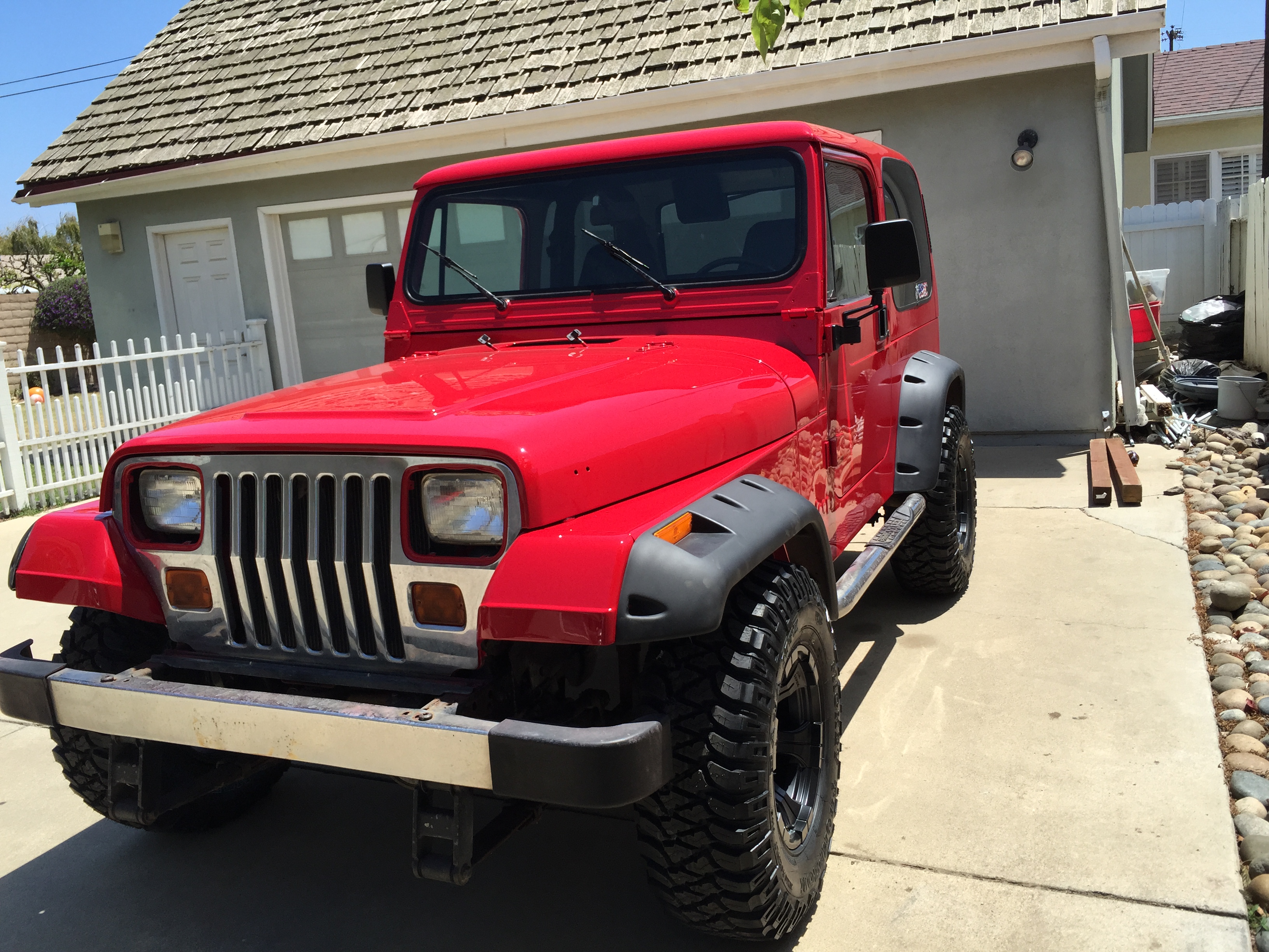

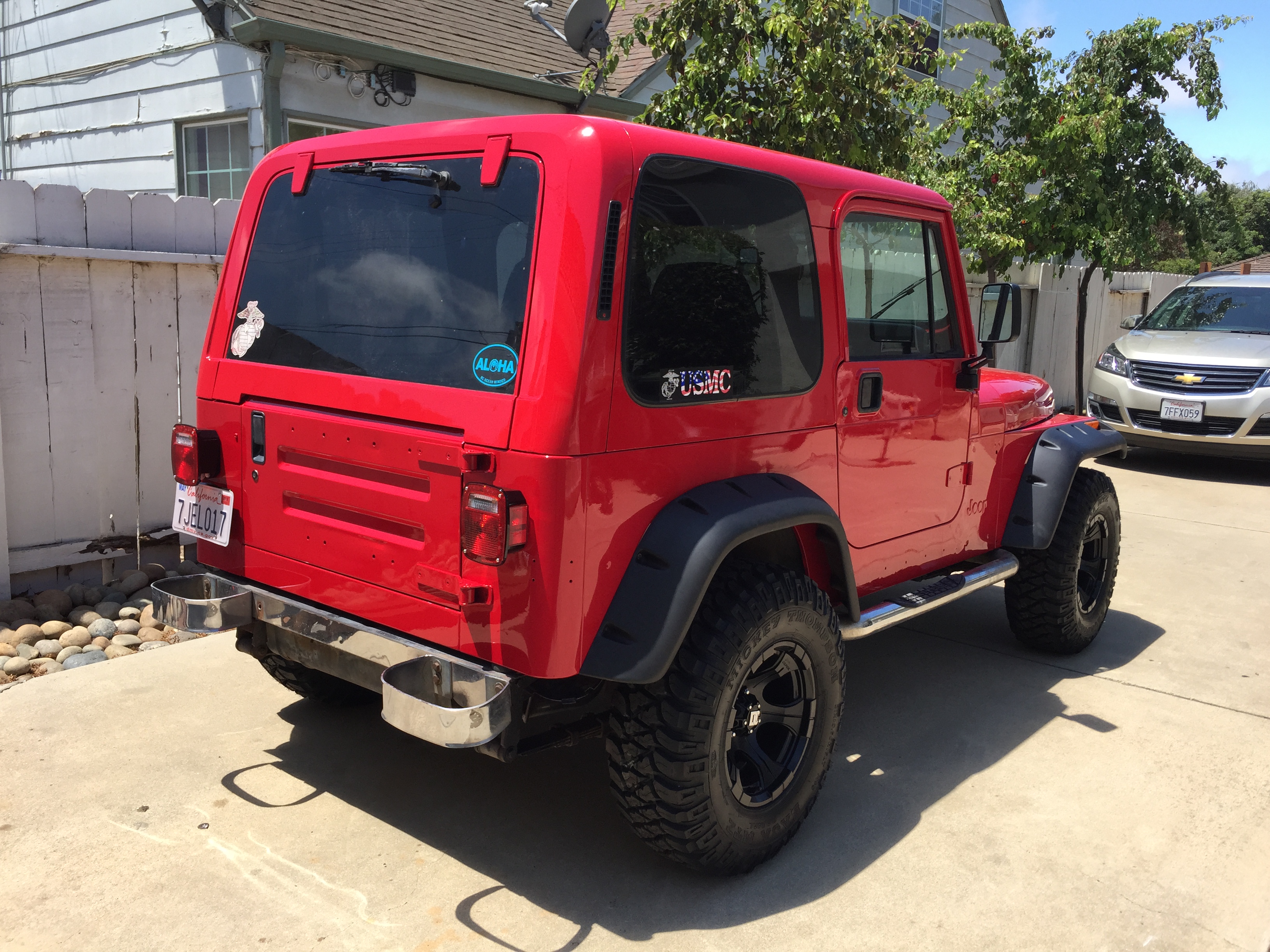

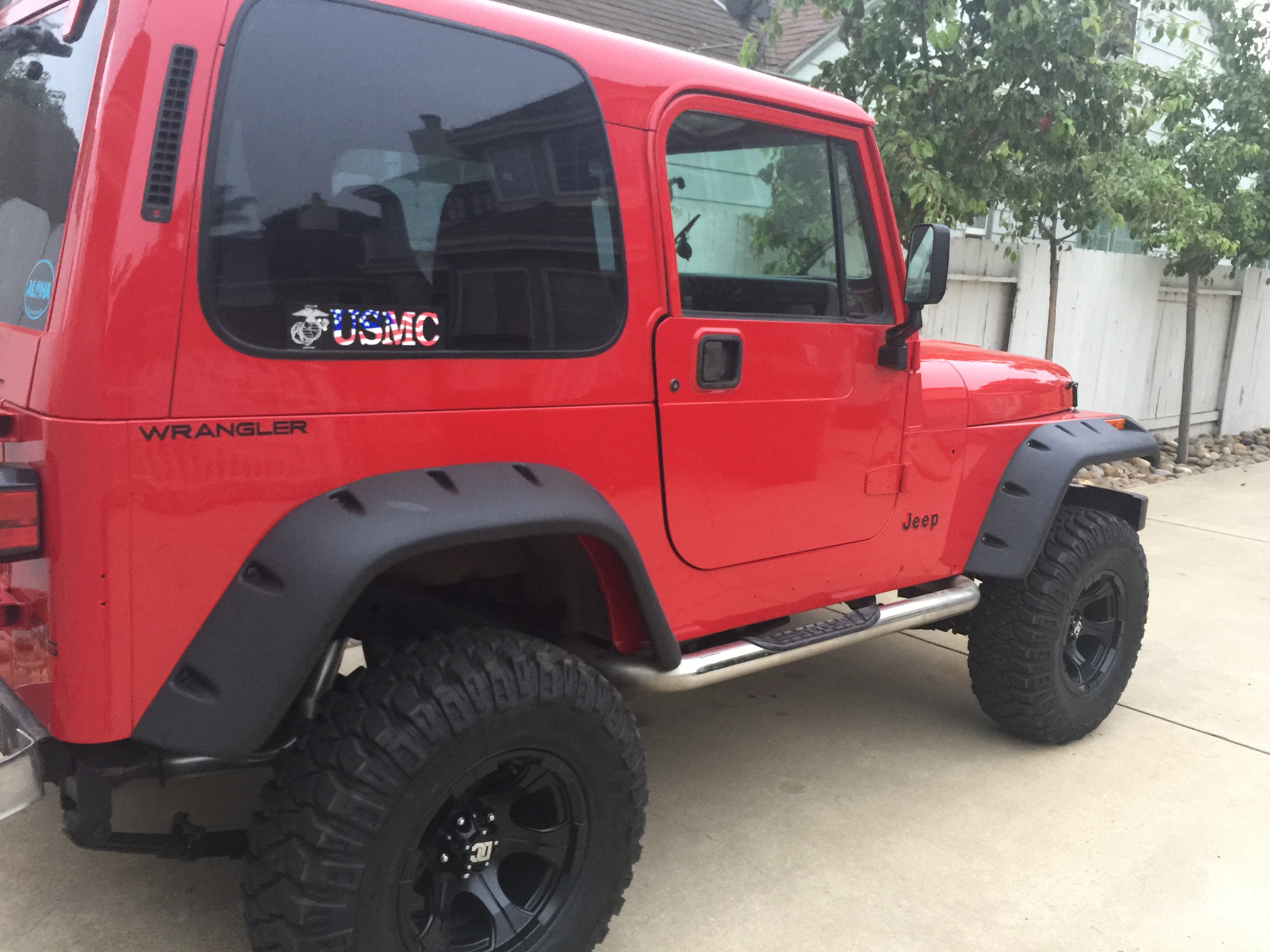

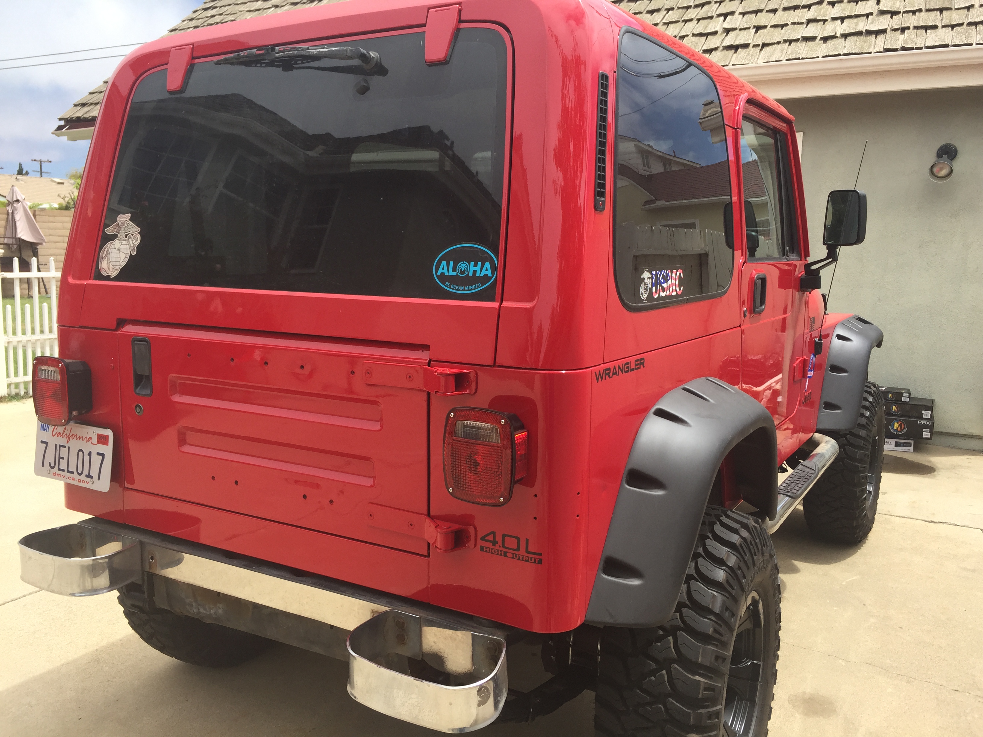

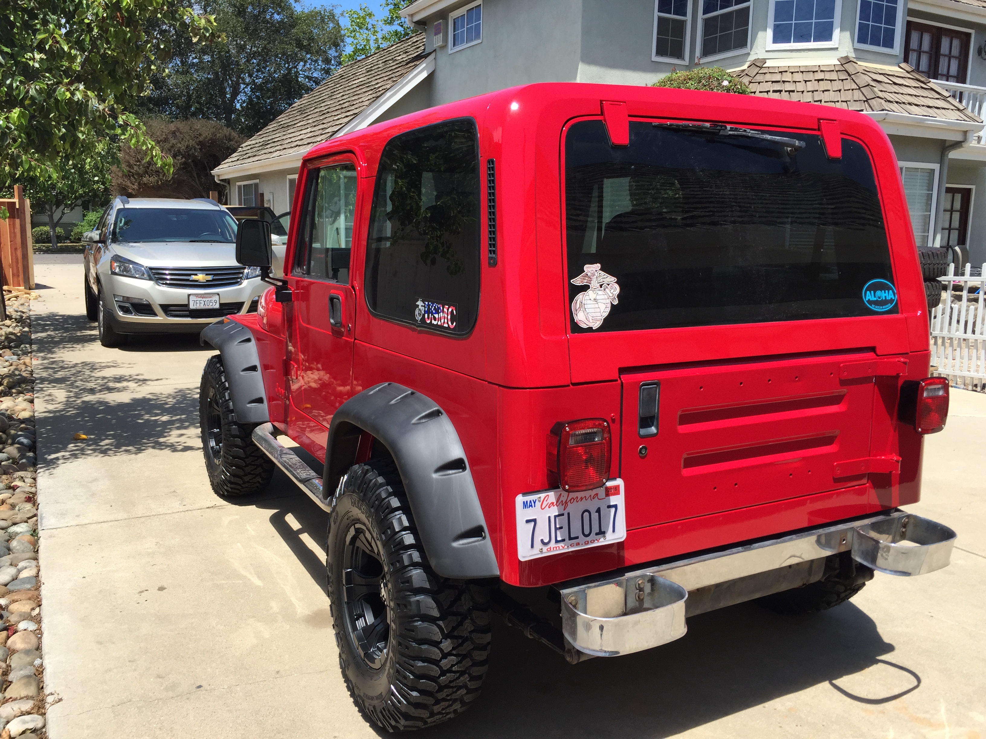

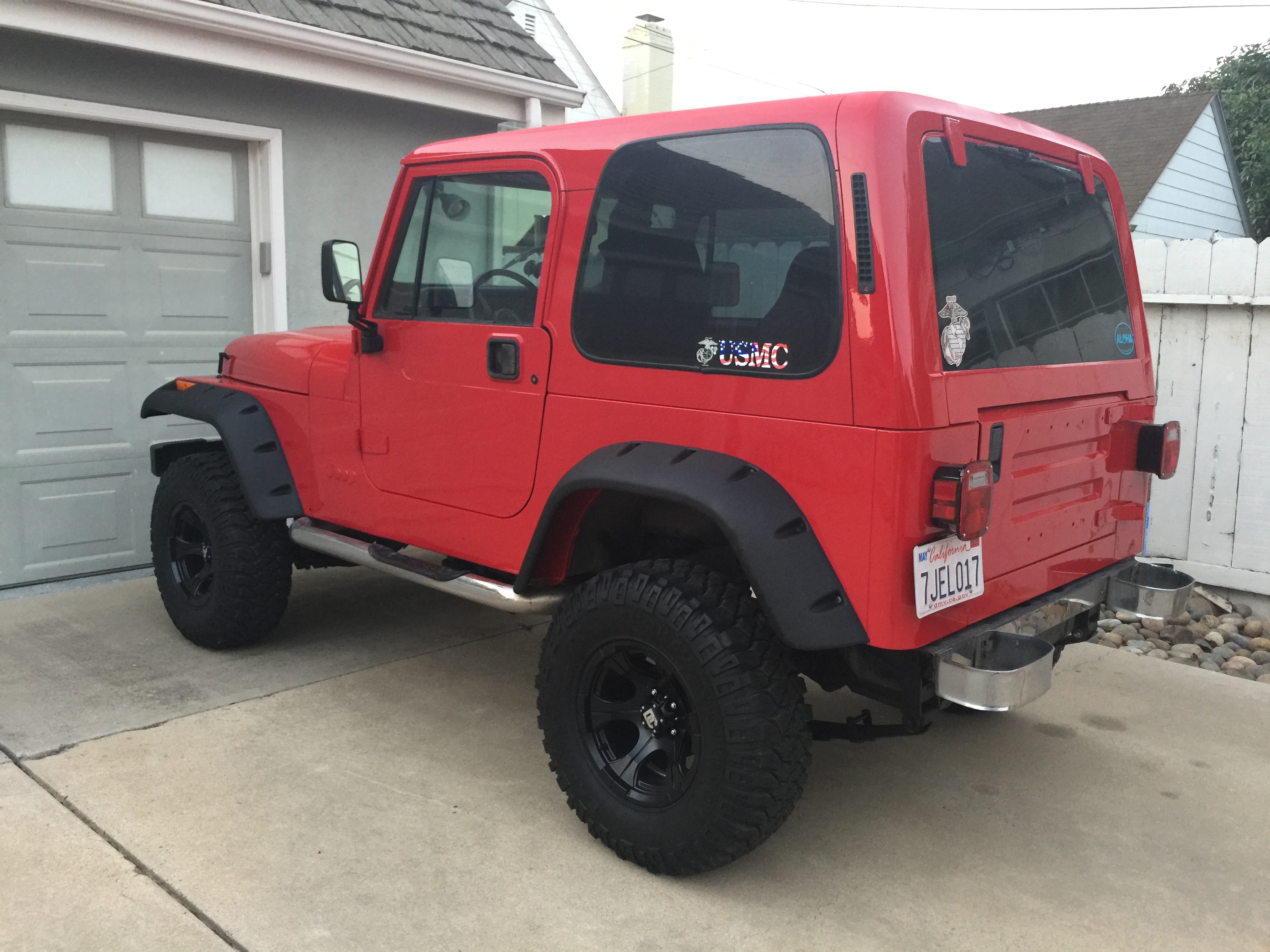

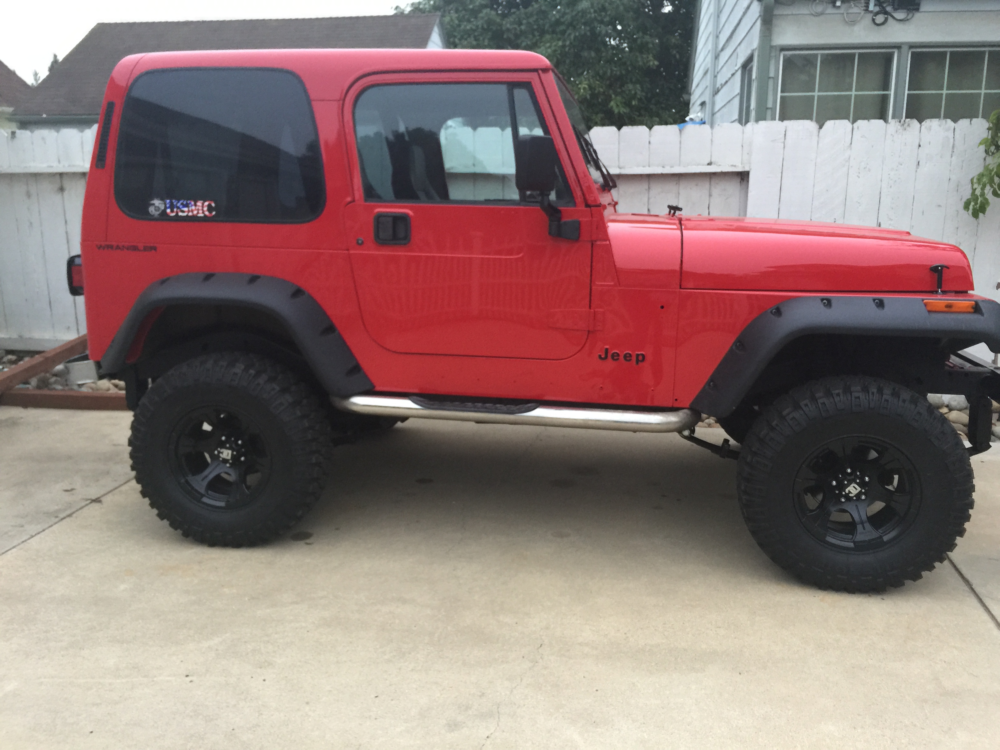

July 23, 2015

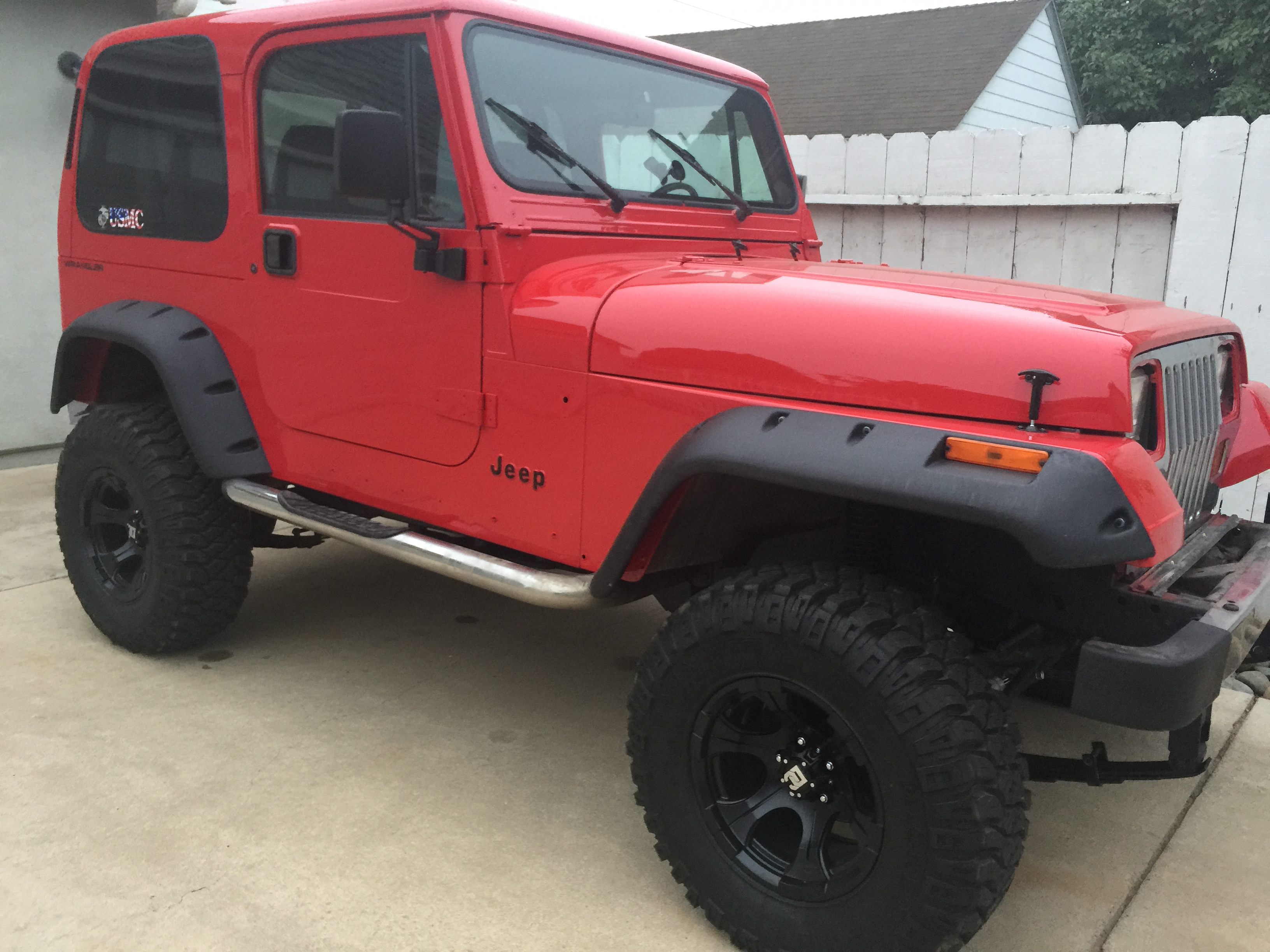

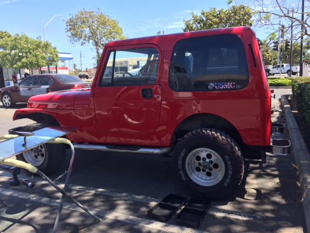

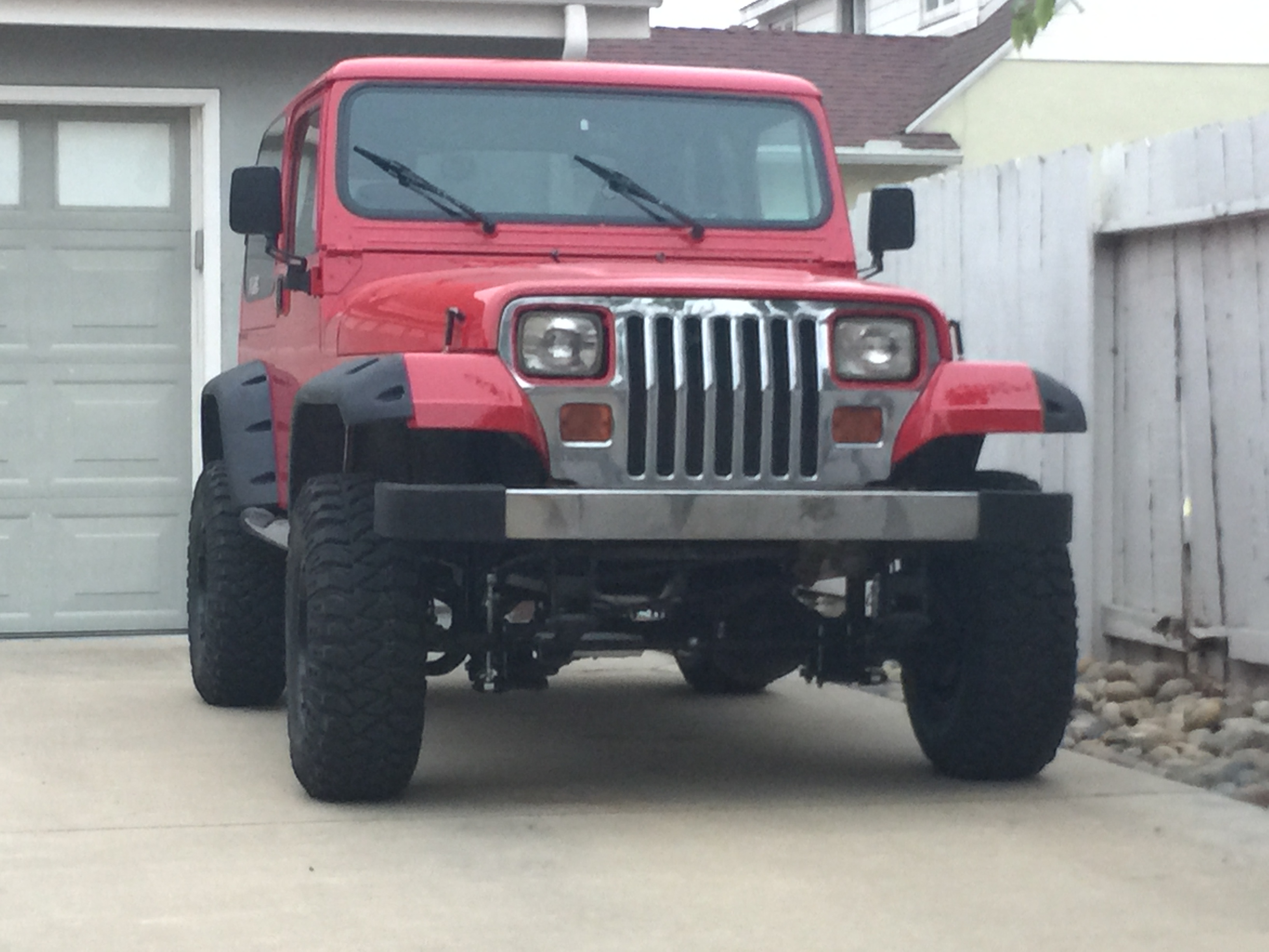

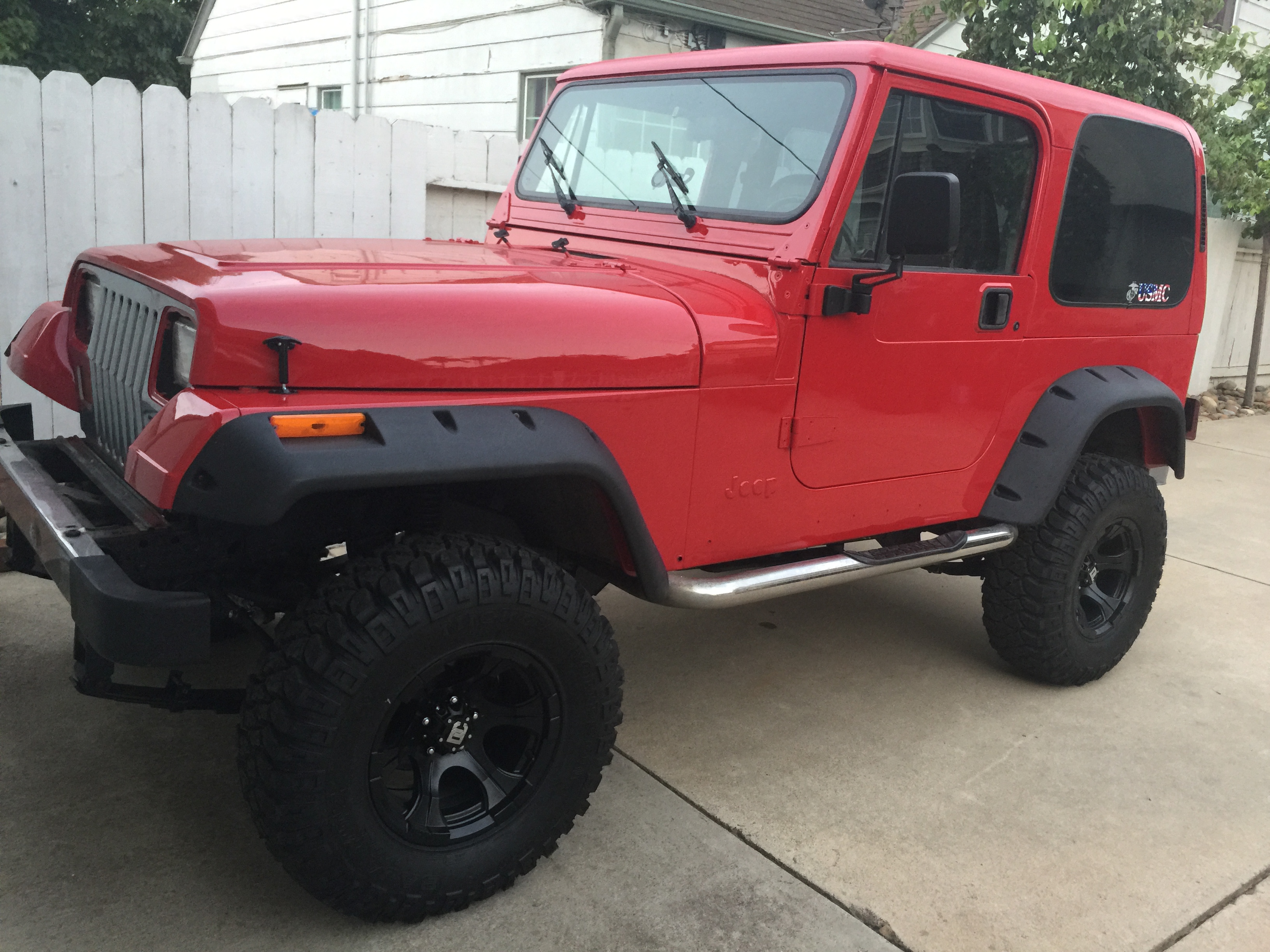

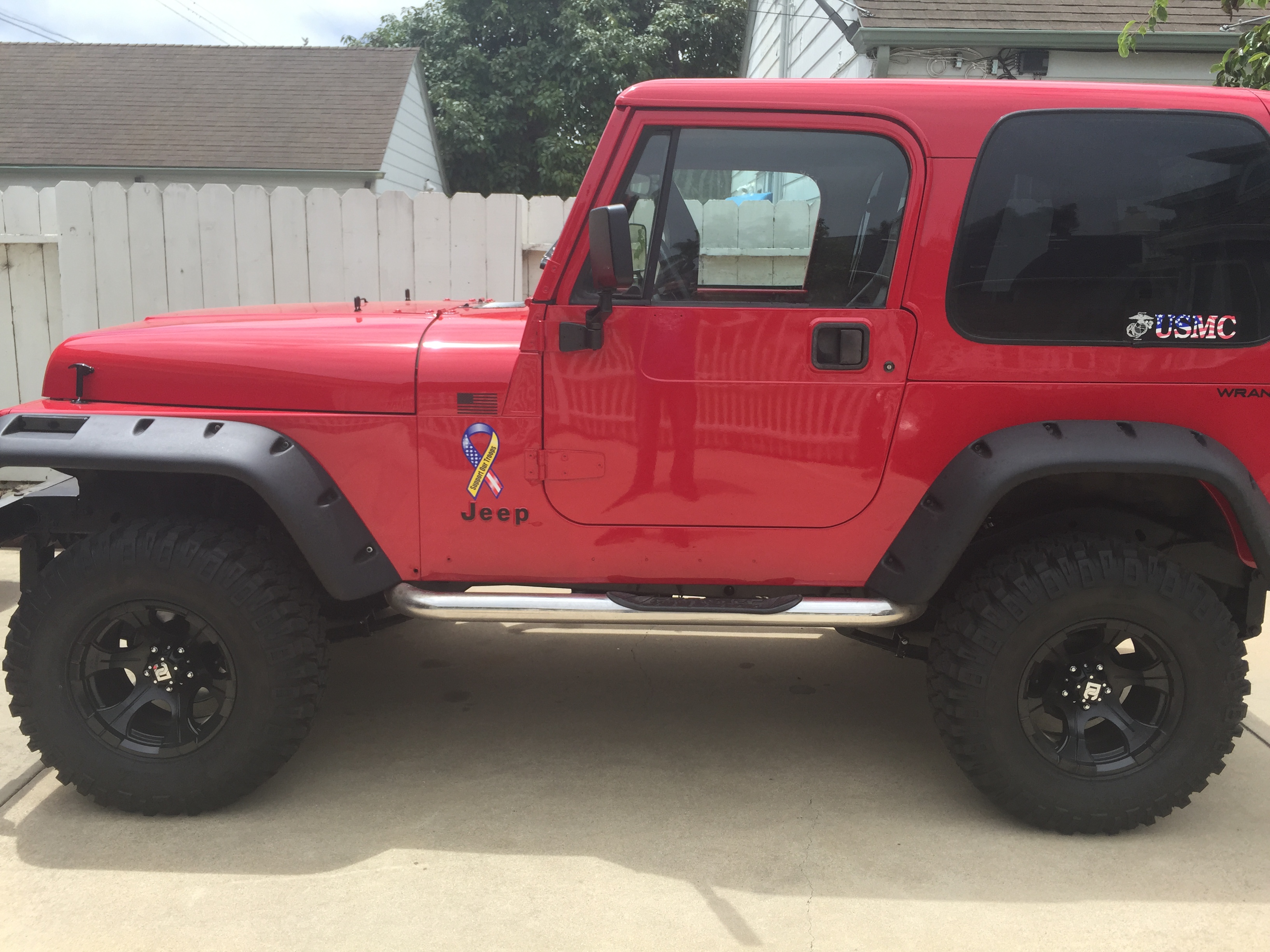

Got it back Monday 7/20... 2.5" Rubicon lift. It drives a lot better. Smoother than it was before. Very happy.

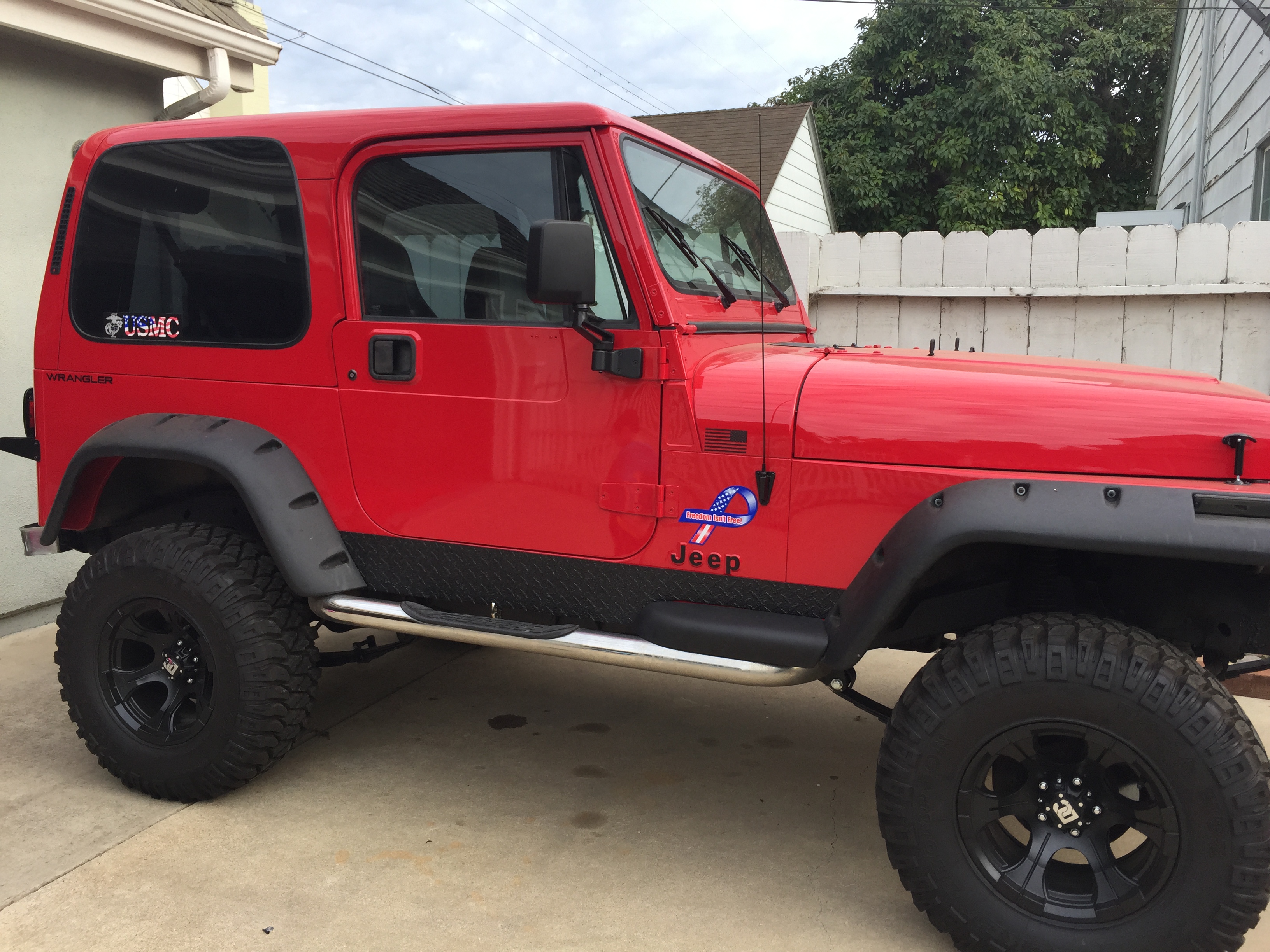

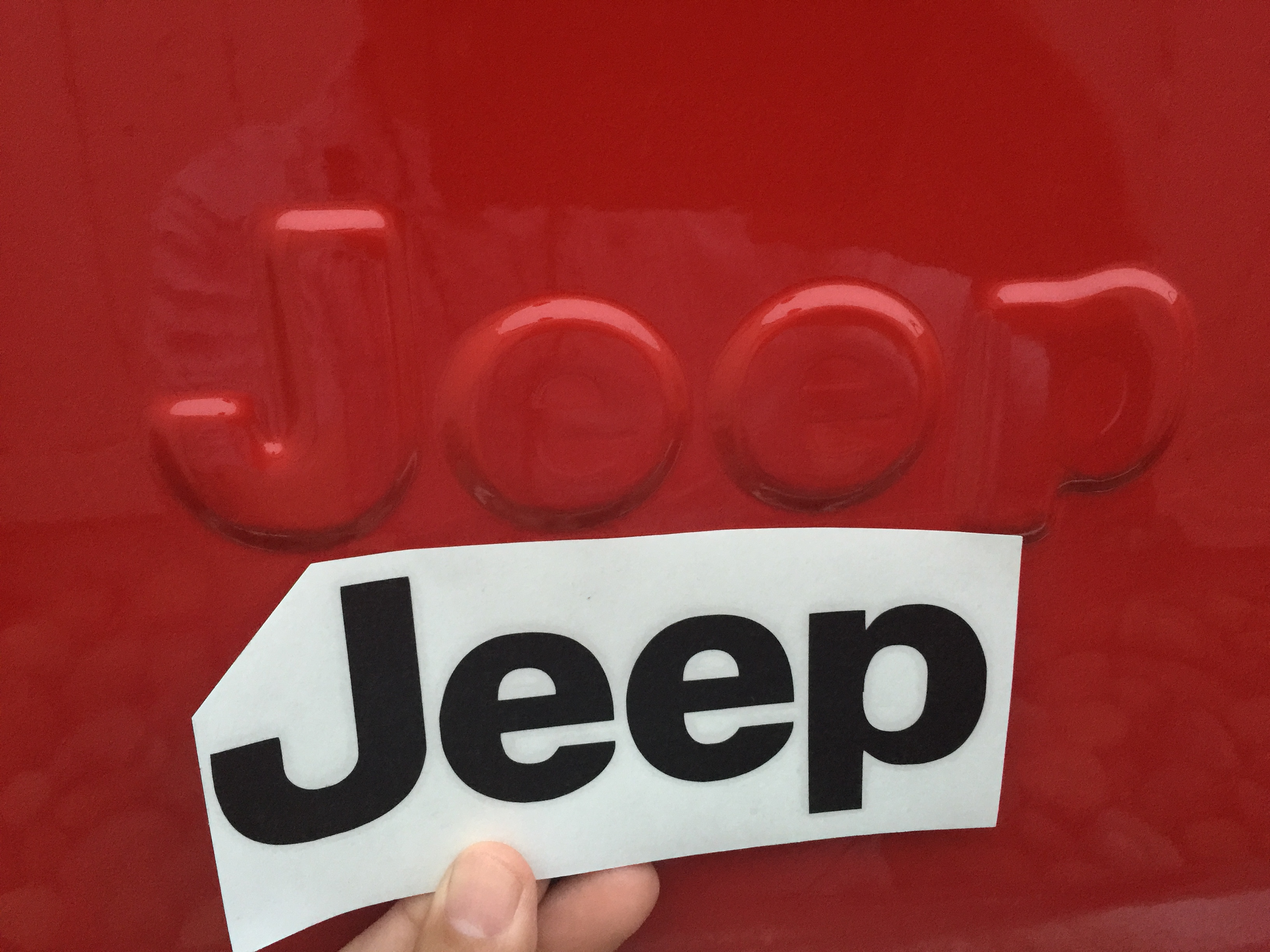

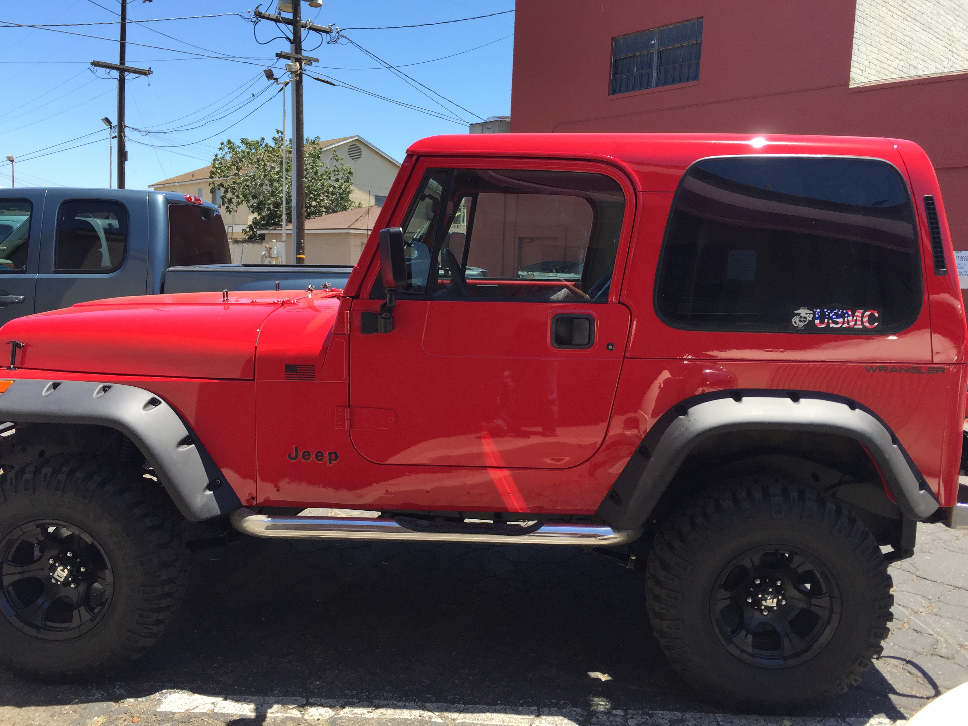

Then added the decals:

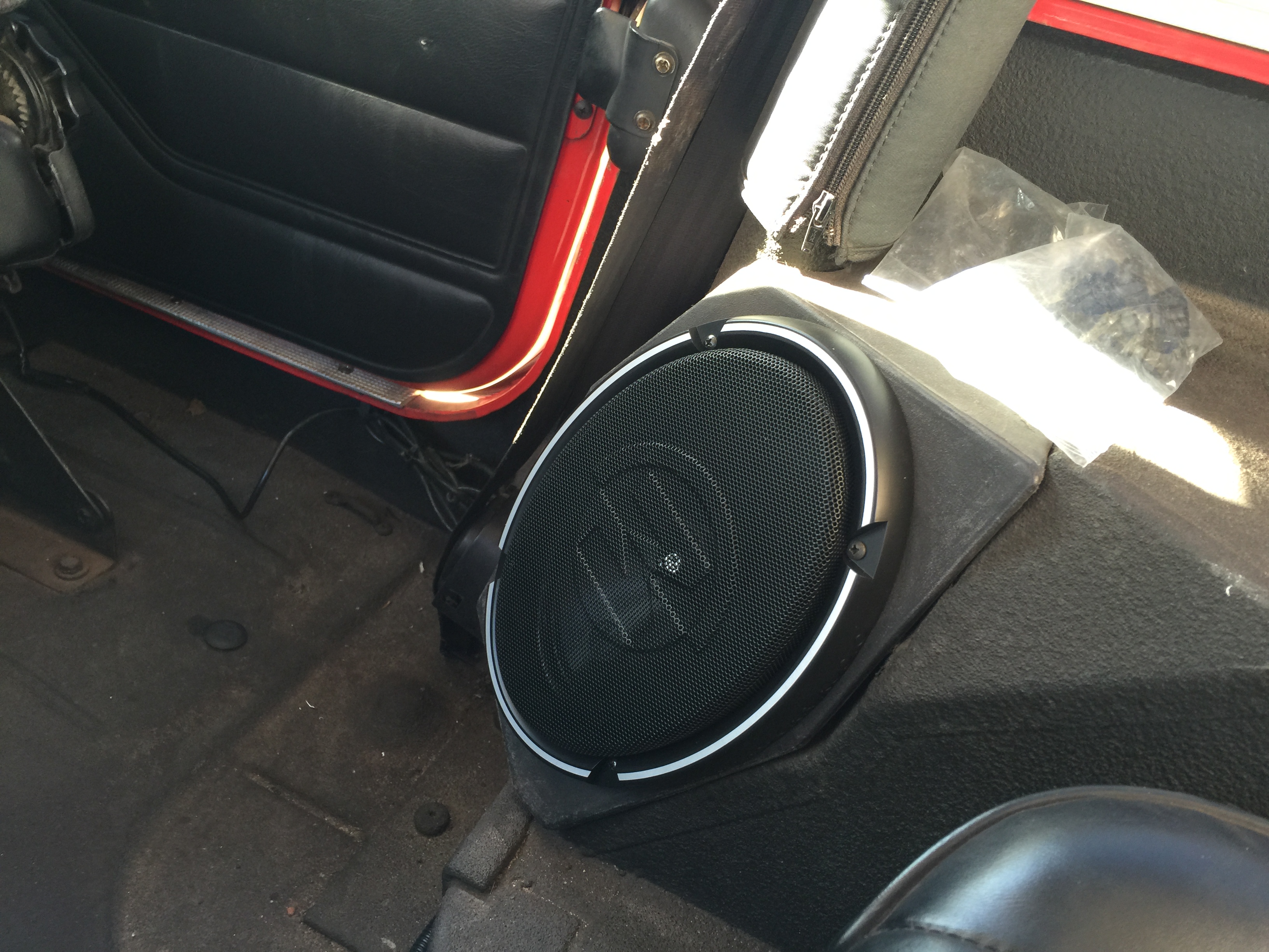

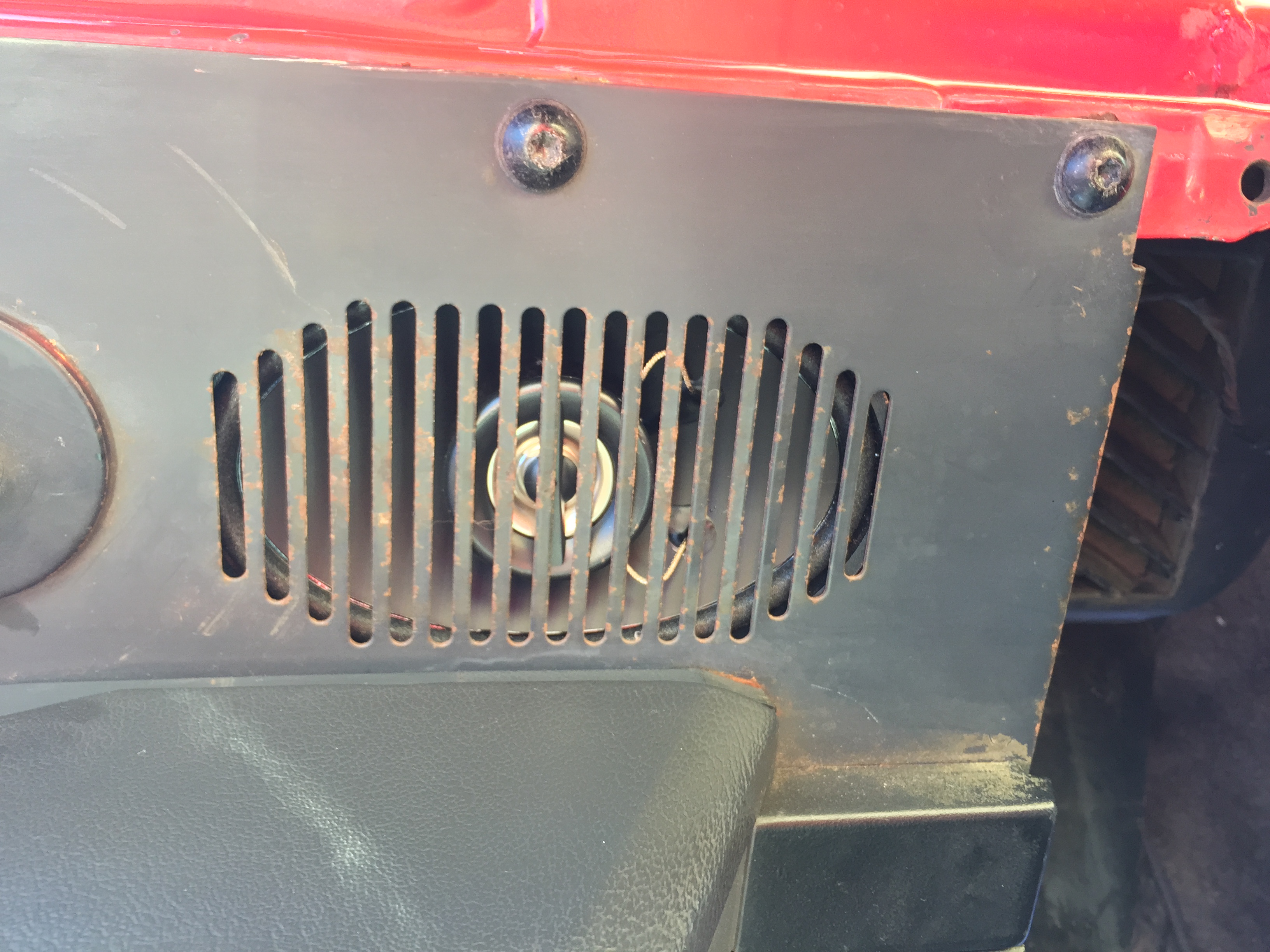

Just sent it to the Stereo shop to install:
Alpine deck / amp / speakers
Should have back later today.
Great looking Jeep. My old CJ was the same - rode so much better after putting a new lift on.
update: 7/29/2015

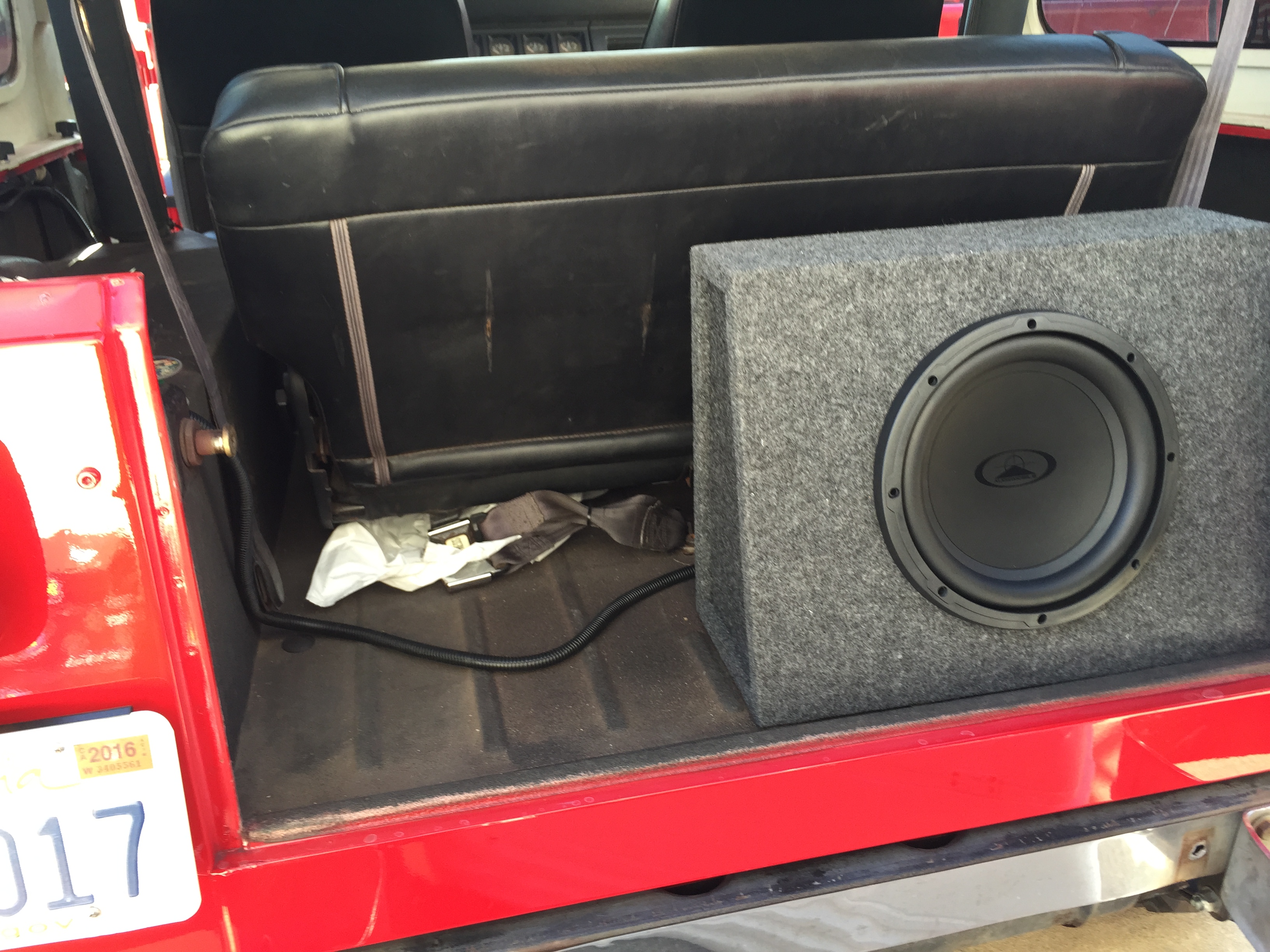

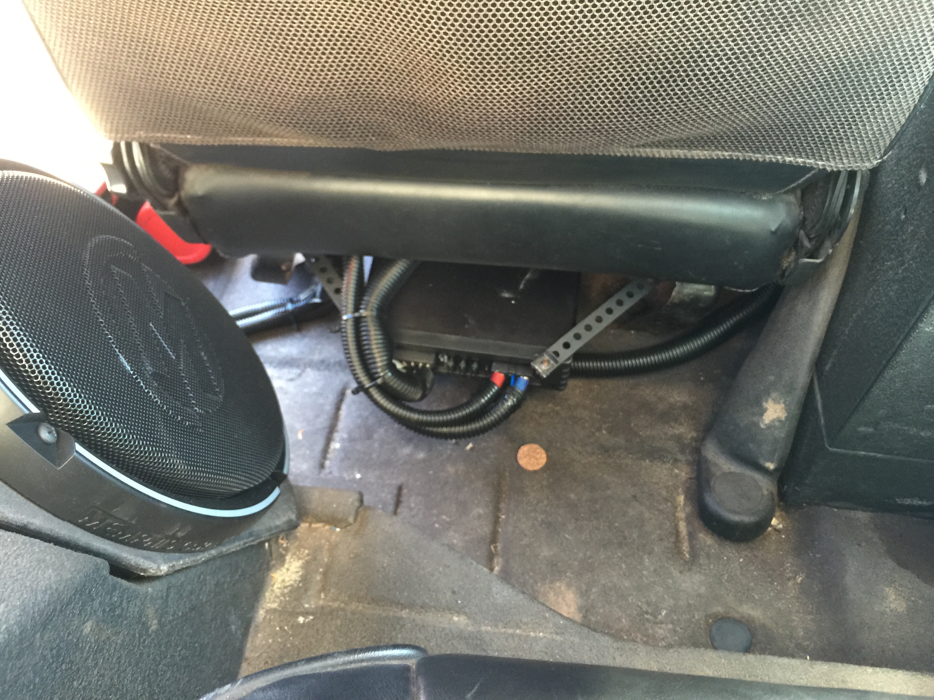

Installed ALPINE DECK / Amp / Speakers and one sub. It's loud enough to get me a ticket :)

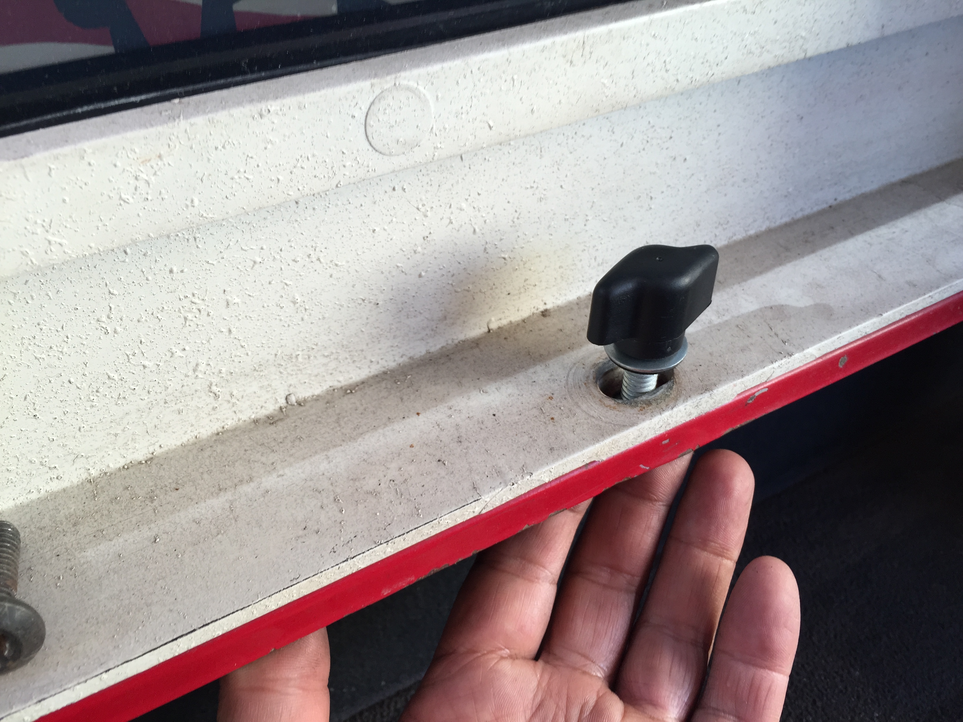

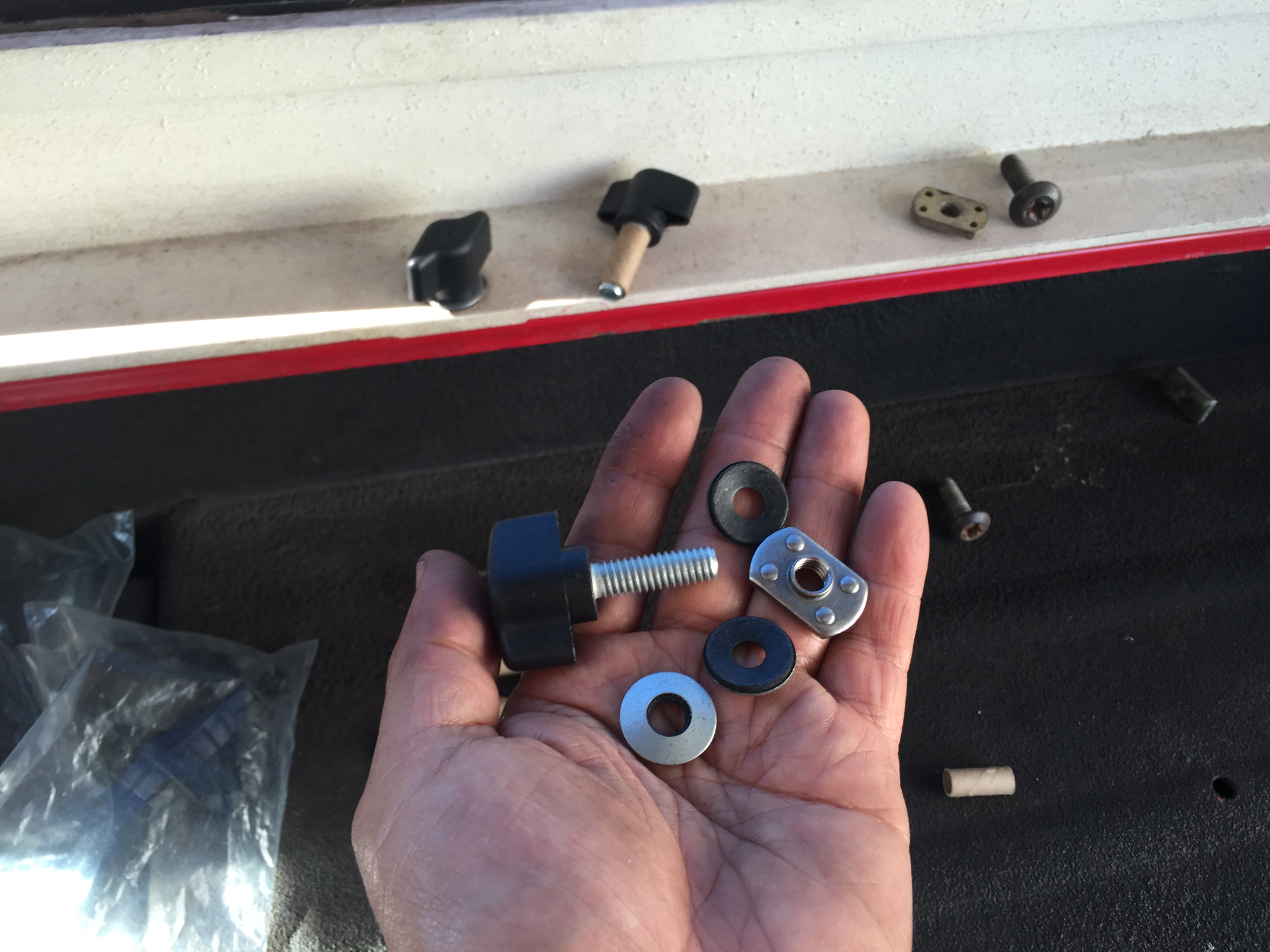

Also changed out the hardtop screws and installed these twist on...awesome!! wish they made some for the front windshield channel...they probably do, but i haven't found any.. makes taking the top off easier.

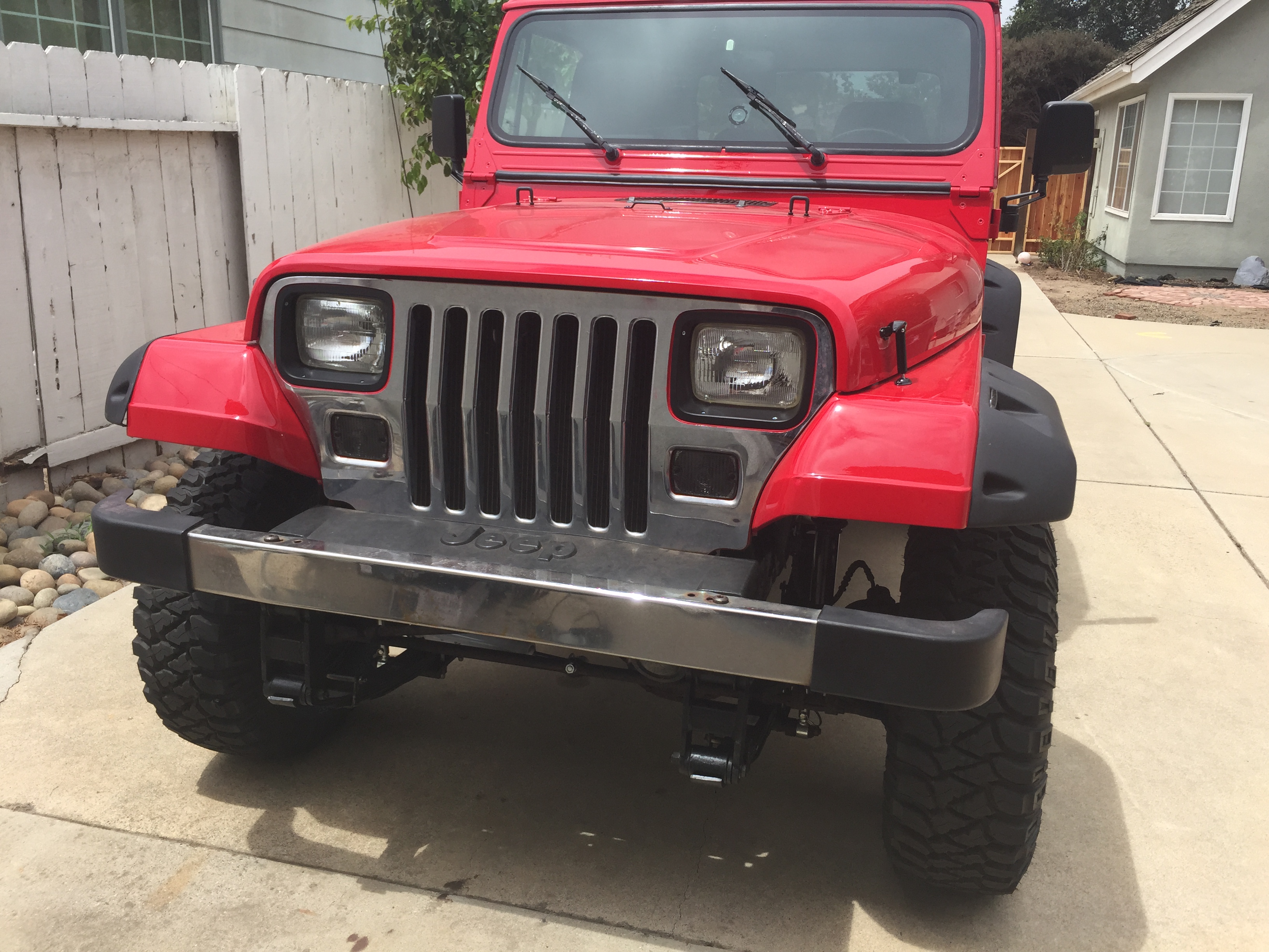

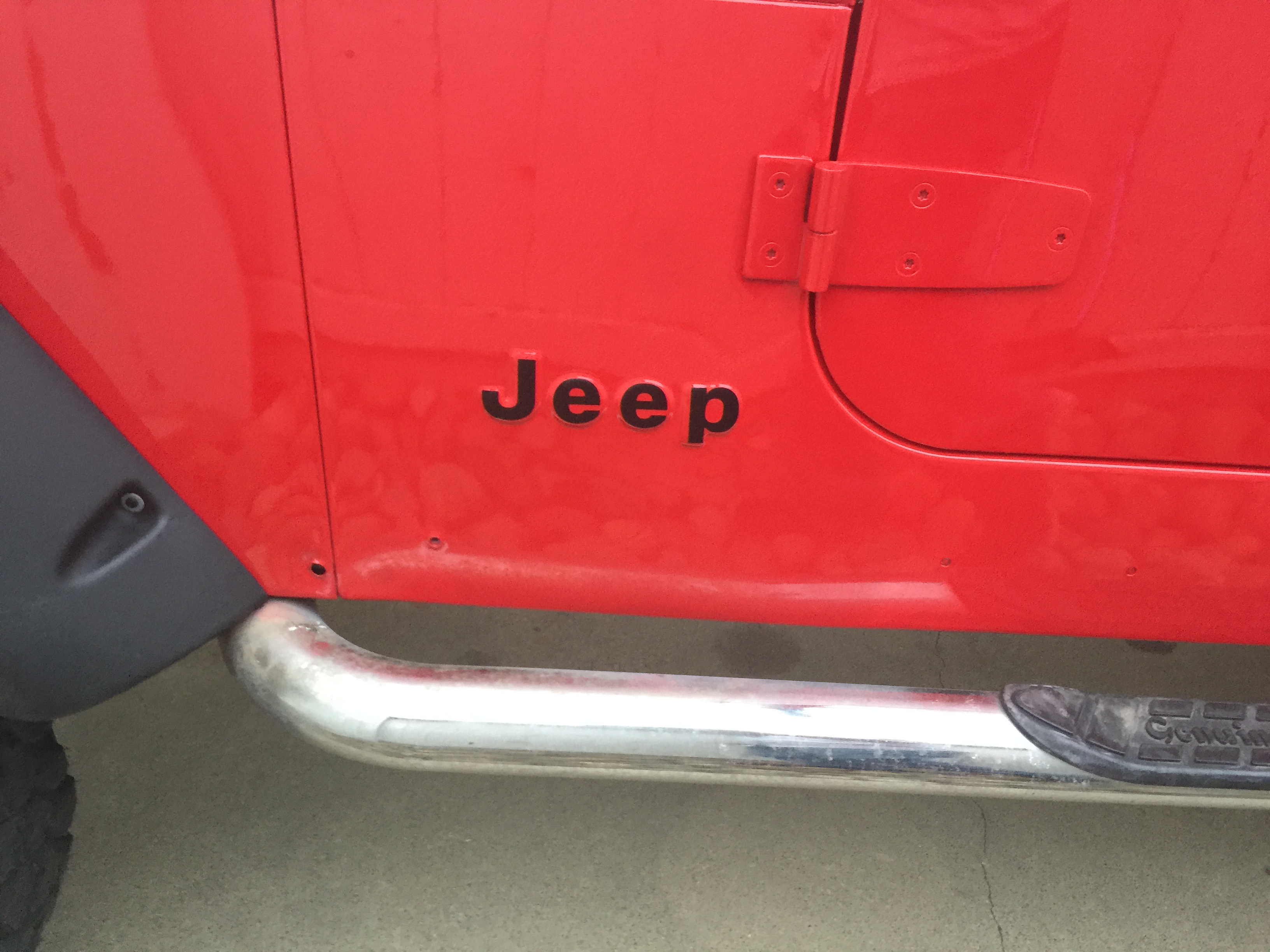

I smoked out the side markers and the front markers/blinker lights and changed out he headlight bezel and put a black bezel so that the chrome grill stands out. Added black decals and american tactical flag..... i think it looks pretty good....Any comments on that ?

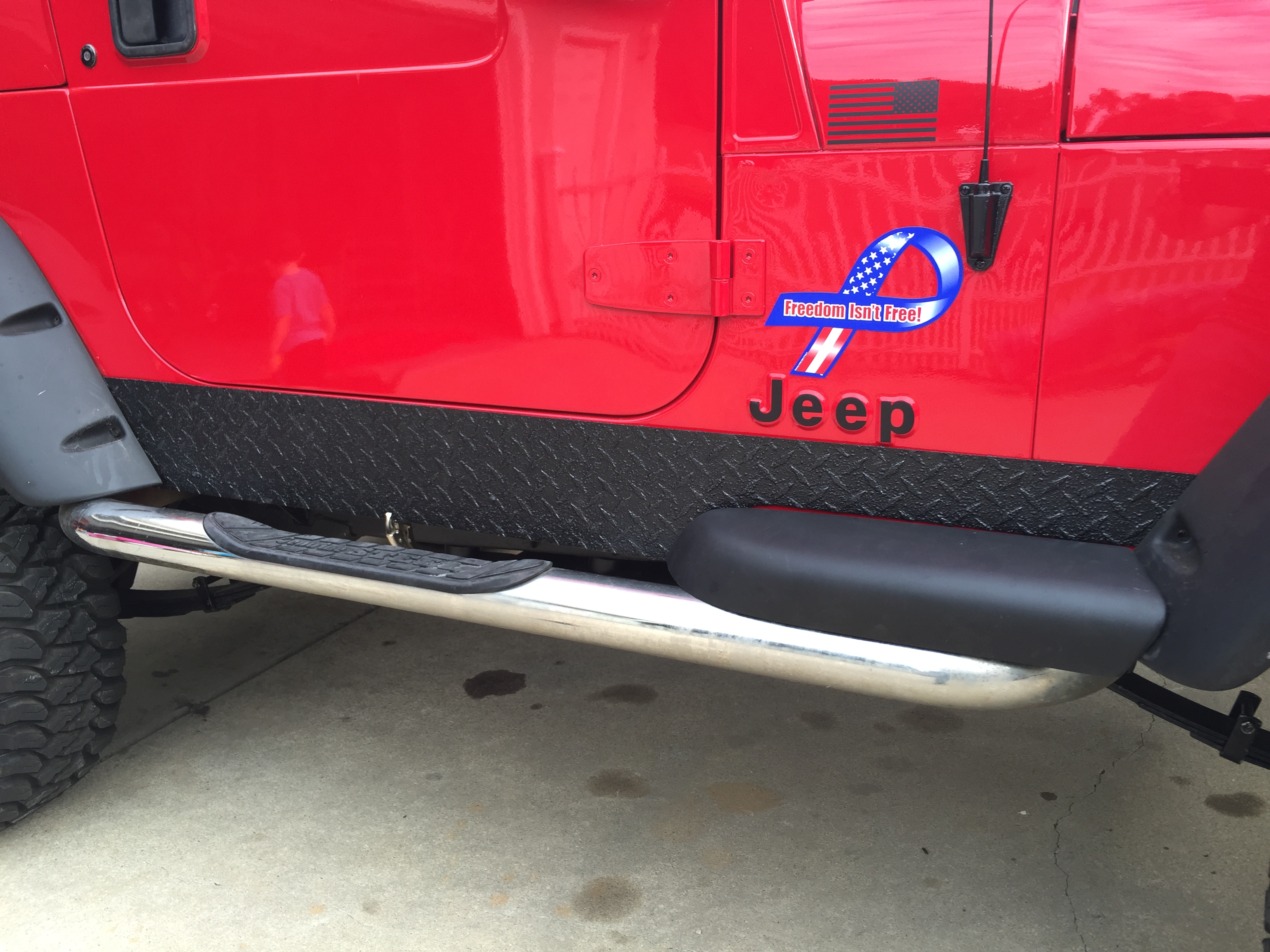

Next step is to add a rocker panel or something for the side rocker as there are holes that were done by the previous owner...not sure what he had on, but i need to cover them up. Also plan on linex the side bumpers and rear bumper brinks BLACK.

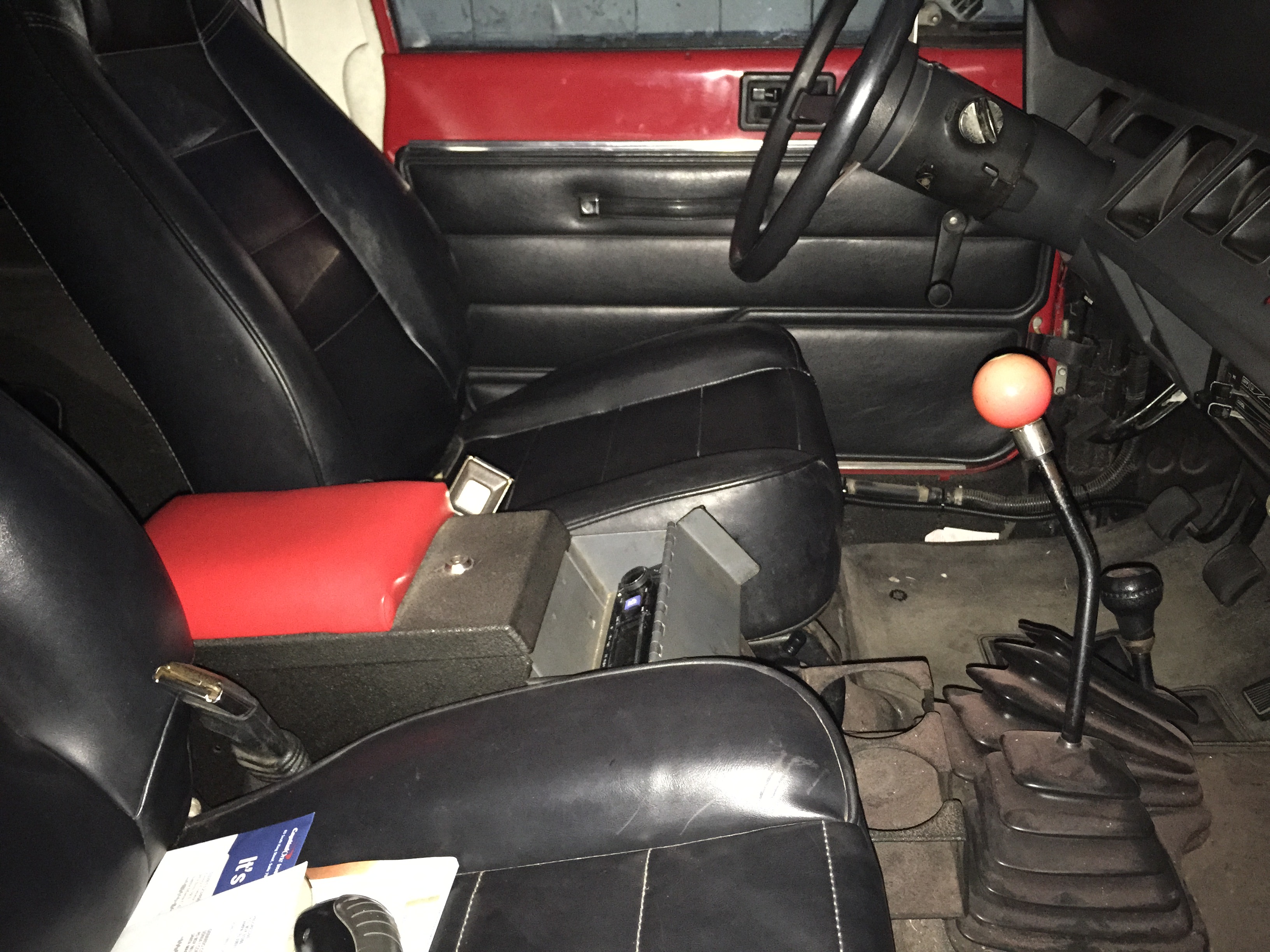

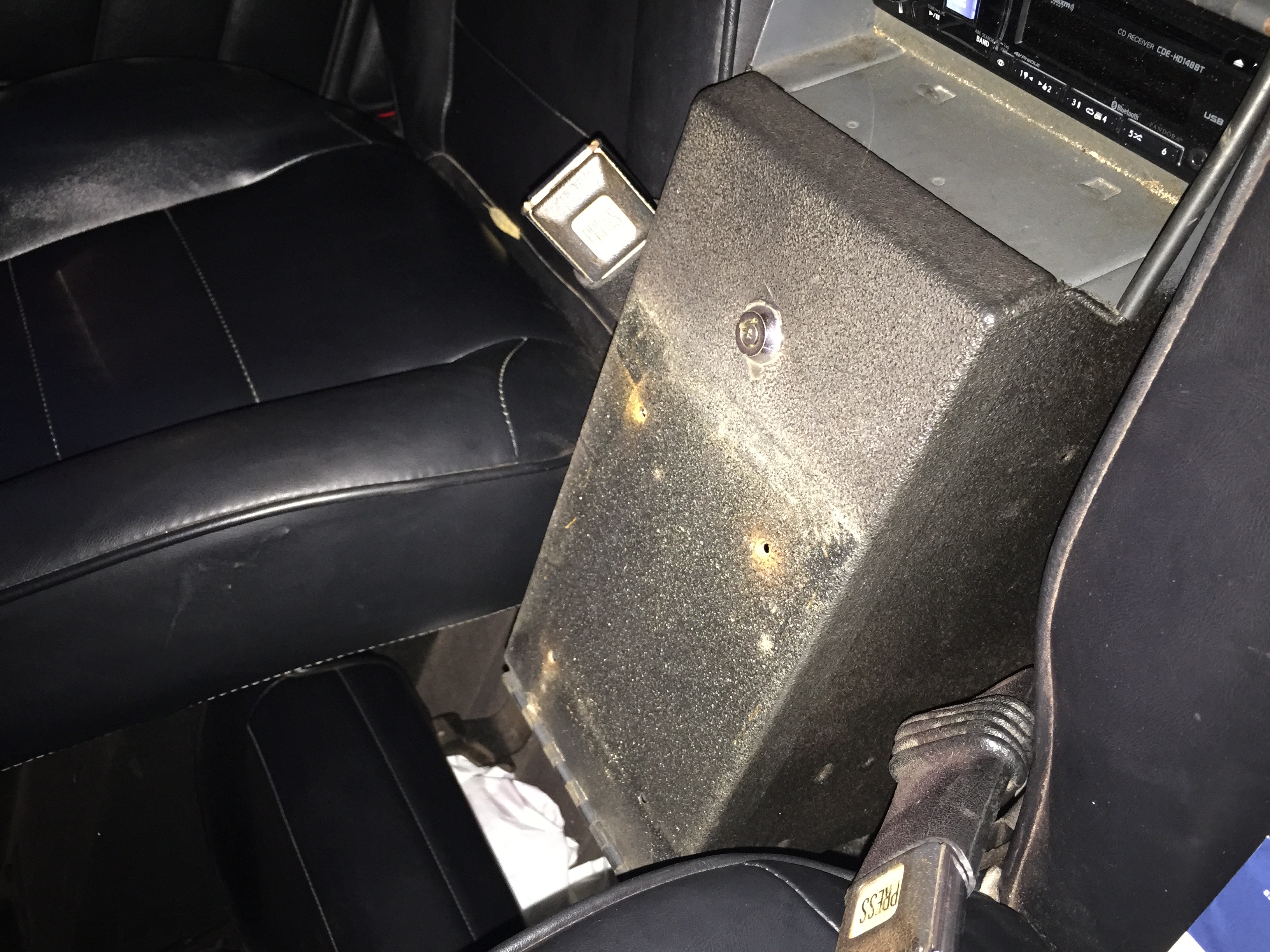

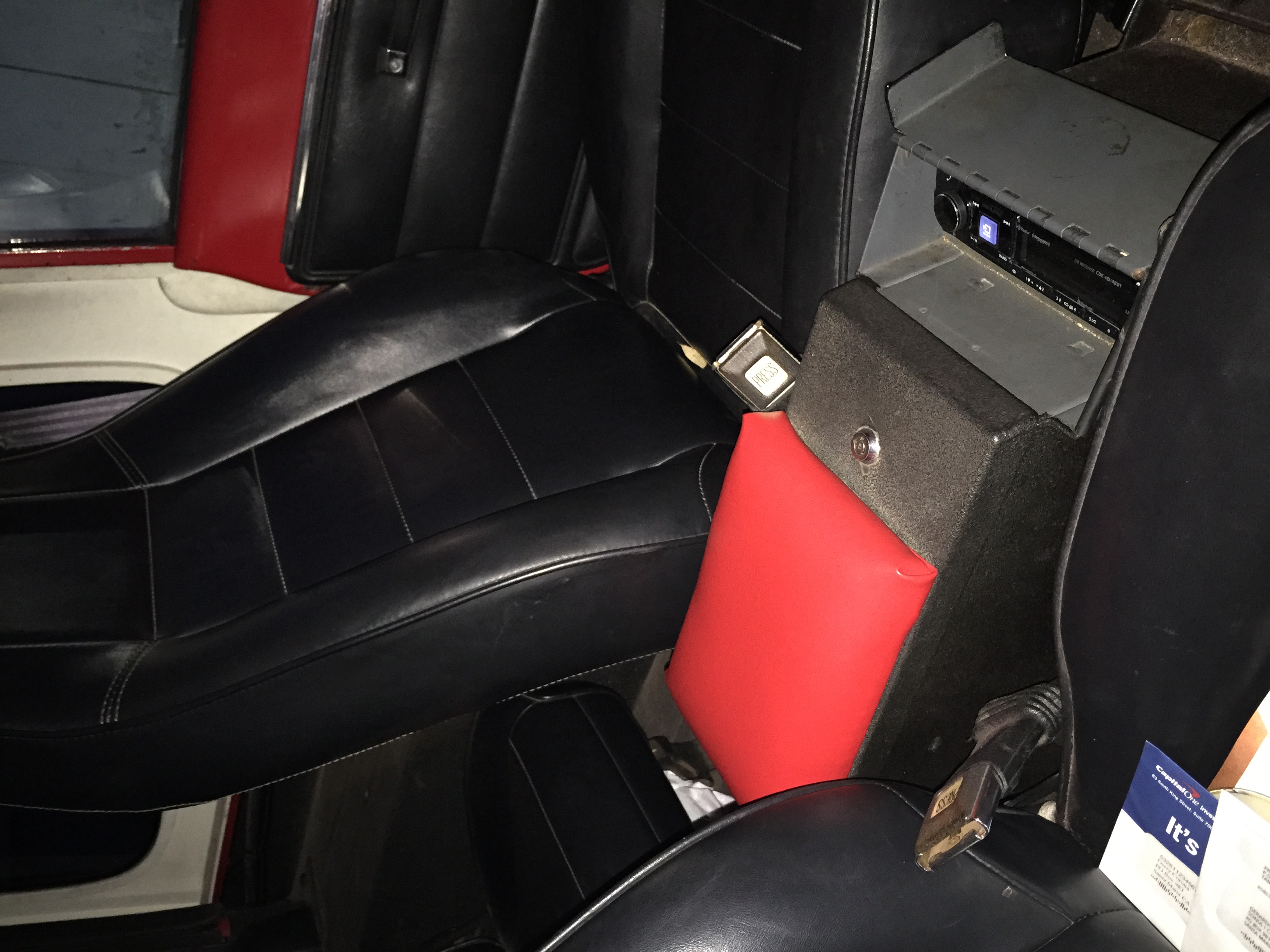

I got her involved with the build and she he made me a red cushion for my center consol. wife is happy now :)
IMG_7060.JPG:

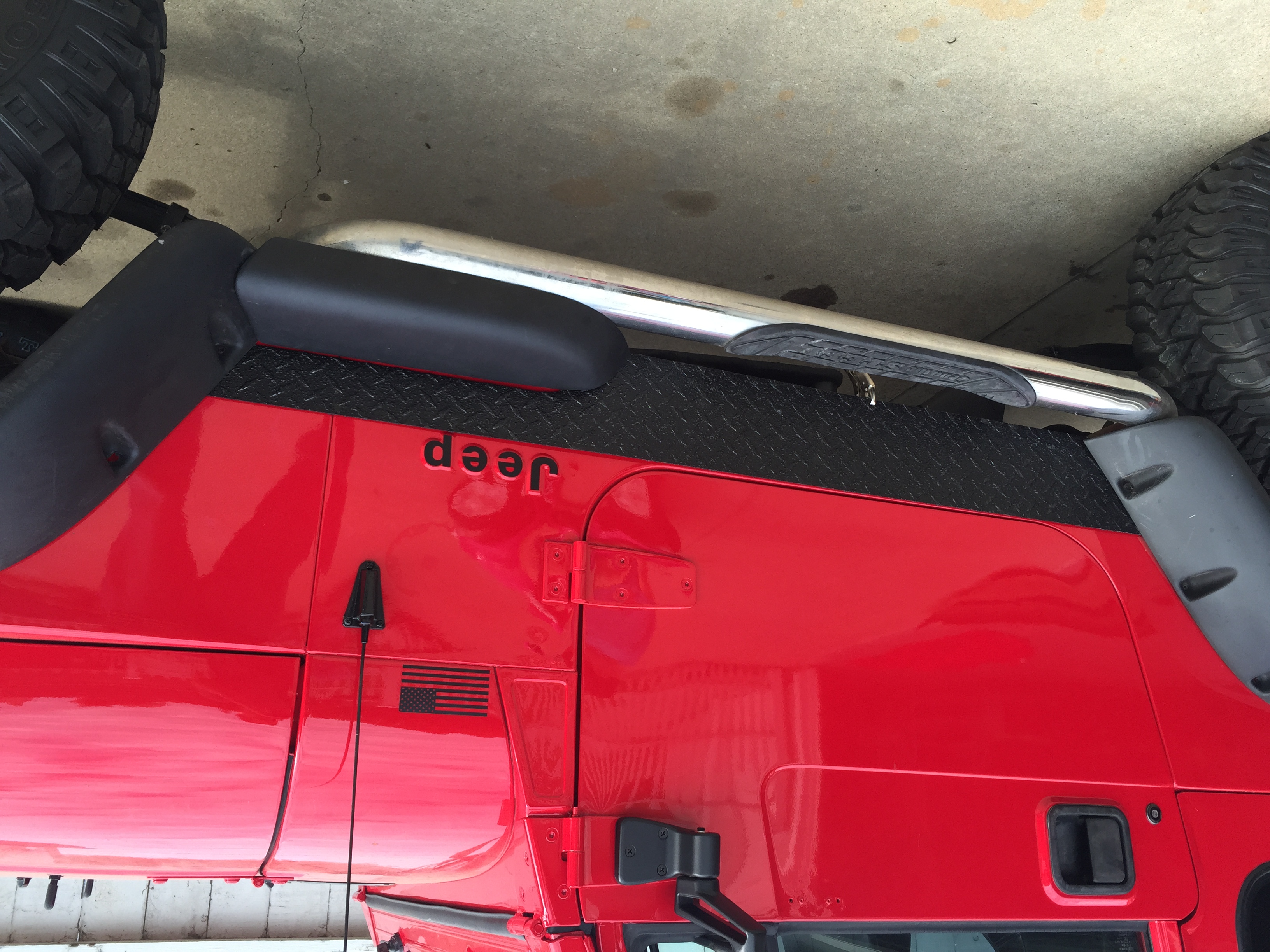

Received the Rockers but not sure if i like it or not...so i haven't installed them, i just placed them with a vice grip and see if it grows on me..
Any thoughts anyone?

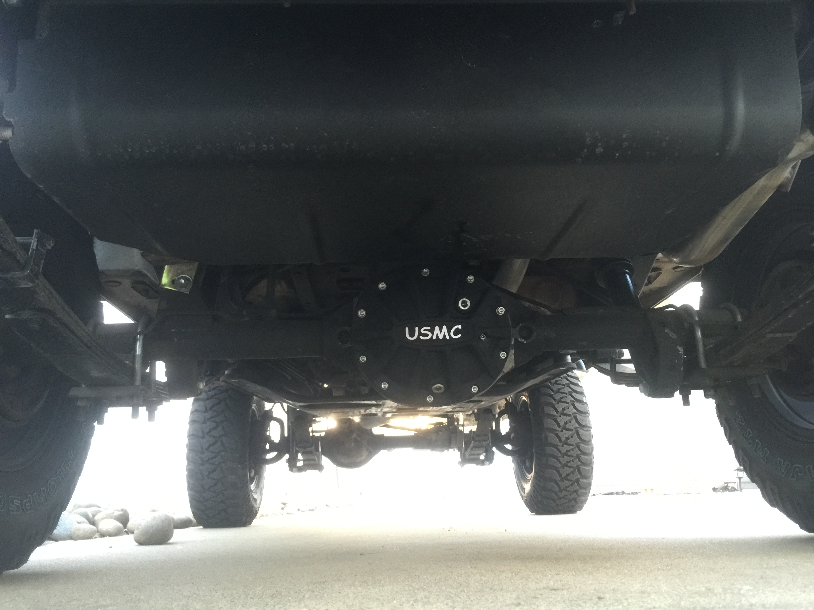

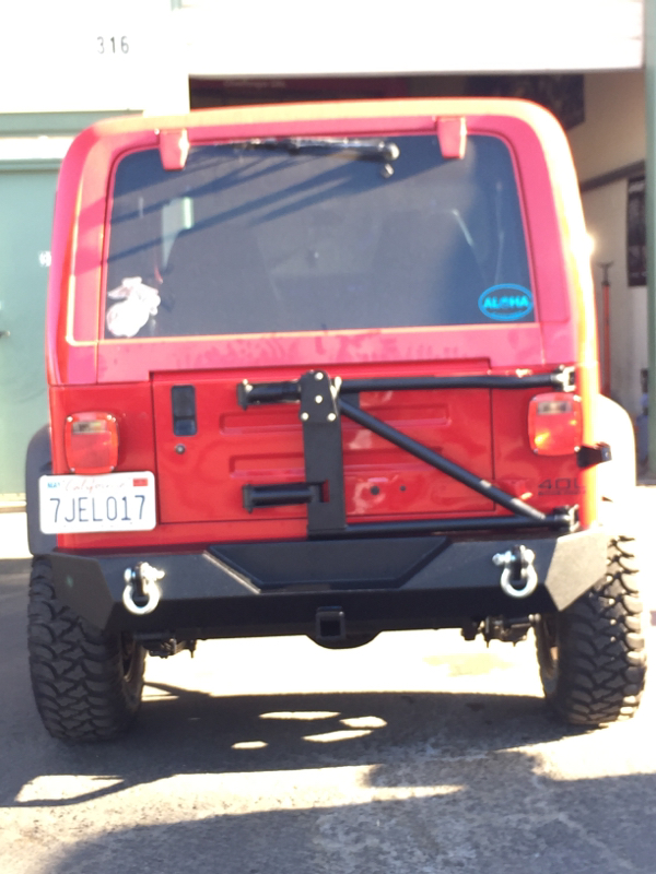

I purchased the Rear Bumper and the tire carrier. I also ordered a new Gas Tank skid plate which should arrive sometime next week. Once its here, i will install all 3 a the same time. This will complete the exterior.

I'm not sure about the rockers and the nerf bars. I'd go one or the other (probably the rockers). Really just a personal preference.
Be careful when you install the rockers if you make them permanent - you'll probably want to put some silicone
Your Jeep's looking great.
I plan on riveting the rockers on and adding an adhesive along with silicone on the seams to avoid the moisture. Just not sure on which type of adhesive to use.
I"m not a fan of the chrome nerf bars, so these might be coming off or coated black. I would like to have some type of step assistant for the wife and kids. Any suggestions?

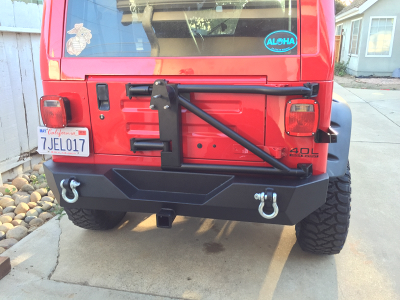

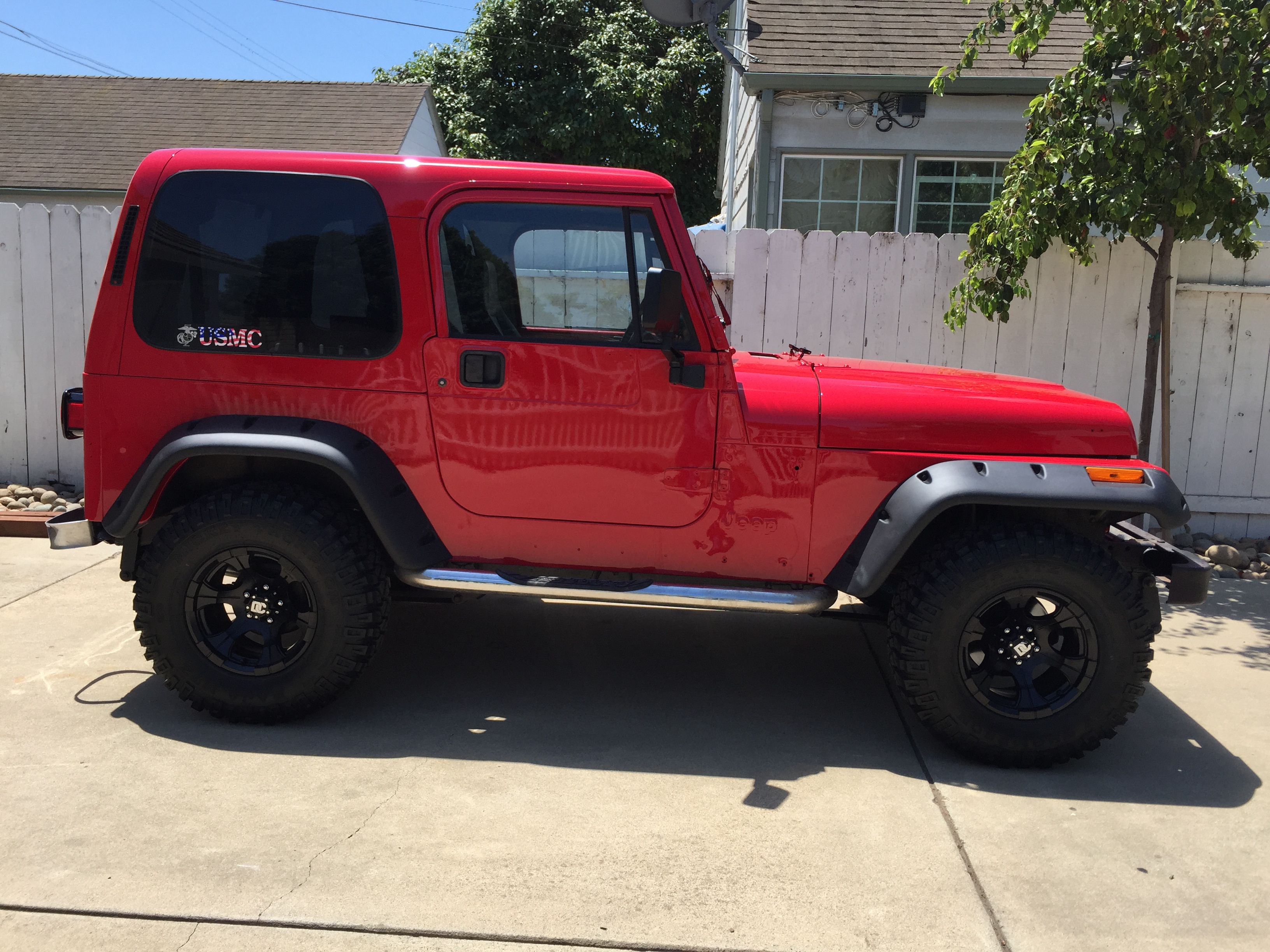

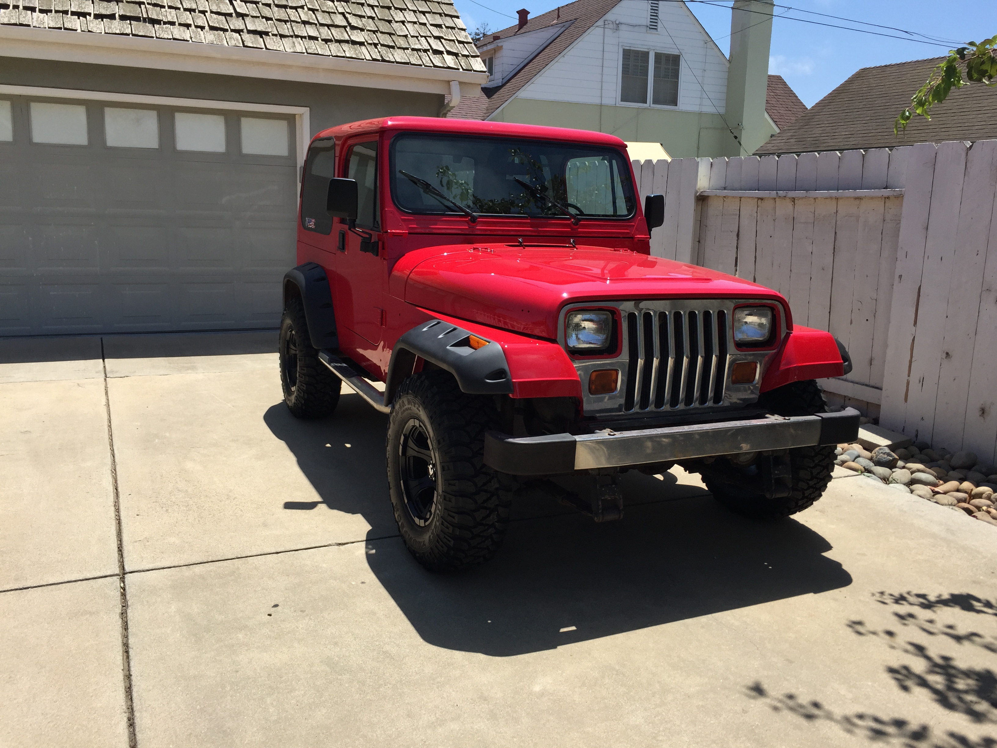

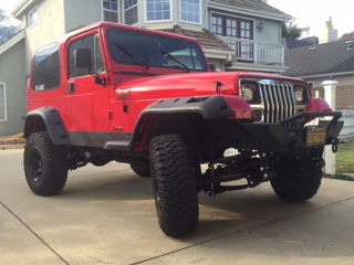

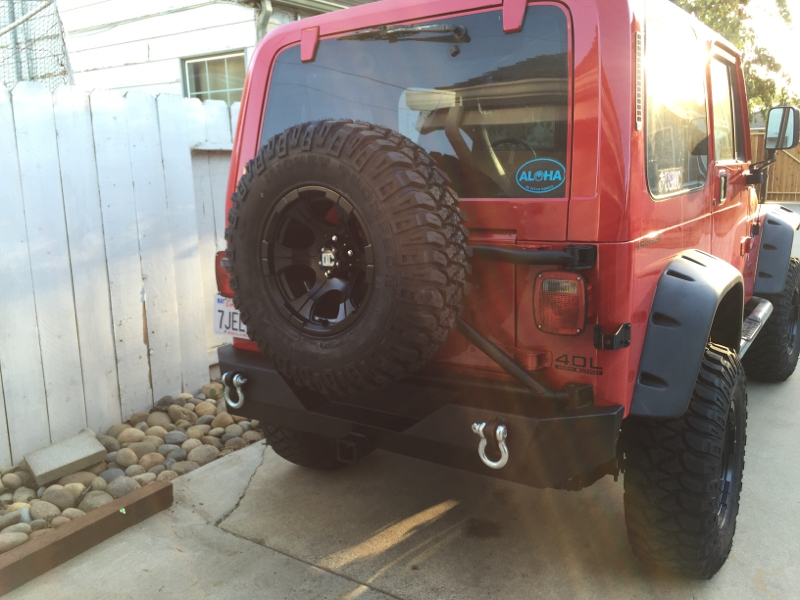

Aug 14, 2015

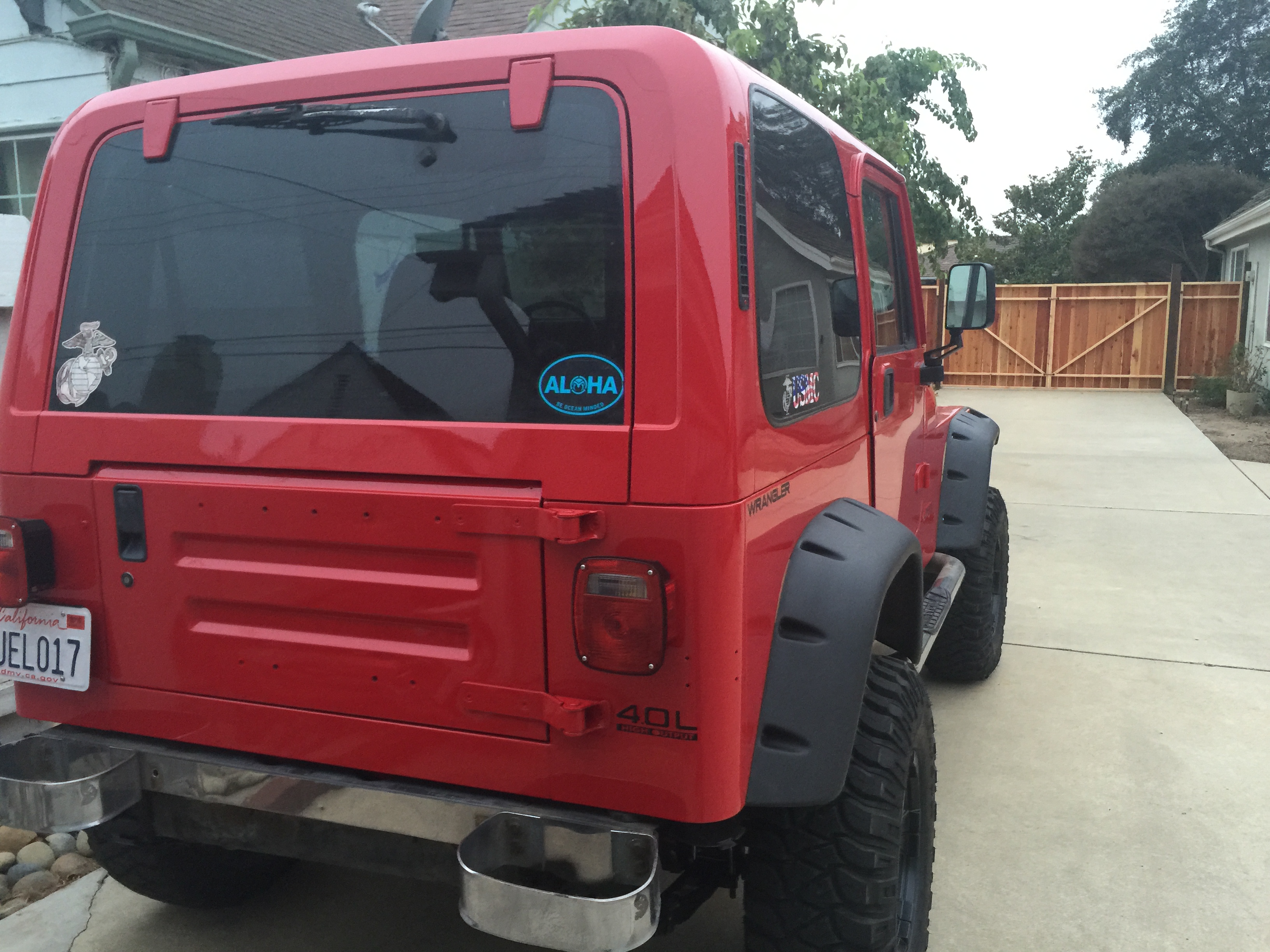

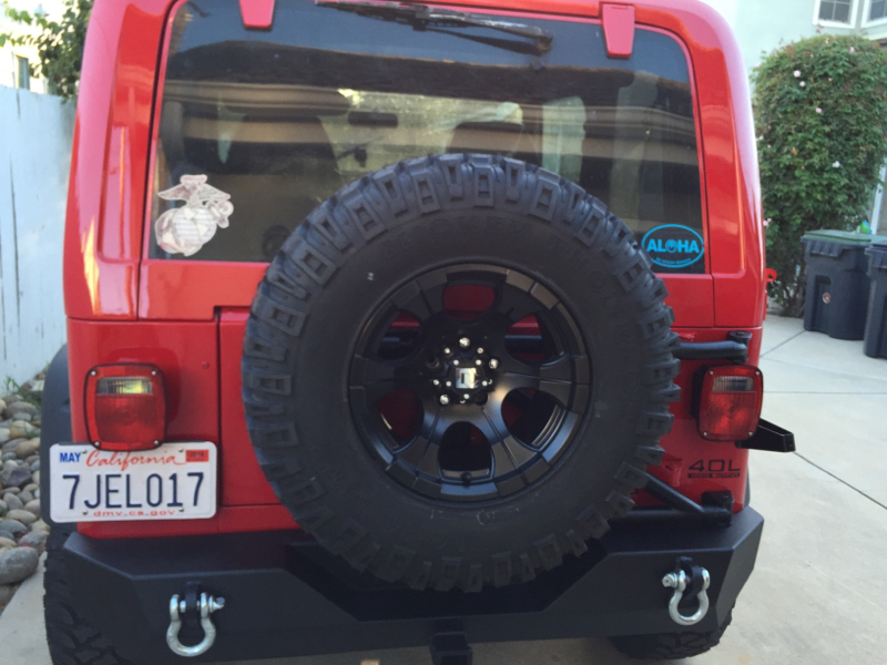

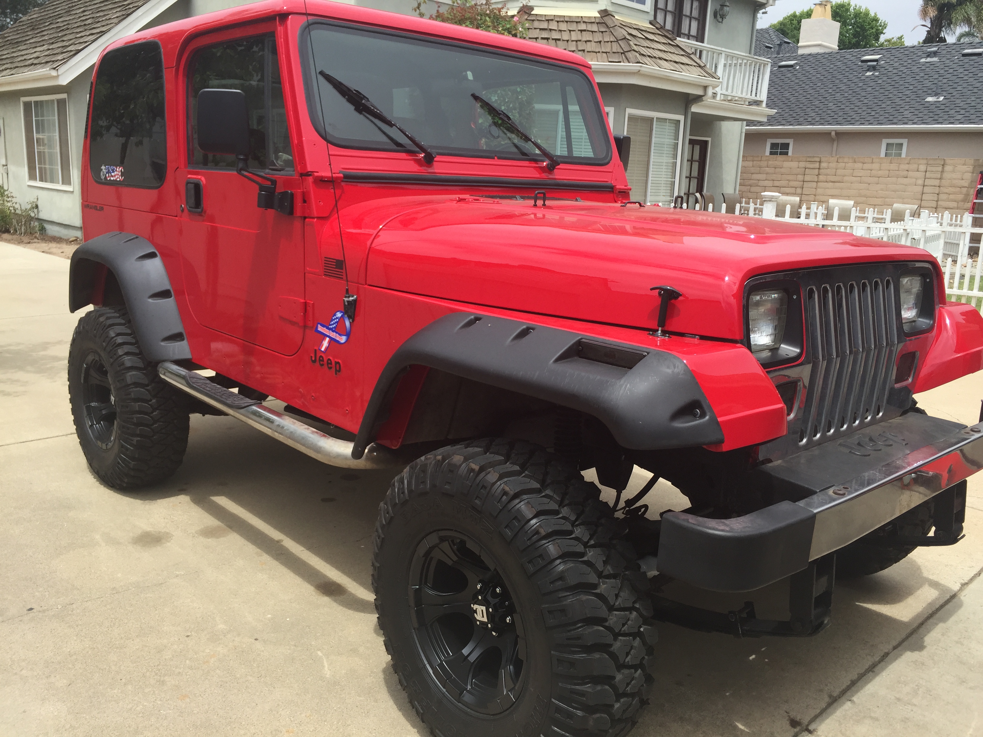

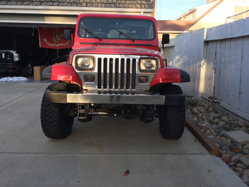

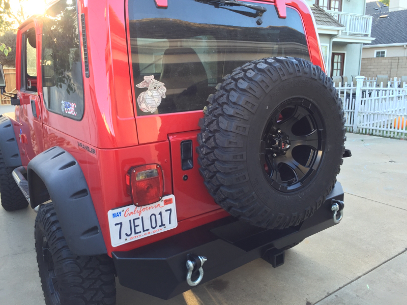

Just got the gas tank skid plate, rear bumper and tire carrier installed. image-283527915.jpg

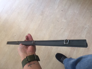

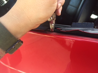

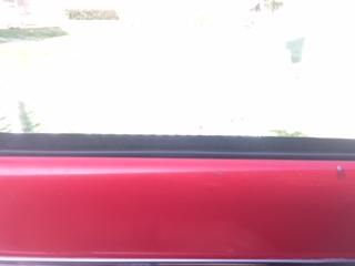

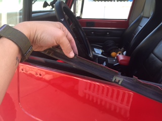

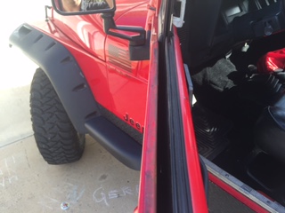

Replaced the hard door window outer weather strip and inner felt which was little challenging...the old ones were cracked and dry. Used vice grips to pinch where the metal hooks are and pulled straight up.
Installing the felt and strips was little challenging because i did not remove the windows. I did have to use a screwdriver to help assist and push the hooks flush on the door panel and in order to make it into the slot (window was in the way)

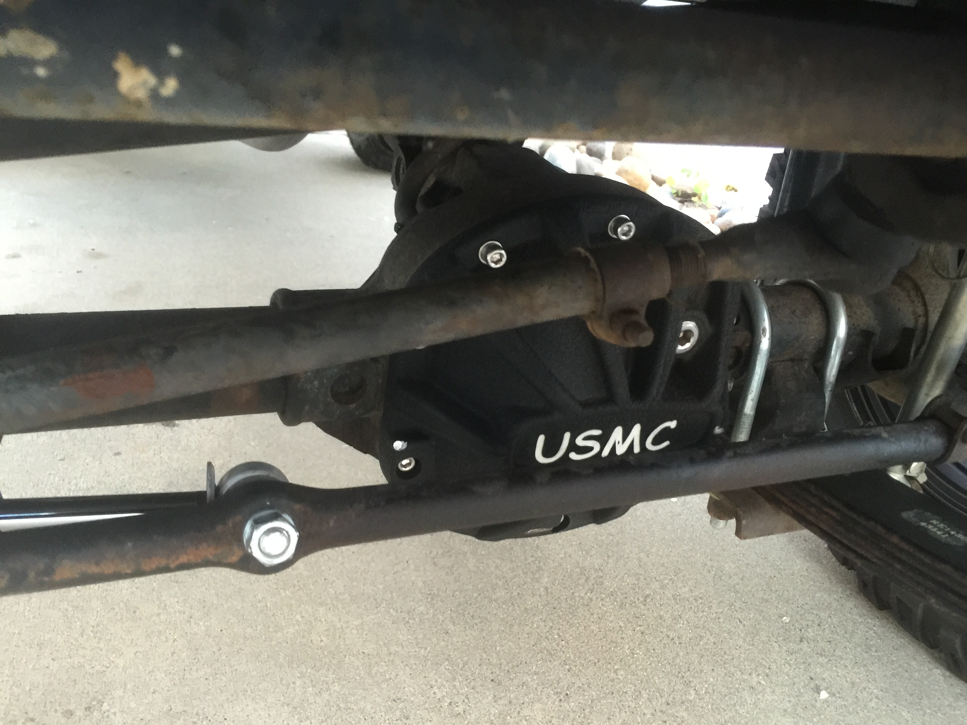

I also installed a new front bumper and removed the Chrome Nerf bars
