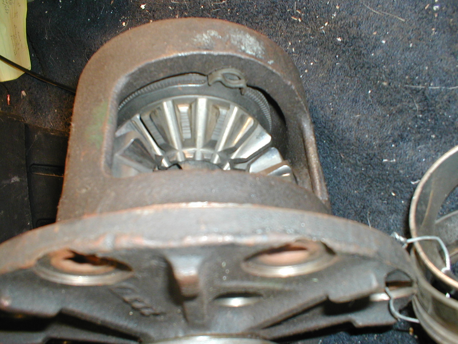

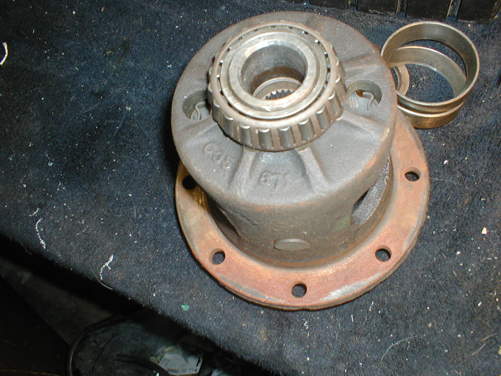

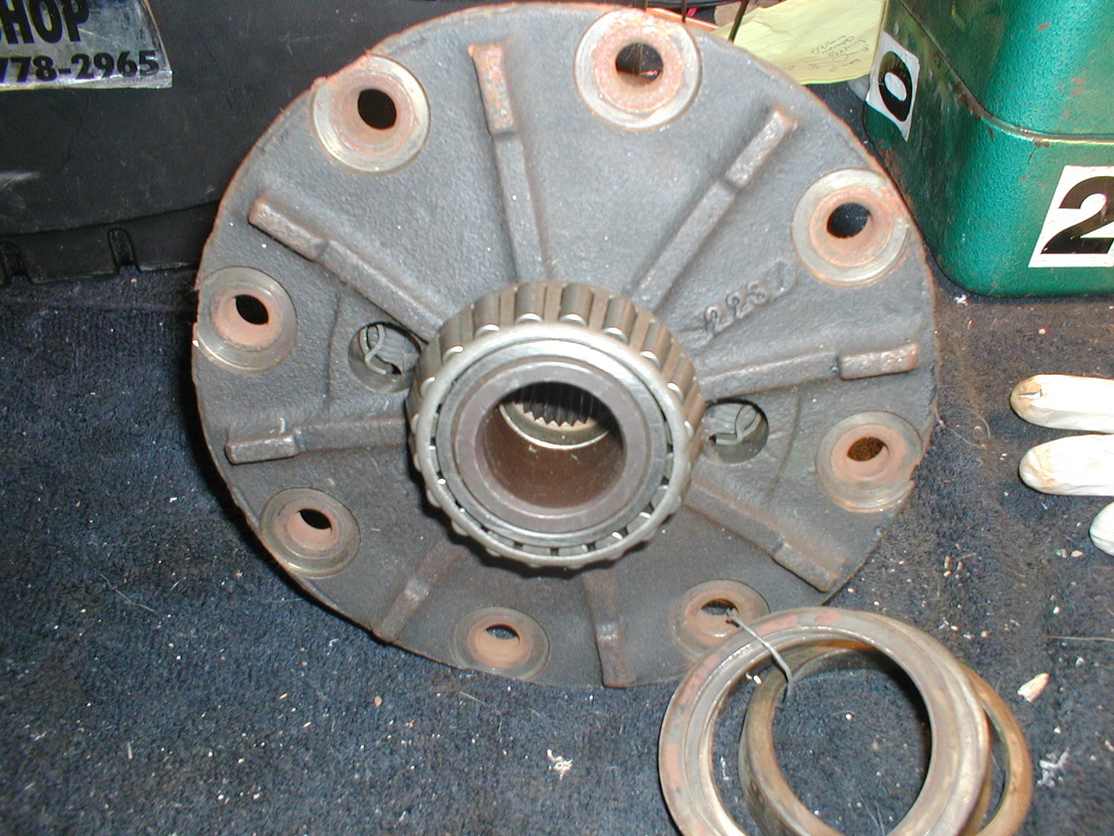

OK, so I have this Cj7 with a dana 30 in front, a dana 20 in the rear. I got a dana 44 with a posi, and 3.73 gears for the back. I can buy a Detroit Ez locker for that as well from a friend, and another locker for the 30 from a different guy. I also have an unknown diff carrier which has clutches in it(in an unmarked box in the floor of the jeep when I got it) it has 29 splines inside the side gears. how can I find out what that is for? I may be dreaming, but if it's a posi for a Dana 30, I may use it for my front end. Is there any way to ID what this thing is?
I have pics. anyone know if 29 splines is for a particular Axle type? for all I know, It may not even be a dana/Jeep part. Also, I need a set of 3.73 gears for the dana 30 (whatever carrier/locker/posi I end up with) Help please!! Frank

I can'
t make out the casting numbers, Iif the inside spline count is 29, that means the corresponding axle would be 30 spline.I am no way a CJ expert, but I don't recall a D30 having 30 splines factory. The Model 20 I think had 29 spline shafts, but might be 30 and might be what that carrier is for. Again, I am just guessing. I have a couple 2.73+up D44 carriers in my garage waiting to get scrapped and none of them look like that, so I am leaning towards a Model 20

very helpful, thanks. Looks like that Posi is for the AMC dana 20, I'm not buying one piece axles for it, I got a 44, so I need to build the front 30 up, and get matching gears hoping for 4.10 or 4.30. thanks again, Frank
