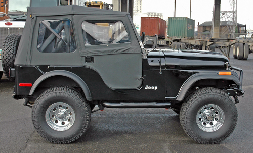

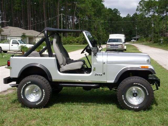

Here is a picture of a CJ5 and a CJ7 - note the little bump on the 5's door
YJ and TJ doors will not fit on a 74. Terry has provided a good photo comparisin of the two. You might need to go with aftermarket soft doors. If you drive both Jeep types frequently you'll always get the "kick in the butt" from the CJ5 doorway as you get in. You get used to the extra space in the CJ7 doorway pretty fast and "OWWWEE!!" there's the kick in the butt as you jump into the CJ5:lol::lol: (or in my case M38. Best of luck - John
