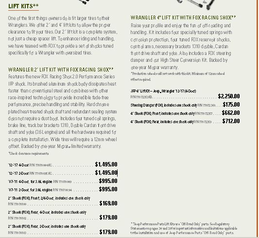

Adding this a little late BUT others may benefit.
KISS (keep it simple stupid) - excellent quality all in 1 kits, not a pieced together multi vendor assortment. At Your jeep dealer.

Yea that would have worked about a year ago for me lol. I already got all that. But mine is a 4 in rough country so I have the springs and shocks from them for now. Bought alpine control arms all 8 teraflex monster front and rear adjustable track bars Adams 1350 double cardon front and rear drive shafts teraflex high steer kit and it's still wobbly.
One must be carefully because a "kit" sounds like it has all you need. The "lift kits" often do. It have all components but the low cost draws you in.
