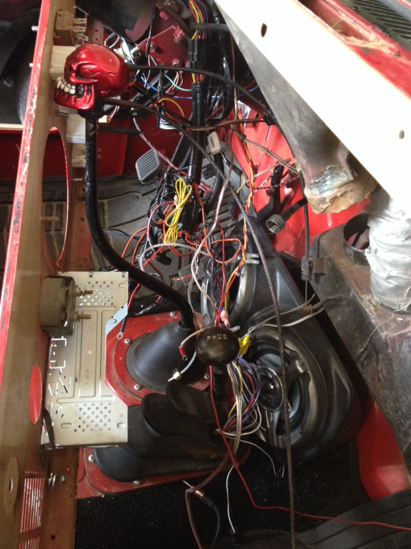

So I went from a rats nest, to no wires. I'm at the point of no return, hope i can put it back together and get it running. #nervous.

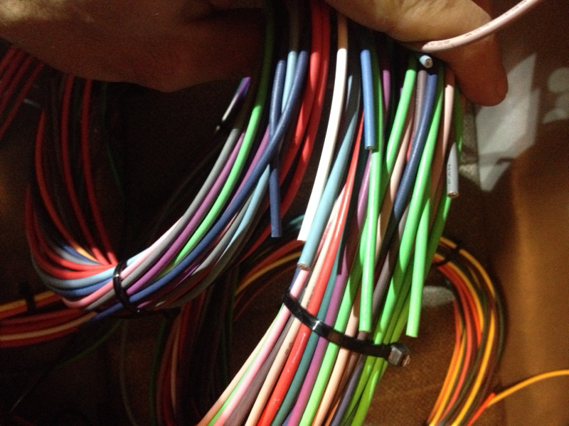

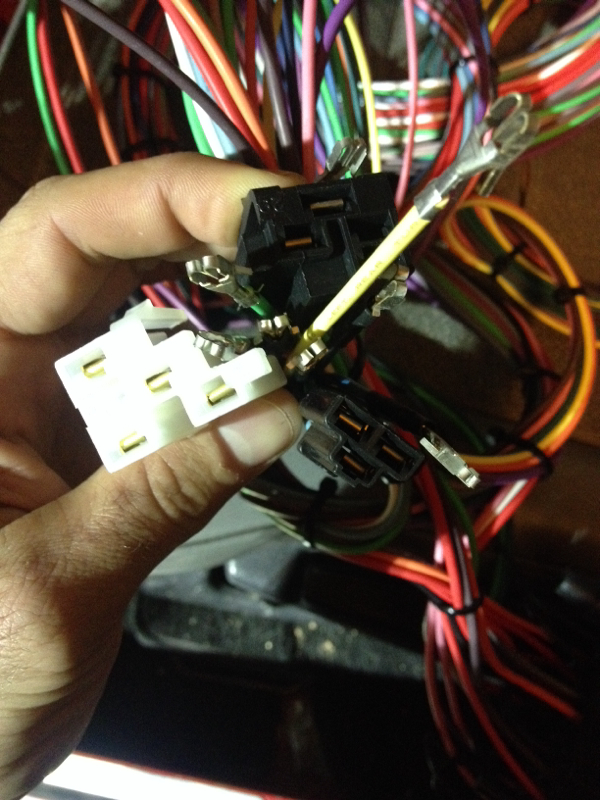

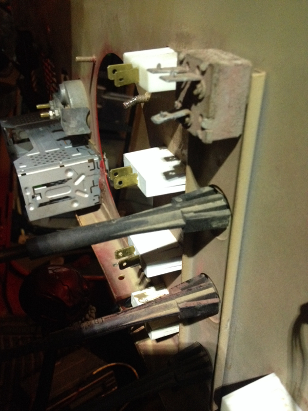

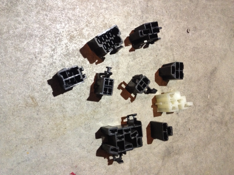

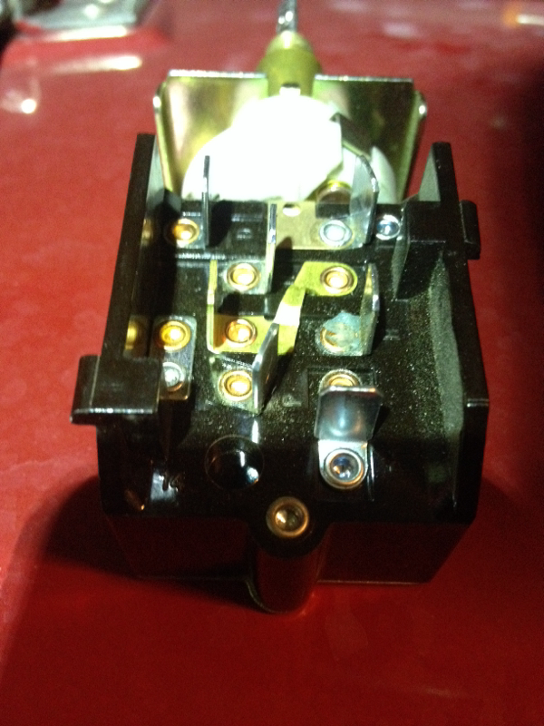

So one thing I have found is that all the nice plastic wire connectors don't come with the EZ kit. EZ simply has bare wire ends. I've taken all the ones off the old wires that I could salvage. The big deal about this is 1. Connecting all the dash indicators would be a pain without them 2. Connecting the light dimmer switch would leave too much stress on the connection. 3. In my case, the head lights and tail lights are nicely connected and wrapped in plastic tubing. I don't want to rerun all that wire, so I need a solid way to connect those wires to my be harness. The plastic connectors allow for less stress where the old and new come together.

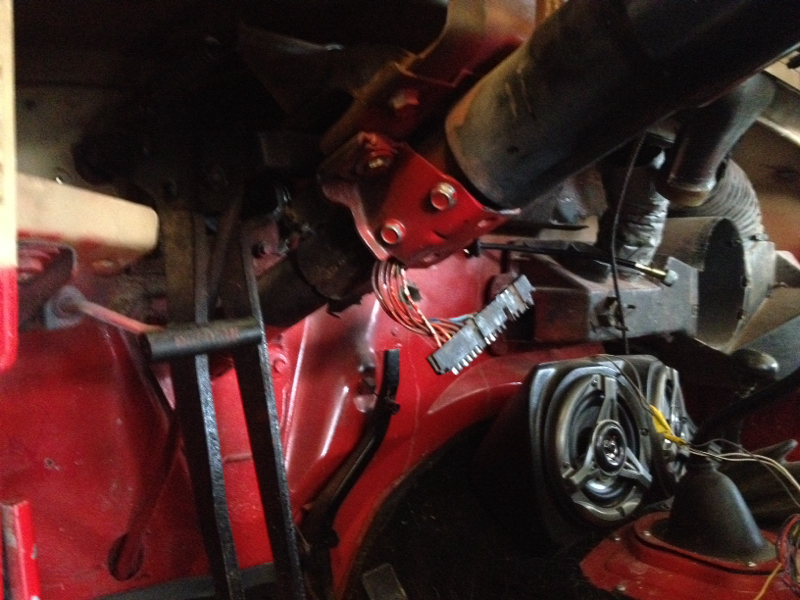

The only part that I'm not certain about is the headlight switch at the dash? Does the 77 have the switch that uses a snap in plastic connector thats square (like the later CJ's)? That you may have to re-use.
So to answer some of the questions. 1. Yes the EZ harness wires are mostly bare copper. With a few exceptions but there is a huge need for the male / female metal connectors along with the plastic connections to keep everything grouped. I don't think it's worth an extra $200 if the painless come with the caps. 2. The dimmer light is a weird set up on the 77. Pictures are attached. The only connector I could find for sale was a four prong, so I was happy to be able to salvage the old connector (7 pin). 3. I have the plastic adapters for the tail lights, but bare wires for the headlights (connected). So after getting the metal ends, I will be able to attach the tail lights with ease, but will have to also cap the headlight wires.

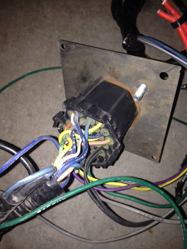

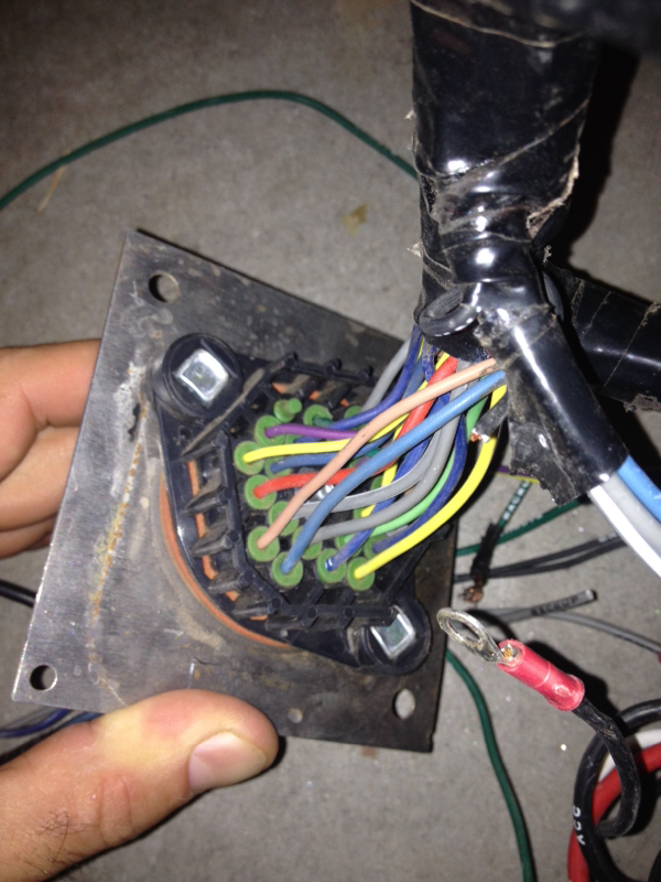

Question for y'all, the old set up had this nice "through fire wall" connector. Anyone know the nomenclature and if I could find another one? I now have a big hole in my firewall and need to close it off or reinstall this type of connector.
Through wall connector
Light Dimmer switch
EZ harness ends
Only connectors on harness
Salvaged connectors
Dash indicator lights that need connectors.

Ok...... Now things are starting to making more sense or are coming together rather. You're removing what appears to be a Cen-Tech (early design) wiring harness, so it is your Jeeps second at least re-wire job.
I'm not certain how the EZ kit runs through the firewall? Does it have some kind of bulkhead connector for the wiring that passes into the engine bay? The OEM setup would have had a fuse block that screwed in over the hole in the firewall and two plug connections routing from the back of it, one for head lights and the other for the engine. Regardless, you may have to make a cover for the existing hole whether it be made of steel metal (DIY fabing) or check with an electrical supply shop for a rubber gromit.
The dash indicator lights in your photo are simply connected with female press on connectors, soldier or crimp on are available pretty much everywhere ( i.e. STA-CON).
EZ kit runs through the fire wall as a bundle of wires. I'll need to add some type of sleeve/rubber gromit or else the thin metal will slice away at the plastic coating on the wires. The connectors for the dash indicator lights won't be a problem. I was just pointing out that there are none included with the kit. I'm at a standstill for a while. I ordered an assortment of connectors for the wires so they'll take a couple days to get here. This weekend job is already 5 days old. Hopefully Saturday, I can make a big push to get things hooked up. Thanks for all the conversation on here, it's given me some good insight, ideas, and items to pay extra attention.

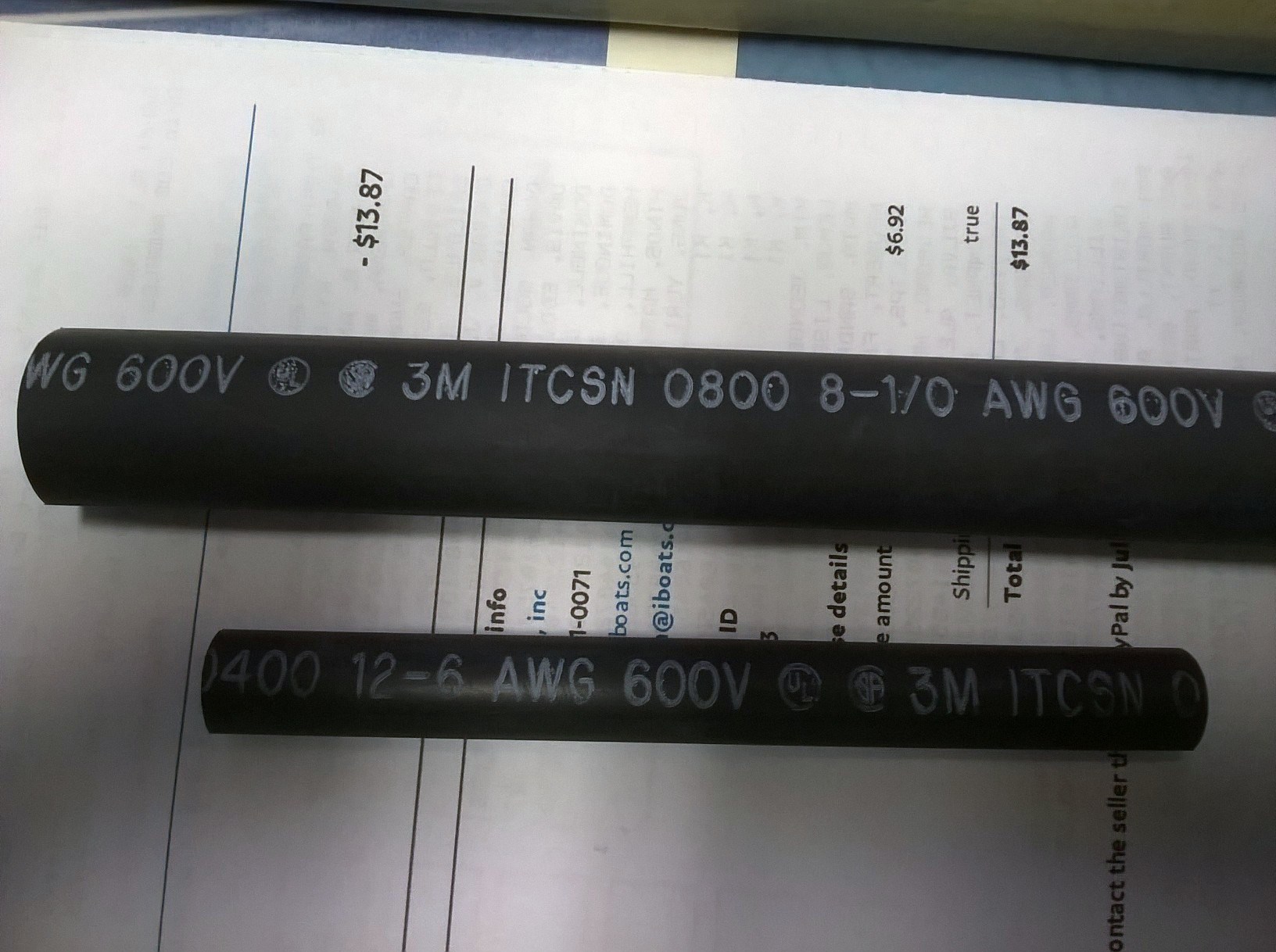

3M makes some of the very best heat shrink wrap available~at a price. This stuff is not only thick walled when shrunk it also has internal adhesive so absoltuely the connectors get sealed.WP_20170320_09_55_16_Pro.jpg
