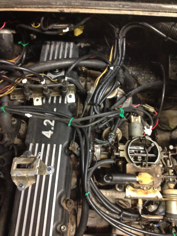

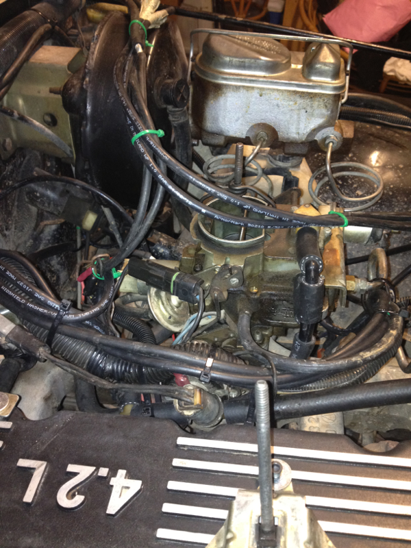

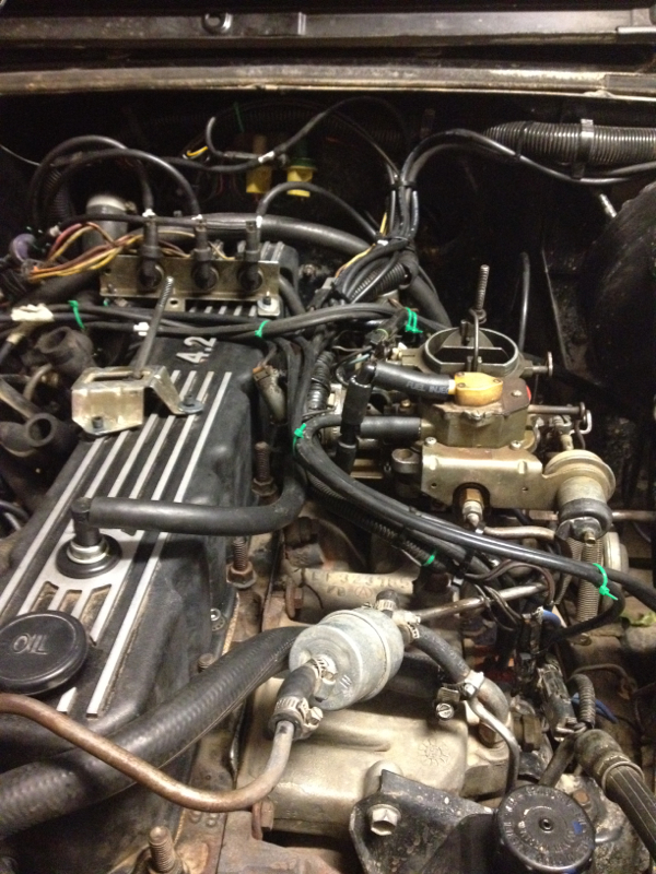

When you say stock, how stock? Do you have a upgraged carb, like a weber? Was a Nutter Bypass performed on it? Is there an air pump? Is the EGR valve still connected between the manifolds? Does it miss at idle or smell like rich exhaust? The late CJ's and early YJ's had really crappy emissions computers/modules that a lot of people disconnected. Can you take some photos of under the hood and the exhaust system?.....We got to start somewhere dude :???:.

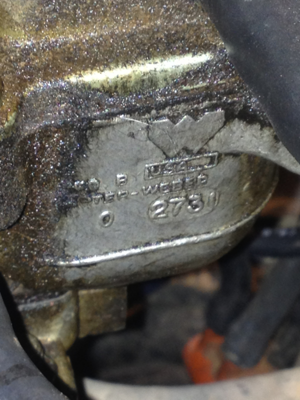

It has a weber carb 273, are the weber carbs not the ones that came stock? dose not smell rich, sorry I'm new to jeeps and still trying to sort threw this thing

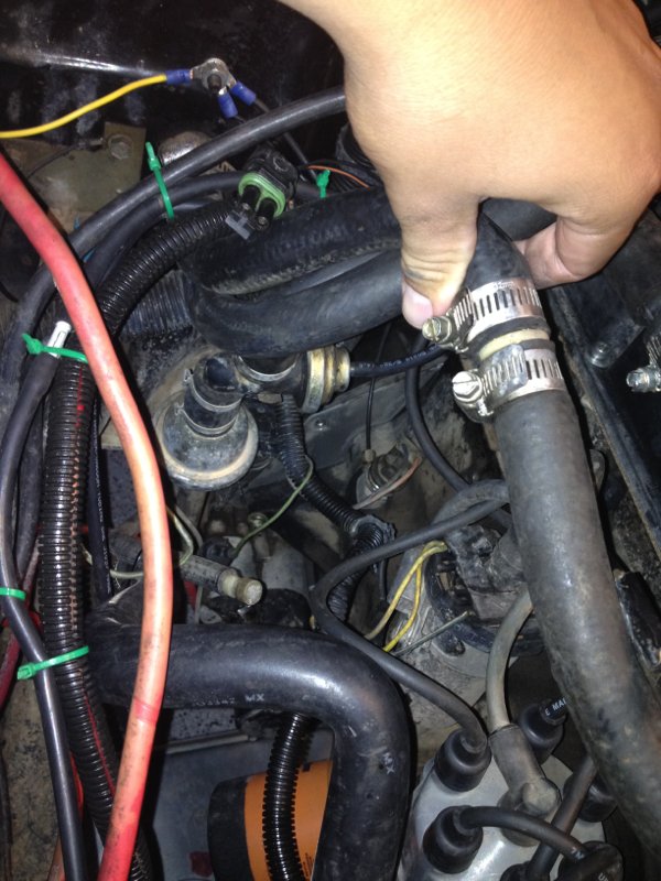

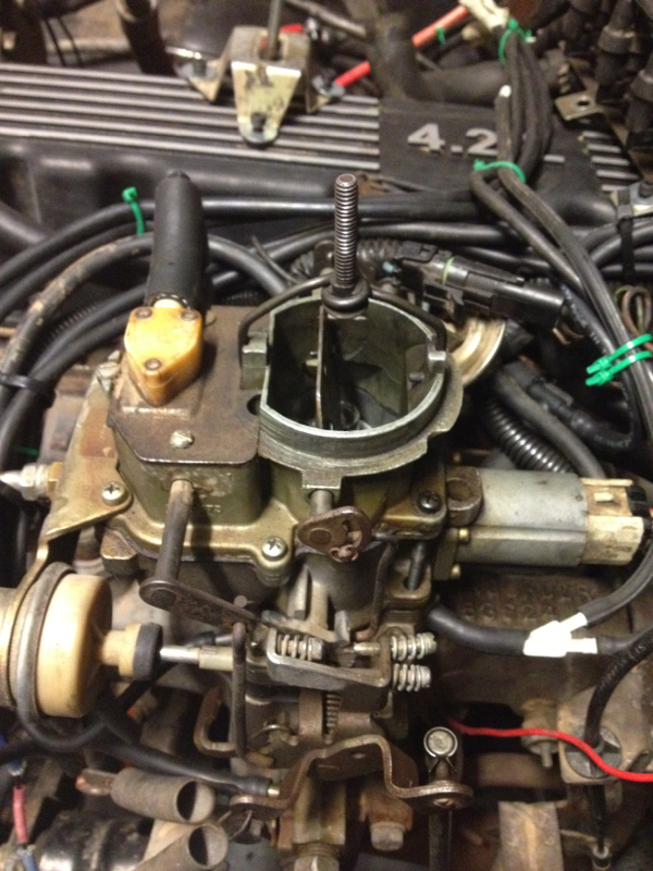

That's not a weber Bro.... I believe it is a Carter? Sorry, I'm viewing it with my iPhone so it's hard to see. I'll take a closer look tomorrow at work. Regardless, how does it idle? Ruff and fast? Two things to check from the get go: does it have a catalytic converter on the exhaust system and start looking for cracked or loose vacuum lines. I have a schematic of the vacuum lines, I'll look for it and send it to you.
it is for sure a carter.

Has the converter, idles fast when first started then after a while down to 10000 seams smooth kinda sputters a little. Drives good, at the stops it idles good doesn't try to stall at all. I just finished running all the vacuum lines over the past few days
Here is a closer pic of the carb

I did not know weber did some custom work AMC/Jeep....Learn something new everyday :idea:. Maybe superJ and I are on the same page (I think). You could swap a couple of things to improve emissions, but it's time consuming and can get costly. I also am not sure how close you'll get to your states requirement. My 85 has a Weber 32/36, High-output Electronic Ingition (HEI), a cataylic converter and a Nutter bypass across the stock emissions computer. I had no problem passing Maryland Emissions, only to find out I did not need it- Historic Tag route.

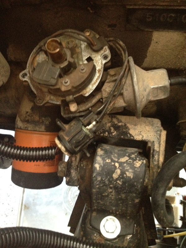

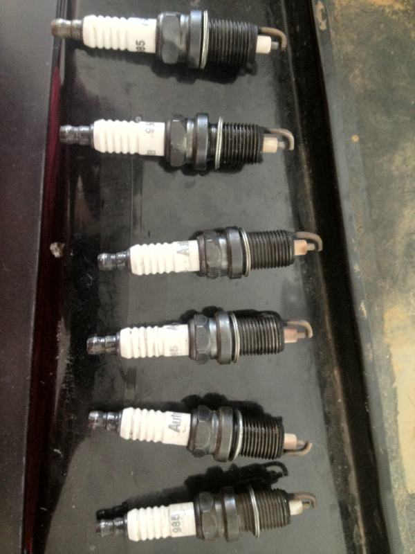

I good place to start would be pull the spark plugs. They tell a good story about engine performance.

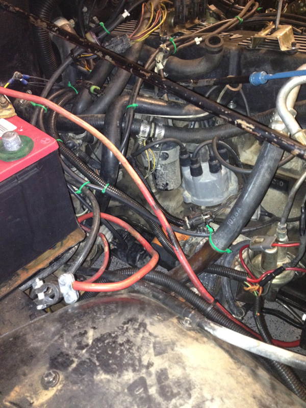

Also noticed the plastic around the wires here are exposed
