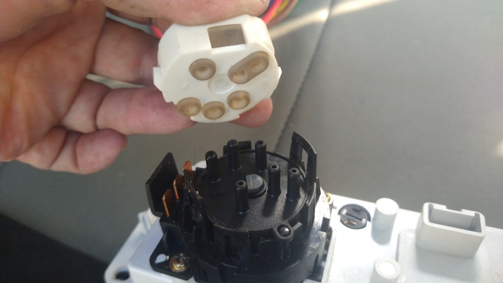

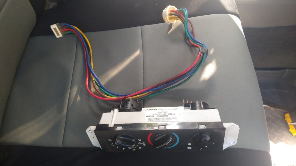

Here are the old controls and how the tubes connect.

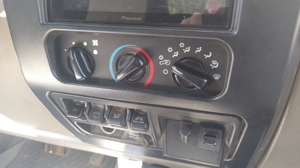

New controls look just like factory.
