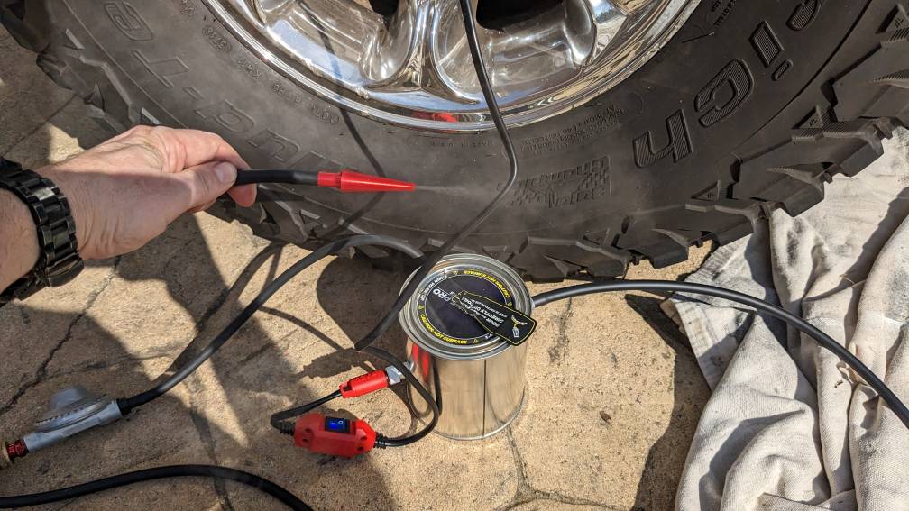

I finally decided to get serious and purchased a smoke tester off Amazon.
AutoLine Pro Automotive Smoke Machine Leak Detector EVAP Vacuum Diagnostics Tester | Economy Series

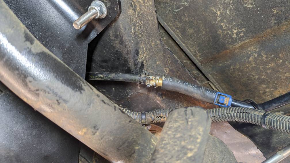

This thing is awesome! You pour in some magic smoke juice, and hook it to your car battery and out comes the smoke. I plugged it into an evap line and within a minute I had isolated the problem. The leak ended up being in my cheap fix to broken evap gas tank lines.
I wish I'd bought this tool years ago. A smoke test is not something you need to go to a shop for - it only ran me $75, and I own the tool now.
It's hard to get a picture of smoke, but you can see a whiff of it here
