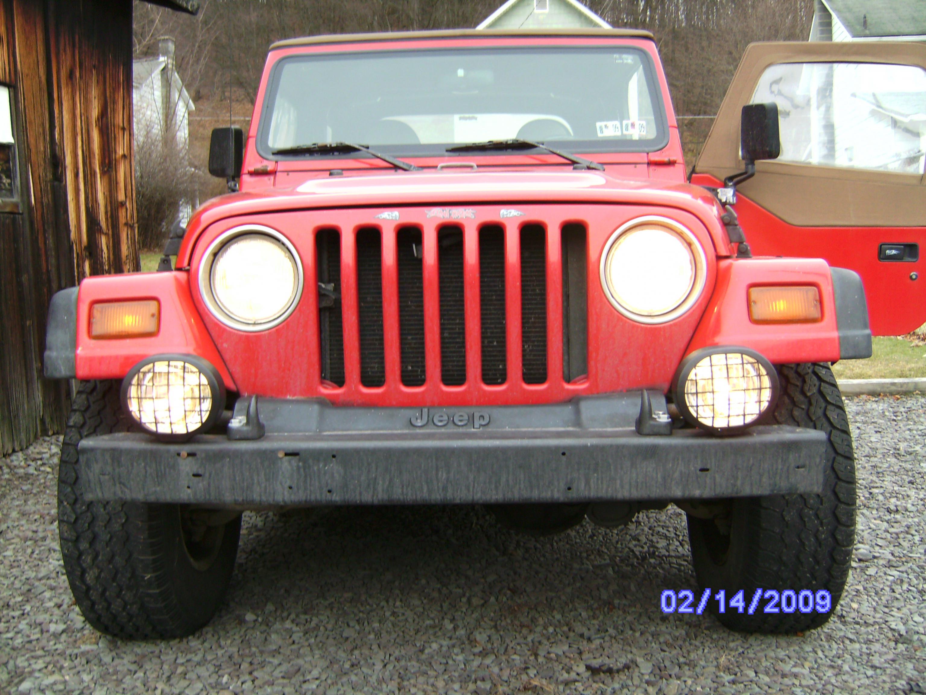

X2 HiHood. I had a blank beside the defrost, popped it out, drilled it and threw in a toggle switch. Hella FFs way outshine factory junk as do KCs.
I would yank them puppies and give them a hardy toss and get some good lights (100watt plus) with a switch and independant hot lead. :twisted:
Done cost about $20 from harbor freight.
