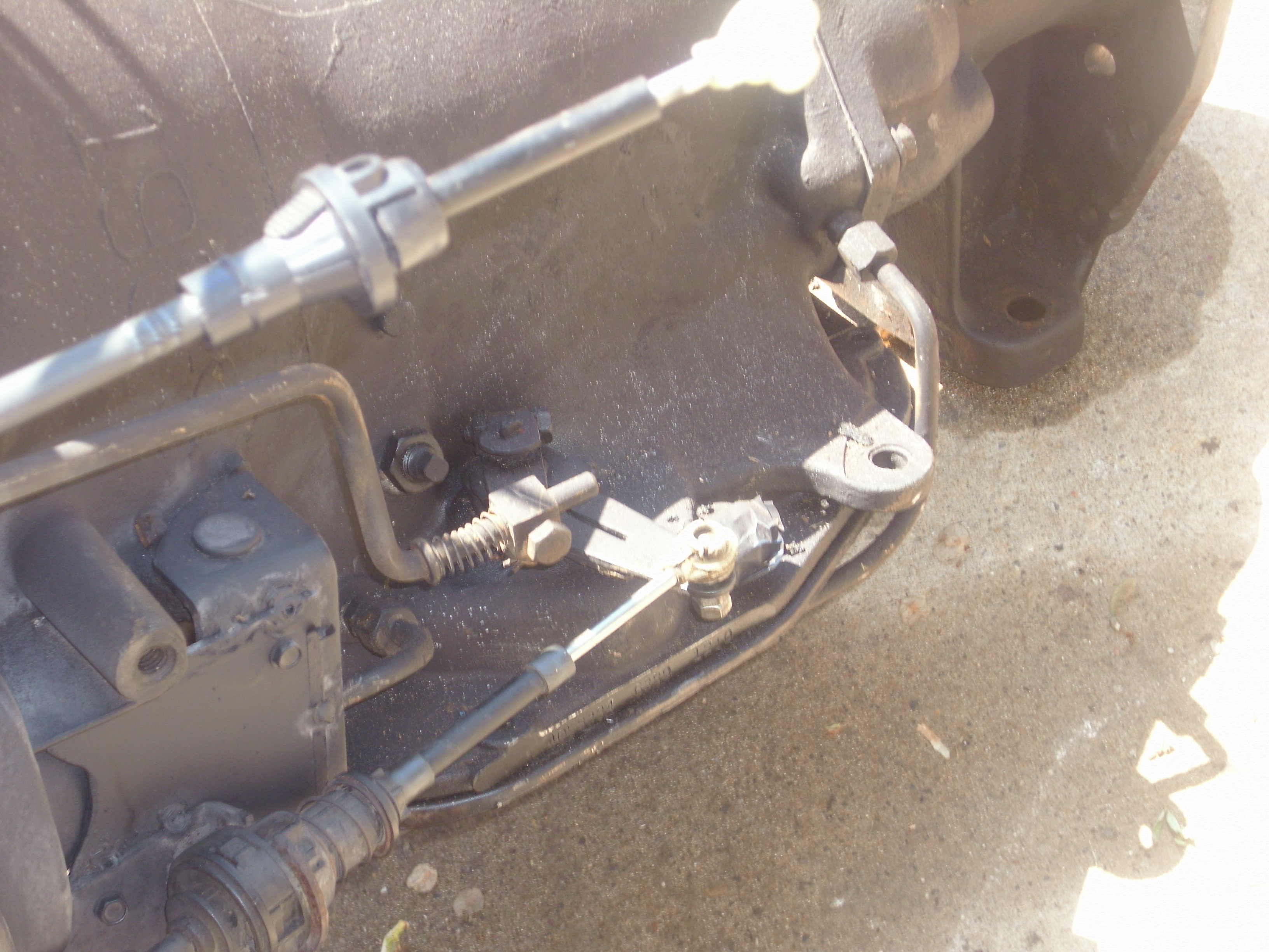

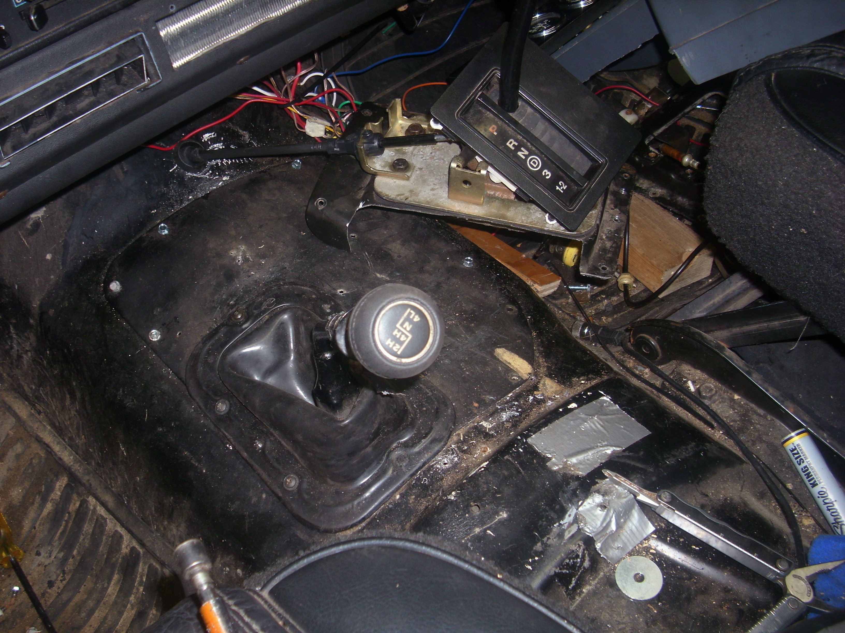

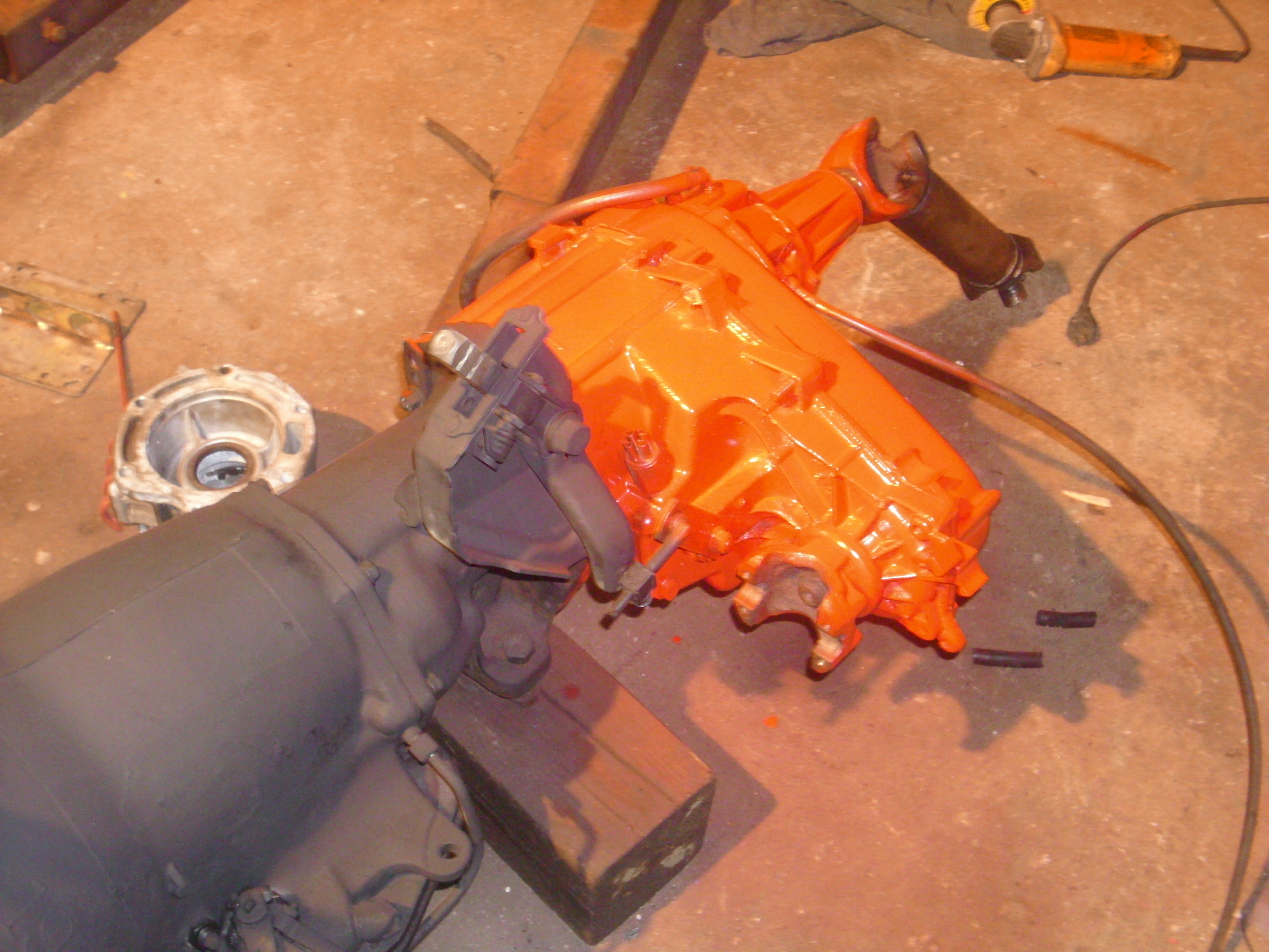

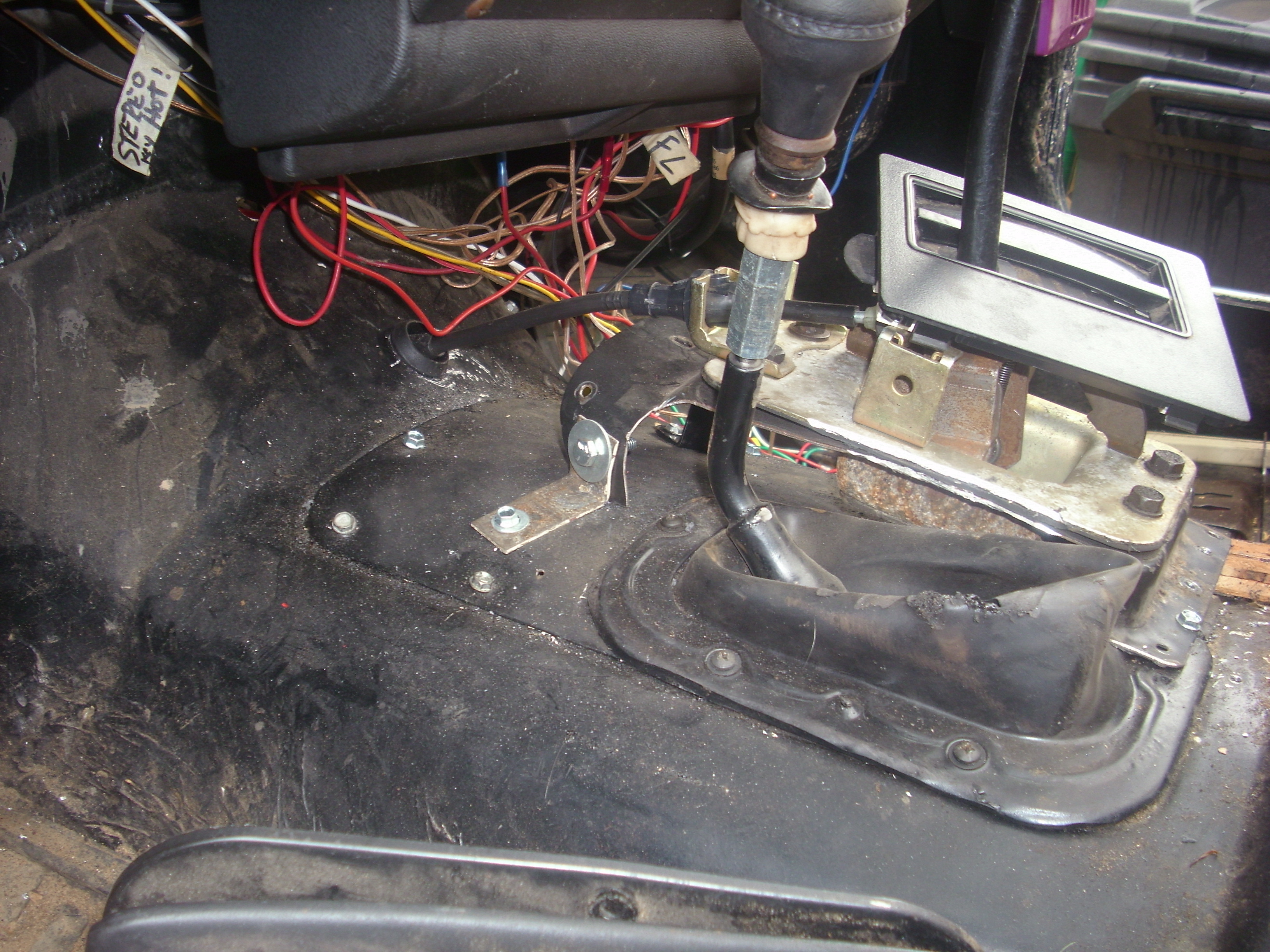

3/4 of the way through the Frankenstein project. a Dodge 360 of the 1979 era sits nicely between the frame rails pushing a tf 727 and coupled to a np207 thanks to some re-drilling of the adapter. I set the motor low in the frame in anticipation of the SOA (next project 8) ) I scarfed the shifter , cable and console from a 91 cherokee to eliminate the linkage hassle , keeping the yj t-case shifter and bracketing with a little tweaking of the bracket due to the thickness of the dodge 727 adapter compared to the jeep 904. I brought the motorcraft 2150 over to the 360 from the old 258 motor, and tweaked the kickdown linkage untill the shifts were smooth and regular. the project was tight on money so i kept the stock manifolds and had the local shop bend some pipe back to the skid plate. THANKs Justin at CJJs Auto in Mauston Wi !!!!!!!!8)8)

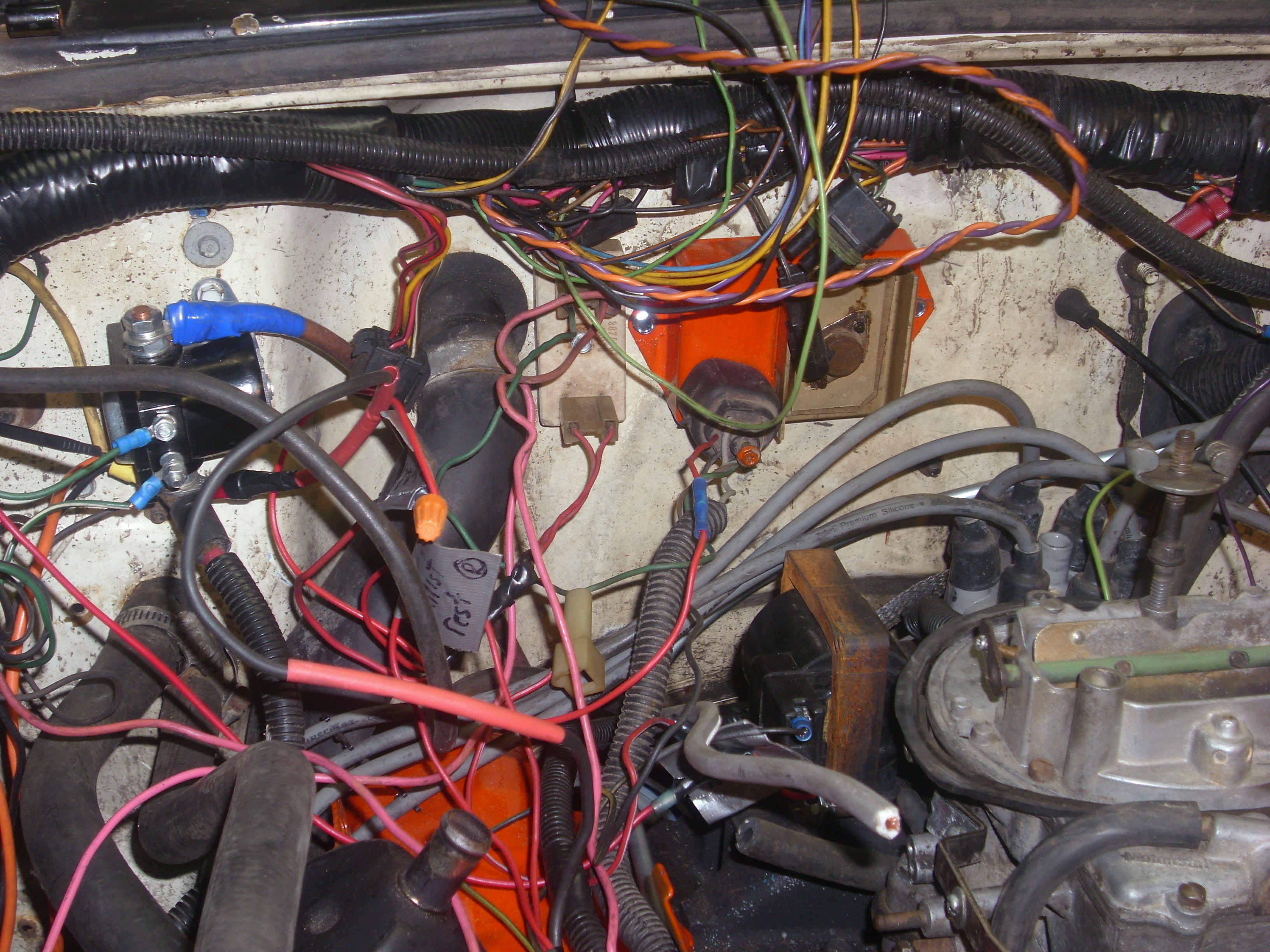

I have to say that the boys at Allpar.com were the greatest as i had no mopar experience what so ever. I cut out the jeep ignition and grafted the mopar orange box and external reg to the jeep. I mounted the solnoid and ignition parts all high on the firewall leaving only the starter below to see water !. seems to be runing a bit rich yet. heres some of the "along the way" pics........
