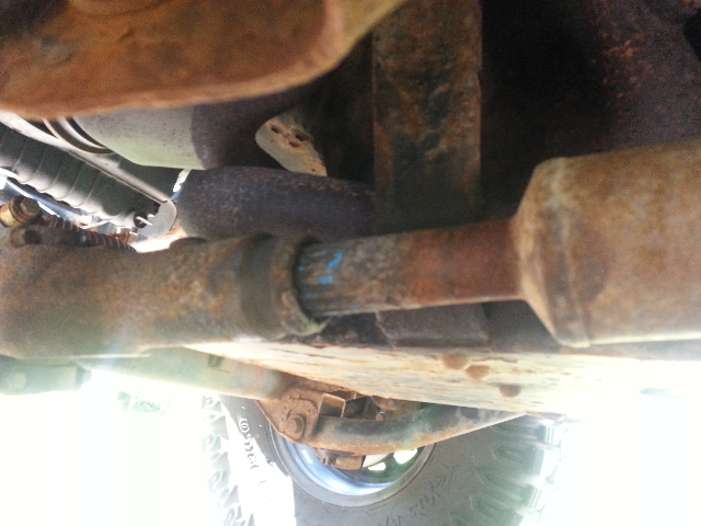

Hey everyone!! Been a while since I was here...sorry. But I need some help. I've been running my Jeep the same way for almost 5 years and now, this spring I break it out of storage only to find a horrible bird/screeching sound from my front drive shaft. It looks like my slip yolk is coming out??!! What would cause this after no problems for so long??

Can you post a pic of how your slipyoke is coming apart? Is it in the middle of the driveshaft or attached to one end?

That appears normal, although it could use some grease. The horrible screaching is likely the CV joint (double-cardan joint) at the upper end of your front driveshaft. It has a centering ball between the two ujoints that goes dry. You can try greasing it with a needle fitting on a grease gun.
The centering ball is serviceable and available at most parts stores. Wouldn't be a bad idea to take the front driveshaft out until you can have it serviced by a driveshaft shop.
Left unchecked the joint will explode and take out your transfer case with it. Get it fixed asap.
It appears the grease seal is missing from the slip yoke. Might not be a bad idea like bounty_hunter said to have the shaft serviced . The internal splines are sure to dirty and probably corroded. Sure hope the splines are ok :???: there is supposed to be a zerk on the slip yoke.

Ok brought the Jeep into the garage today...I couldnt get the diff off myself. Both my guys are kinda in shock as to whymy slip yoke is the way it is. Its at the shop so Ill fi d out wtf is going on probably tomorrow. Keeping fingers crossed.
Ok well here is the verdict....I need a whole new drive shaft....im gonna get more details when I bring the Jeep in. But now my problem...do I go with a Tom Wood or a Spicer?? Same price.
