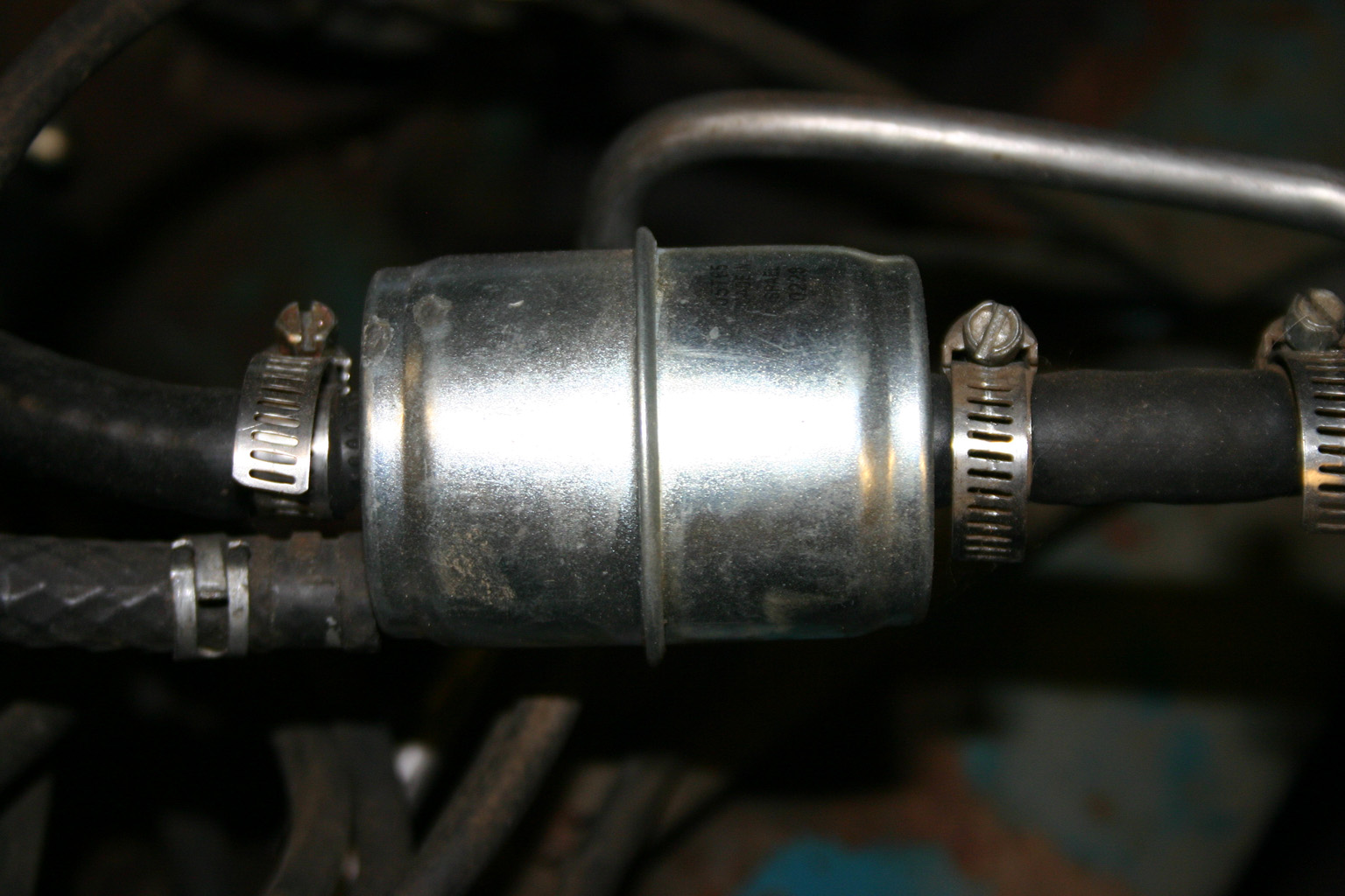

Sounds to me like your problem primarily stems from not having a fuel return line as it is designed to eliminate fuel vapor issues. The picture is what you should have for a filter and only one filter is necessary, not two as you currently have. The supply line is coming into the filter on the right side of this picture. Note the two out flows. The top one goes to the return line. The return line connects to the extra nipple in the sending unit on the top of the gas tank. The lower outflow line on the filler goes to the carb. It is not uncommon to hear of guys removing the return line during a mod but in the end the line always needs to be restored in order for the engine to run properly.

Thanks for the explanation and pic. I will stop by the auto parts store and see if I can acquire one of the proper filters. My jeep still does not have a charcoal canister nor does it have the liquid fuel vent canister. Any idea where I can find these. I have gone as far as calling my local jeep dealer and was told they are unaware of what I am talking about?

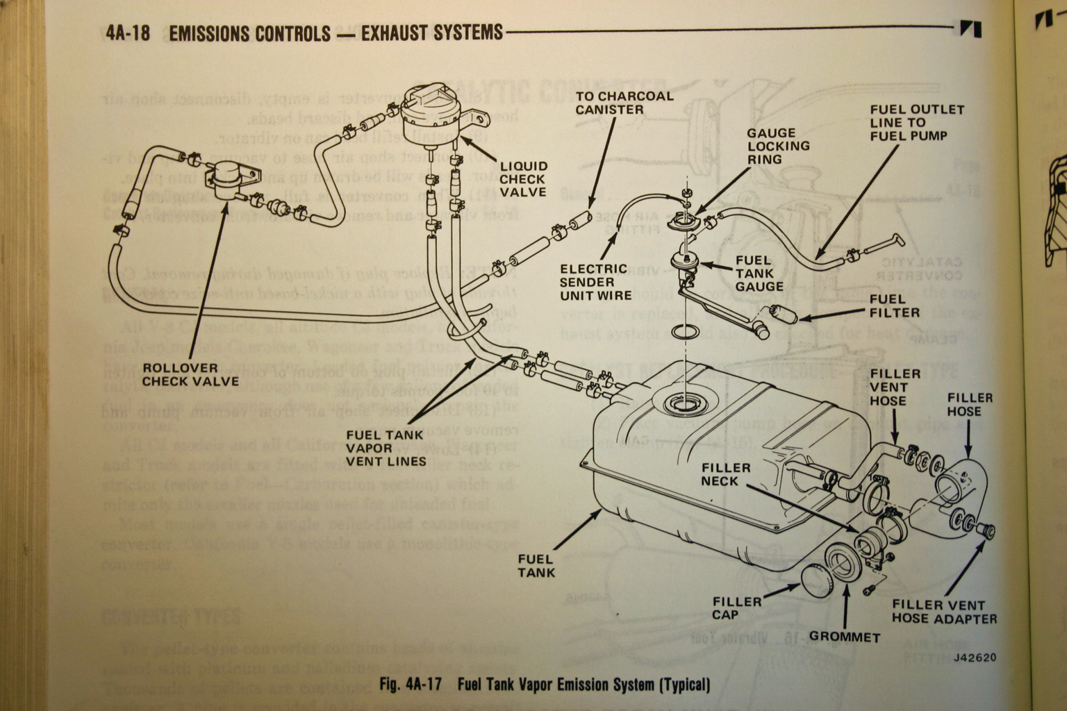

Here is a picture of the emissions Controls on the CJ fuel tank. My scanner is down so I had to just shoot a picture of it. Also, I crawled under my 1978 CJ5 to verify what I had going on. Mine is set up as described below.
The two valves behind the drivers’ side tail light are the two valves we have been talking about, the Liquid Check Valve and the Rollover Check Valve. In the picture you see two hoses coming out of the tank and going into the bottom of the first and larger valve; this is the liquid check valve that prevents liquid gas from entering the system. From there one hose leaves the Liquid Check Valve and goes to the other smaller valve; this is the Rollover Valve. 82CJ7JEEP is incorrect when he called the first valve the Liquid Fuel Vent Canister. No such animal is mentioned in my 1977 OEM Tech Service Manual unless things changed for 1982 but it is easy to see why many different names for these pieces are floating around.
From the Rollover Check Valve a hose then goes to the Fuel Vapor Storage Canister aka the Charcoal Canister in the engine bay. The book calls it by both names.
I agree with 82CJ7JEEP in that if you have a new fuel pump and still are not getting any gas to the carb you must not be getting fuel out of the tank. Likely culprits are:

i bypassed the rollover check valve.. and still no fuel.. wondering if I should bypass the liquid check valve too.. but the last pic posted is the same one I show in my manual.
