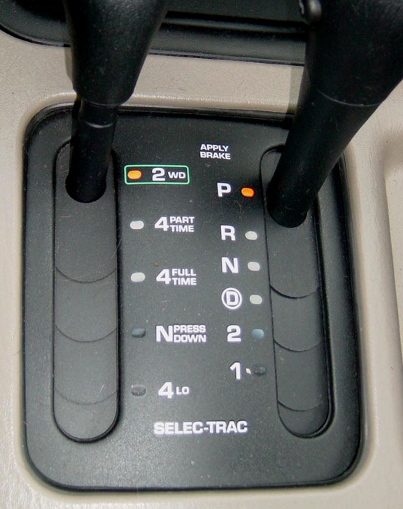

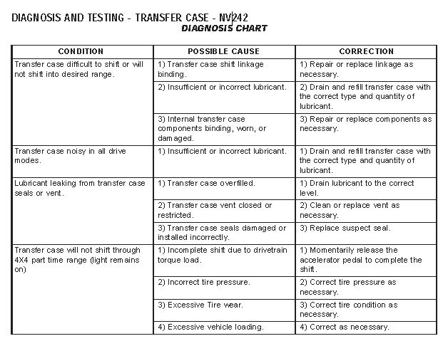

trying to help if this Is slect trac NV242 confirm..... use wd40 when checkg cable and linkage movement
