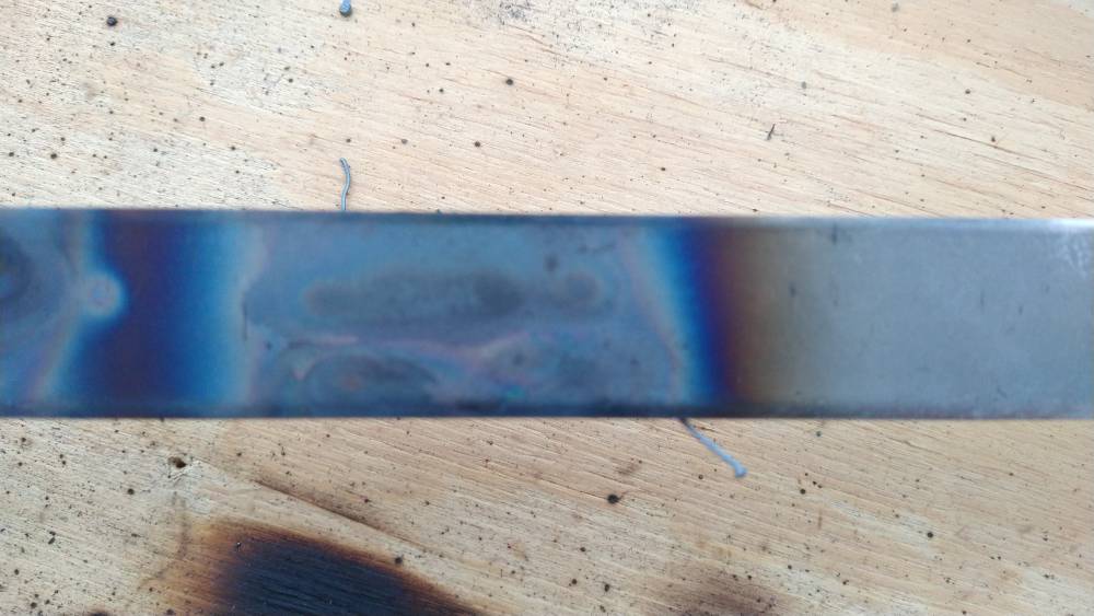

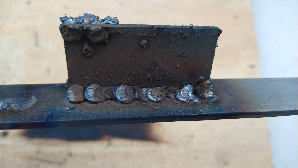

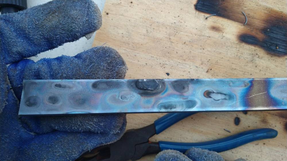

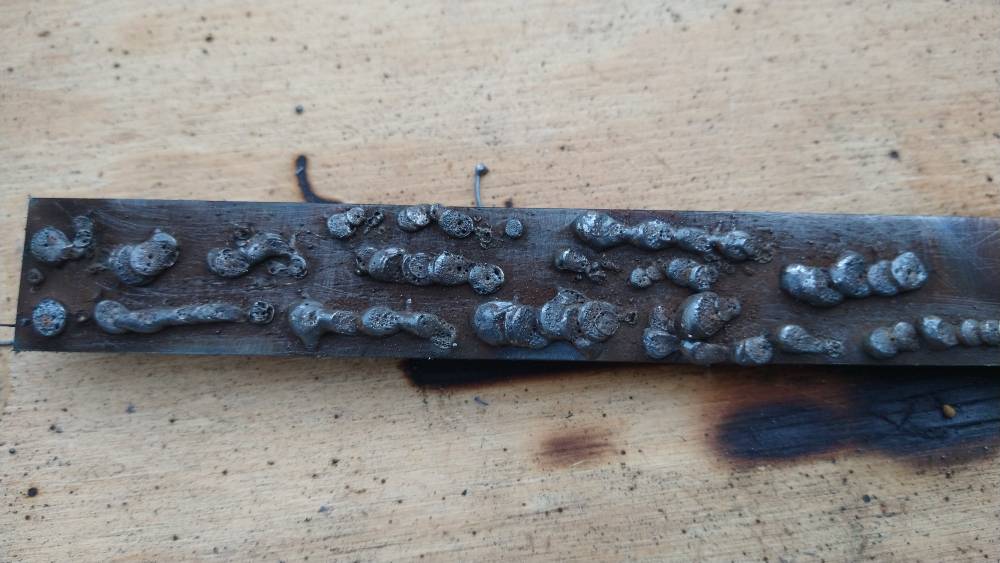

Welded for the very first time today on some 1/8 inch metal. Just putting down some practice welds. I think I need to turn the voltage up some but I know for sure I need more practice.
Sent from my moto g stylus using Jeepz.com mobile app
And maybe try the speed down too. But power up, for sure. You need to get the puddle hot and lead it slowly back and forth so you get a smooth seam at the edges. Some people lead by pulling the wire and some people lead by pushing, you just have to decide which one works best for you. Also, wire brushing the metal first to get rid of impurities or surface rust will help it go down smoother. In case your metal was a little dirty
