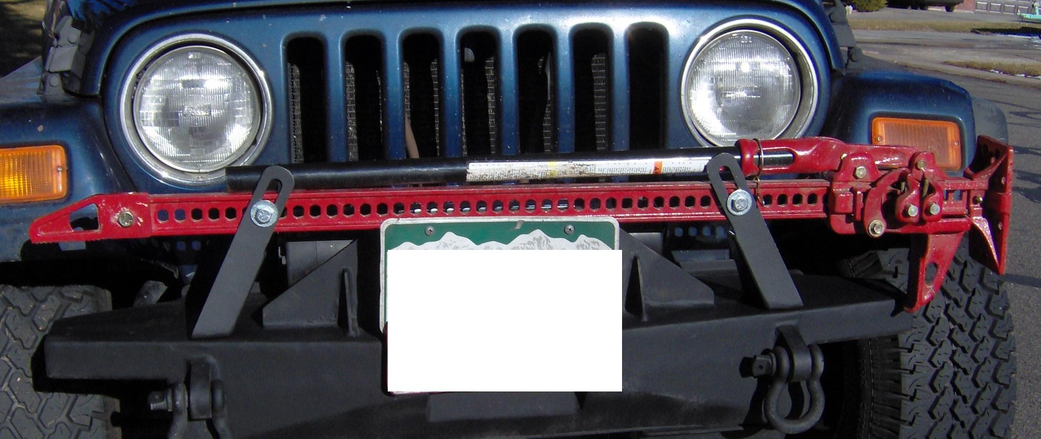

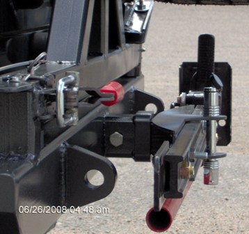

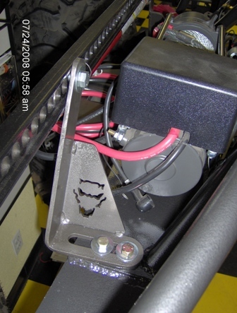

Check out ROC DOG Fabrication (rocdogfab.com) They have a couple of nice hi lift mounts. One is a receiver hitch mount. Whole thing comes out if you don't want to carry it everyday. Slips into a 2" receiver for your trip.
The other version are mounts for your front bumper. Clears the winch (if you have one).

I would not recommend mounting to the front of the front bumper or back of the back bumper, that is if you wheel your Jeep. I had a buddy that had one mounted to his front bumper when we first met him, told him that was a bad idea, he said it was fine, we laughed our a$$es off watching him try to pull it out where it was wedged between his bumper, a rock and front tire. It kills your approach and departure angle and when half of it gets ripped off it can be a p.i.t.a..
Here's a better picture of it on the TJ. We have been running the jack this way for awhile now and haven't had any problems on the trail. We run Colorado and Utah trails frequently. As for the rear receiver mount Hi Lift, clearance is great - in fact the Hi Lift mount doesn't stick out as far as the tire does! If you imagine a line from the back of the tire to the bottom of the Jeep, the jack remained within that profile. In fact, we found the tire hit obstacles - not the jack (the reciever mount is on our YJ and the front mount is on our TJ)

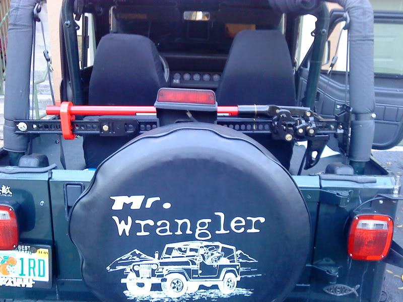

It's best to mount the hilift inside the jeep if you want it to stay clean enough to work when you need it the most. Best place I've found is between the two rollbar uprights behind the rear seat and over the trunk area. I used muffler clamps but it's a cleaner install to use fencepost clamps like the below pic. Then use wingnuts to hold the hilift to the bolts.
Would the hard top still fit fine if I had the jack on the rear roll bar like that? If it did, would it also fit out the back window?
Yes, the shorter of the two hilifts will fit with both the soft and hard tops. Pretty sure you can get it out the back window if you hold the jack diagonally in the opening.

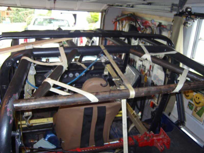

I would avoid mounting it outside the vehicle, it will rust up pretty bad depending on where you live. I simply rest mine across the back, wheel well to wheel well and use some HD bungi cords and secure it down to the farthest foward rear seat mounts. I used to have it on the roll bars like Bounty showed, but in a couple cases where I need it where I needed it quickly, they way seamed too timely to retrieve it out.
Edit, here is the best pic I could find. you can sort of see the bungi cords holding it down. I've rolled the jeep and it has never budged
