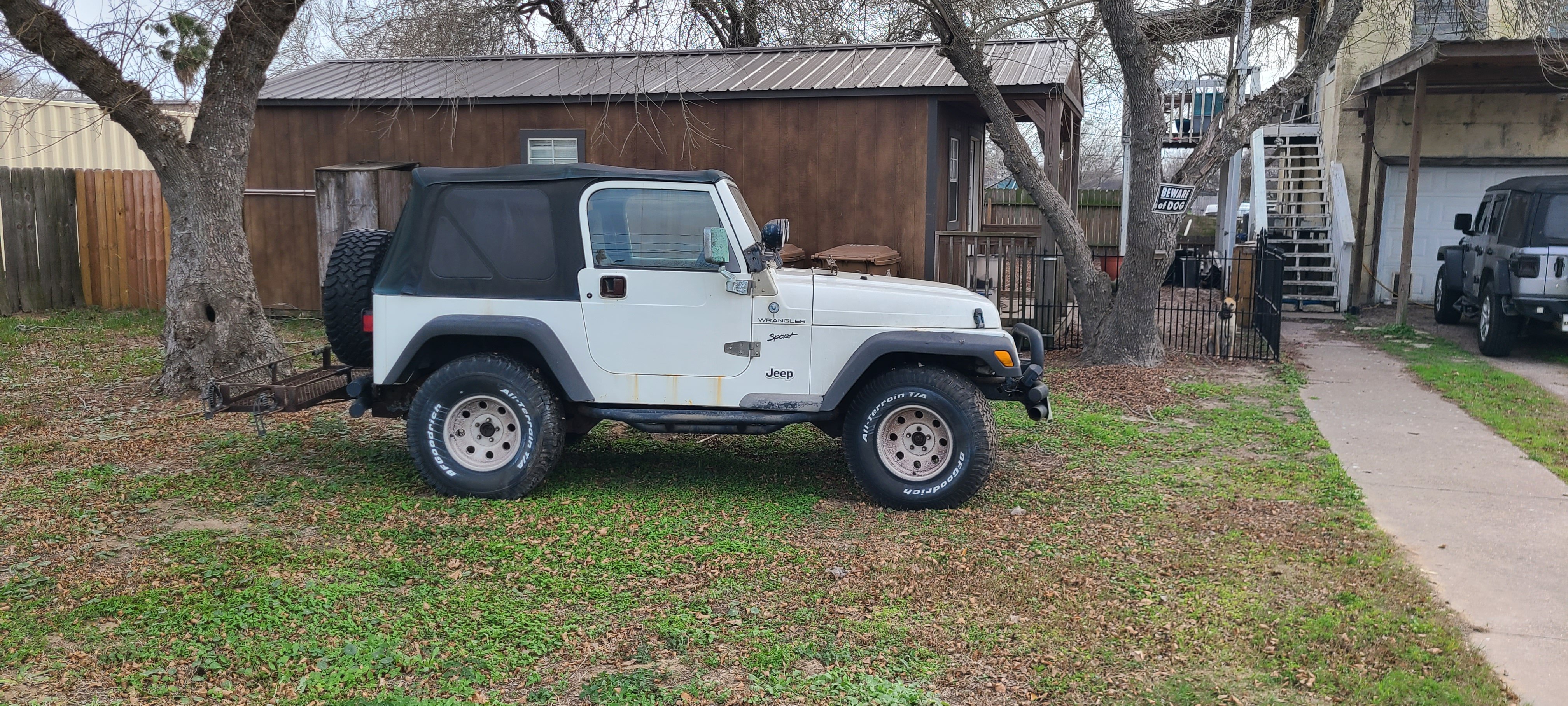

we picked up an 02 sport yesterday afternoon. it has been sitting since 2019 since the guy had a heart attack and then the crank sensor went out. he said he cannot work on anything anymore so it just sat. it was his beach jeep so the underside is pretty rusty but the engine and trans are solid, he says. he said the whole jeep actually is great, once the sensor is replaced. its got a lot of add on junk that my son likes so even if the frame is worse then we think, the mounts and steps, cruise control, and a good transmission are worth the 1k we paid for it. its also got 15x10 inch nice looking aluminum wheels. unfortunately, since it sat, the tires that he had just put on are no good anymore, i think.
anyways, 1k for what could possibly be a decent beach jeep with kc lights on the windshield, front and rear bumpers, instatrunk, rims, super clean interior, and 4.0 with automatic should be ok even if we have to drain the tank and replace the fuel pump along with the crank sensor.

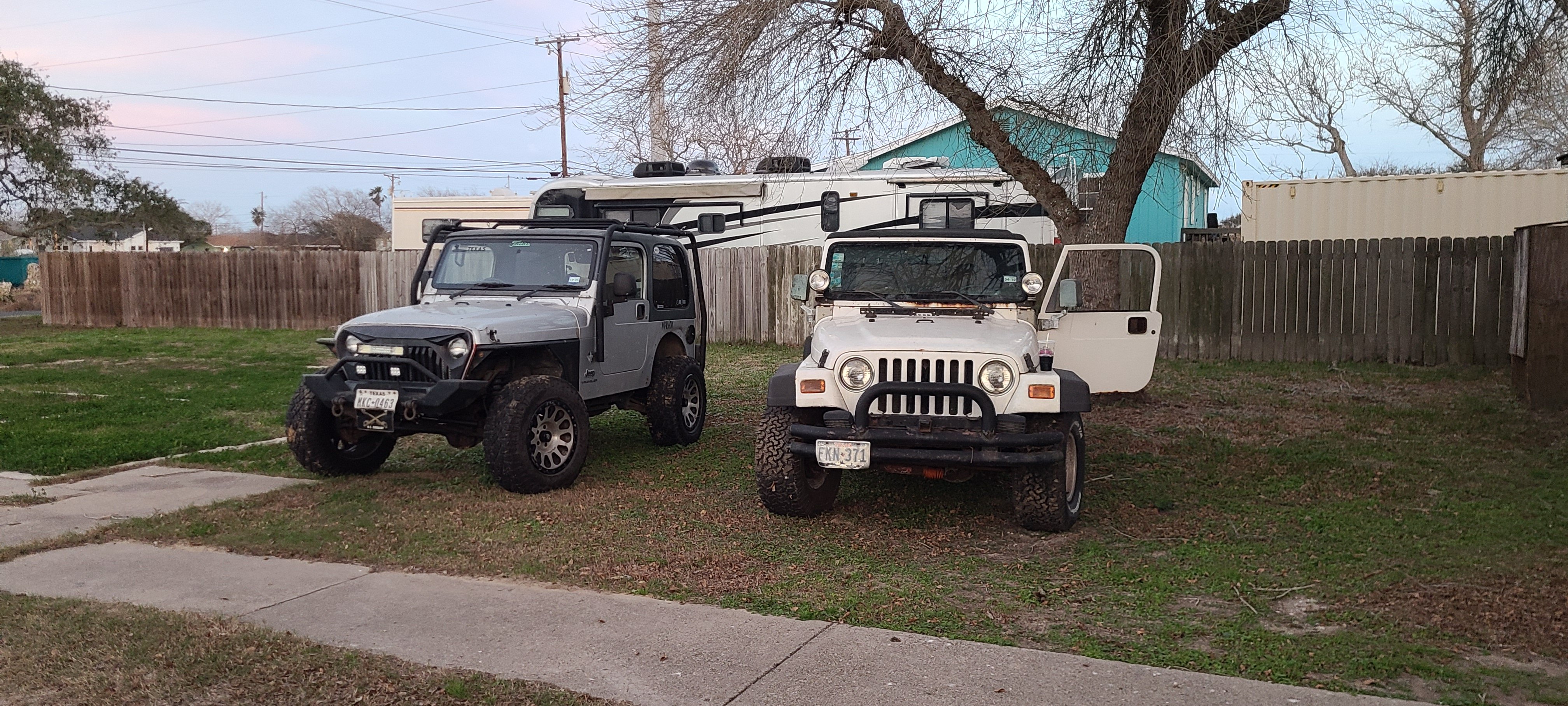

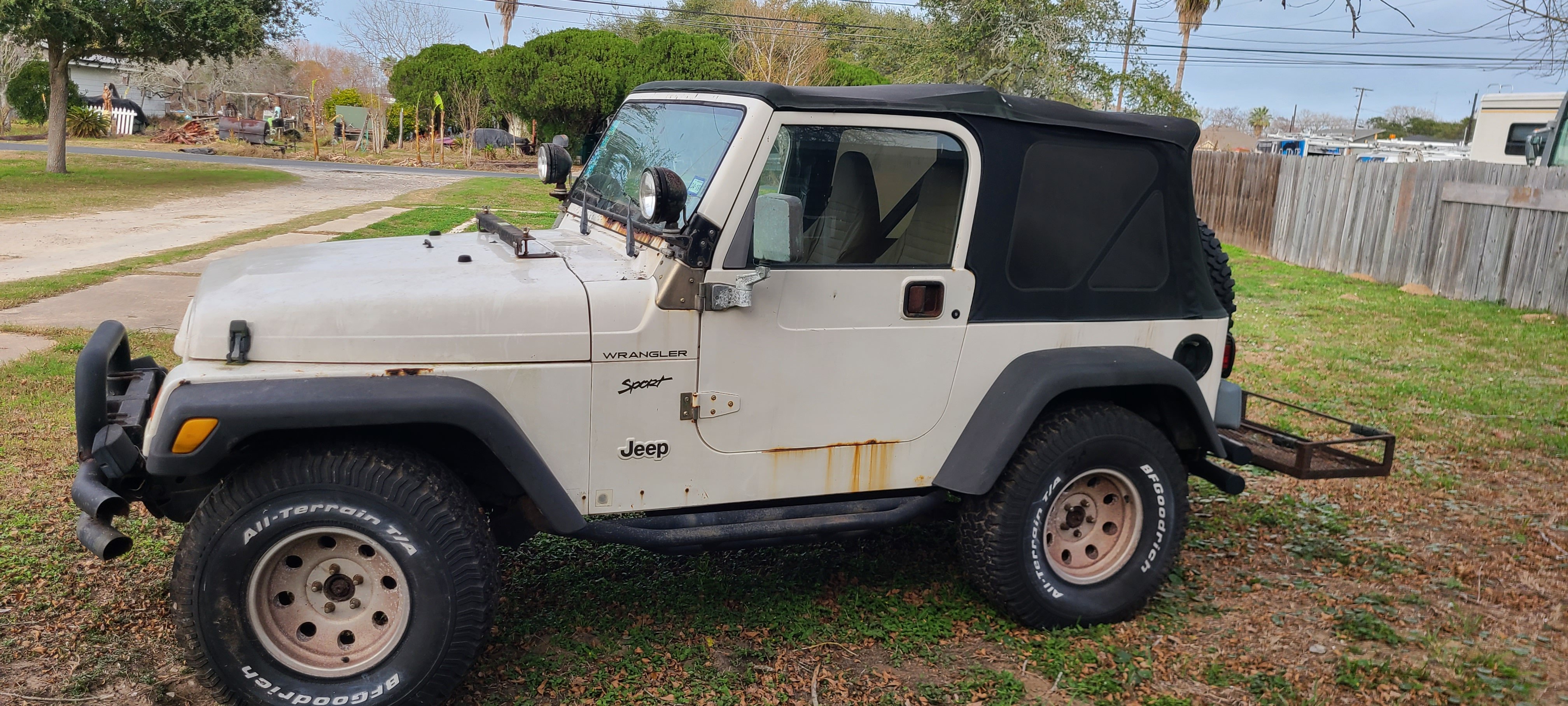

Finally put the pictures up
Rough. No holes but everything is rusty
Well, further cleaning and messing around ahows some small holes under the carpet by the foot areas. And the jeeo starts on fuel being sprayed in and tb and idles great but i think the fuel pump is frozen. And the underside is so rusty that i dont know if we woll be able to drop the tank.
We will dind out one of these days
