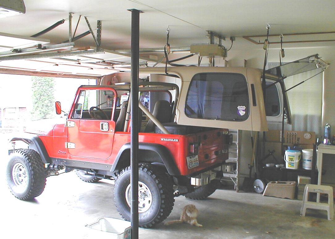

I made my own hoist for cheap. I used eye-bolts through the celing joist. Used locking ratcheting straps. I just have to raise the hard top about 2 inches and drive the Jeep out.

I have a hoist-a-top set up. I bought the manual version.
The bracket that holds the top itself is made of multiple pieces (obviously just to make it less costly to ship). It works fine, but a welded piece would be nice.
After figthing with the come-a-long syle ratchet for a year, I bought an 880 pound Hoist from Harbor freight for about $79. I love the electric hoist option. by myself, I can install/remove my hard top in half the time it takes me to do the soft top. I almost never use my soft top now.
My top hangs about 3/4 of the year. I have been doing this since 2004 with notop distortion af any type.
