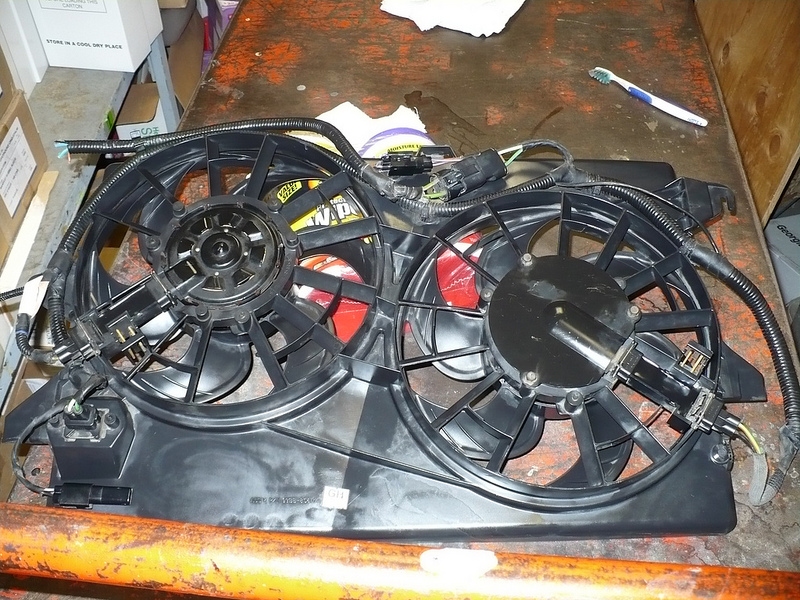

Well after last summer and this one having the heat rear up and show it's hand this summer, I've decided to swap out the fan to a Merc Mystique double fan & shroud, found one for $40 at the boneyard.
I've been reading some great details about this setup and I'm hoping it'll give me greater cooling capability on hot days.
Just got some wiring to figure out.
